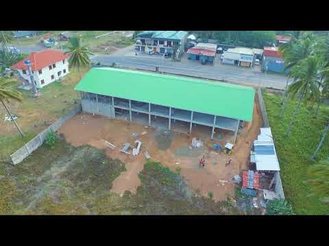

              Actual drone shots of the building - before oven started
              • #8
                Oven will go here and roof vent will be shorter as I located it to the outside of the building.

                  You may need to back it away some distance from the building. A guideline for flue height is 2' above any structure within 10'. Local building codes may also apply.
                  • #10
                    Thanks - I might be like 9 feet away currently from the center. Might have to turn my oven to get the additional distance.
                    • #11
                      You really need to talk with your local building authorities to get what chimney clearances are required for your locale (Phillipines), it may be more or less rigid than the US.
