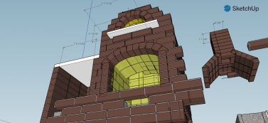

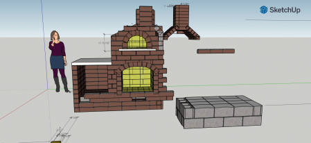

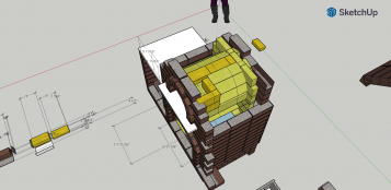

    Has any one tried an optimized air flow for their build?
    Where the air flow for the fire box and chimney, instead of normally just in the center, it is one opposite corner?
    I aim for the draft hot air will circulate in the oven dome clockwise like a mini tornado.
    I hope to have some input or some kind of flow simulator before I commit to building this.
    I could always just play it safe and build standard center chimney and firebox opening
    Any input would help.

    What you are proposing is an updraft system. In this case the flame will jump straight for the flue where it enters the oven chamber. The preferred configuration is a hemisphere chamber which eliminates cool corners and promotes better circulation when combined with a cross draft system, where the flame is pulled down slightly before exiting out the flue. Many kids actually have their flue exits at the base of the chamber for even greater efficiency, high temperature, circulation and even chamber temperatures.
    The fireplace with oven on top is an idea that has been proposed a number of times, but is fraught with problems.
    Departing from tried and true plans might work, but can lead to a lot of wasted time and materials if it doesn't work well. Try downloading the free plans for a Pompeii style oven.
