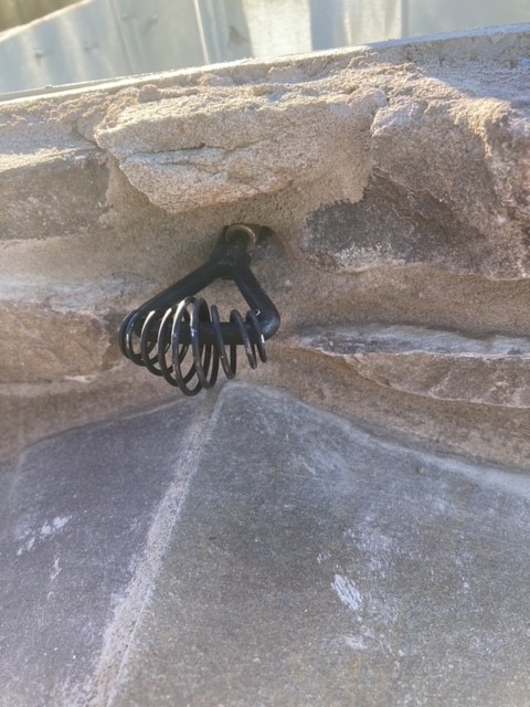

      I fitted a damper and I use it both when I first fire up the oven and as soon as the last item is removed at the end of the evening. It certainly helps with heat retention.

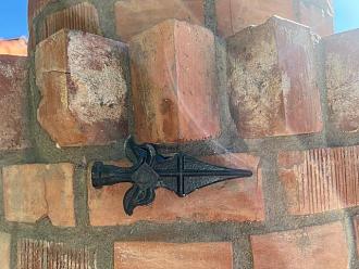

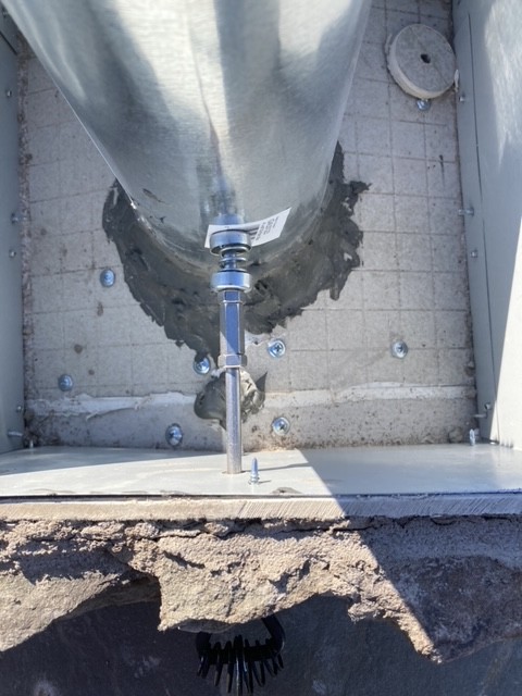

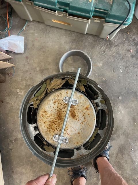

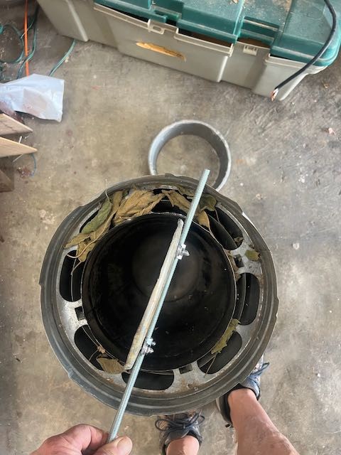

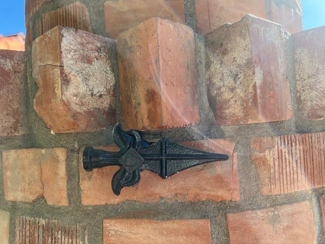

          I used a Duravent 8" flue I got from Offerup. Then I cut the bottom out of a stainless steel dog bowl that was just the right size. U-bolts and an all-thread rod ran through the sides of the Duravent to the outside of the chimney where I bolted on a cast iron arrow to indicate the direction of the damper.
          I agree that the heat retention is much greater with the damper.
