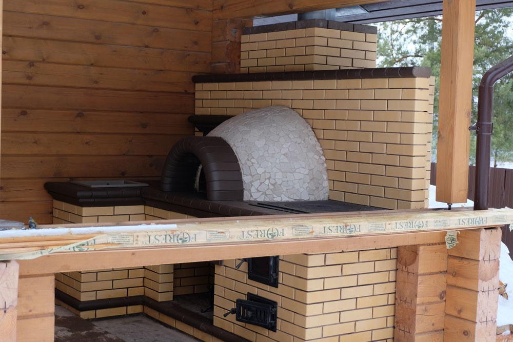

    Interested in the photo, how the smoke channels for the Pompeian stove are arranged. Any help would be greatly appreciated, thanks!

        Difficulties in translation, I'm not interested in smoke ... In the photo there is a Pompeian stove, I would like to know how the smoke passes. Maybe the forum already has this, when the pipe is behind, as in the photo from the first post.
          OK. I think that understand the question. The chimney/flu is angled back and over the dome. It has been given a term called "squirrel tail" because of it's similarities to how a squirrel's tail lays back over and hugs it's back. Here is a recent thread with a couple of examples. Both of these were done with masonry flus. However it can be done with stainless steel piping and angled connections. Hopefully, others will post some examples

                Let's go back to the first post. The question remained, how to make a chimney at the back? I found the owner, he does not give information. It does not have a chimney along the dome. Maybe someone else has a solution?
                  Egor2021 are you wanting to build an oven in a place where you are going to have a roof and want to have the chimney vent out towards the rear of the oven? With the placement of the chimney in front of the pompeii design you can either build a design like Gulf linked to in post #5 above, or use metal pipe with an angle to direct the smoke to the back of the oven similar to the pictures in the link below. Let us know if this helps answer your question.
                  I plan to build pizza oven using FB great DIY PDF plan/tutorial. I have one little thing to solve beforehand. The place the oven will sit in is now under construction - I am building "pergola"-like structure with transparent roof (glass or polycarbonate) so now I am before some decisions: 1. Oven chimney cannot go
