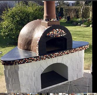

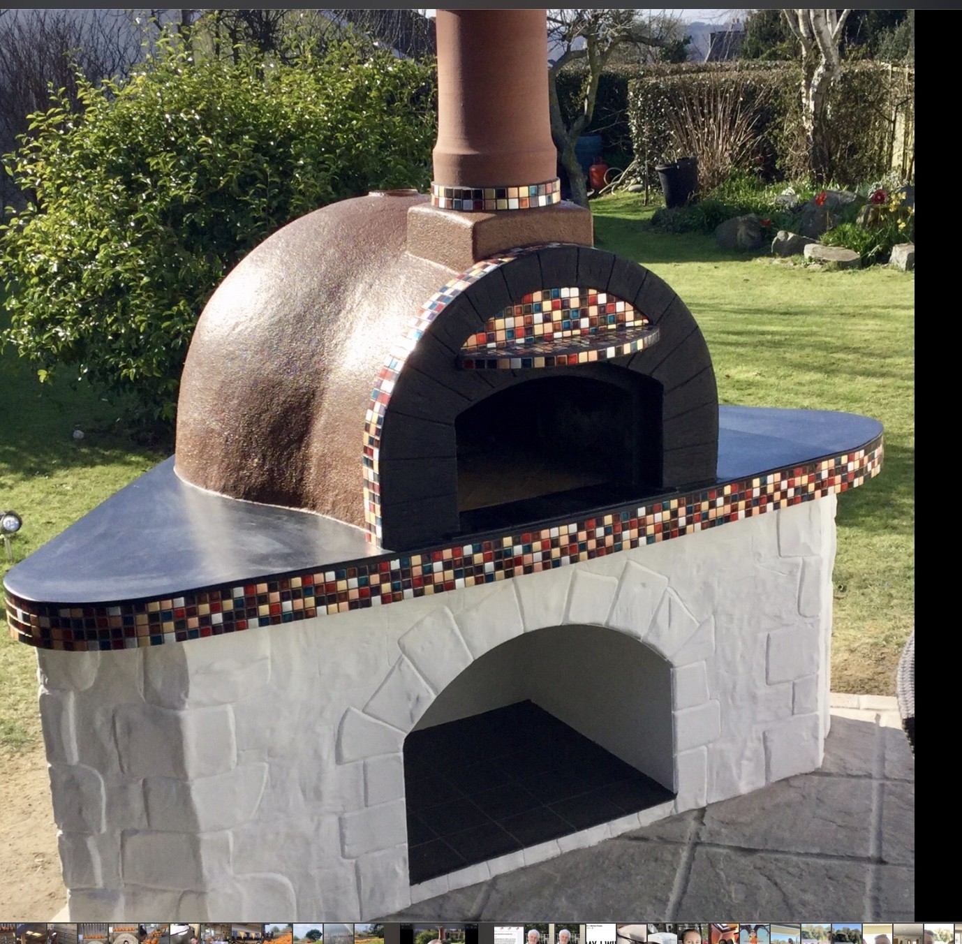

    Assuming you have used plenty of insulation and the outer dome does not get hot, then you could add a layer acrylic plaster or a fibre reinforced render or tiles or fiberglass.
    I have fiberglassed a couple of ovens that were is exposed positions, completely water proof, wont crack and long lasting.
