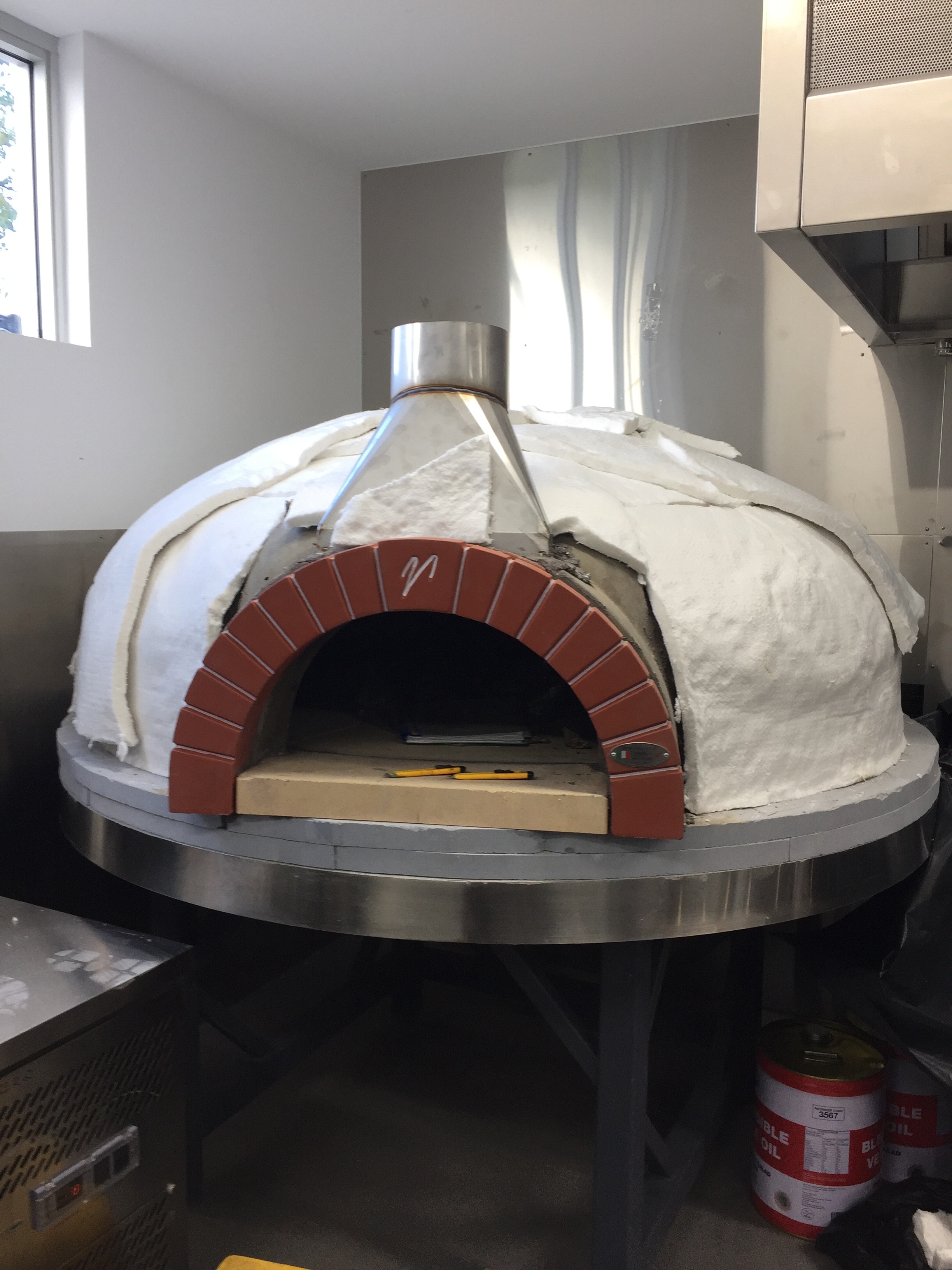

Hi all , we are restoring an old internal pizza oven on a listed building

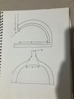

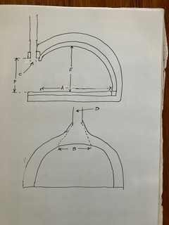

The pizza oven opening is around 900mm wide by 450mm tall. (arched)
The existing chimney stack has an internal measurement of 250x250mm and has been sealed over internally before roof level
We have been tasked with extending this chimney up and out through the roof so that the customers can use again.
The foundations have been checked and are ok , but we are wondering if the flue diameter will be too narrow for the pizza oven to work effectively
They would like to extend the existing stack however we have said rebuild from scratch at a wider diameter ,
Are there any experts that can calculate for us if we are right!
