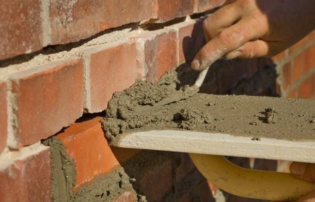

    I thought some of the more experienced brick builders may have offered some advice here, but as they haven't here's my two bobs worth. In many cracks in the outer arch that I've seen, it is caused by the inner oven parts expanding against the cooler outer decorative arch. With no expansion joint between them the outer arch is taking a lot of stress. Even if you repair the joints they may reappear again. One of the benefits of ceramic fibre blanket is that it acts as an expansion joint far better than a vermicrete layer. I cracked the outer stucco shell of an oven many years ago that only had vermicrete insulation, no blanket. Firing the oven before the vermicrete was properly dry deep in meant that the inner layer of vermicrete still had considerable moisture in it. When the hot dome suddenly heated that inner vermicrete layer it turned to steam expanded rapidly and cracked the outer shell. I fired it more gently to expel the moisture , did another rendered layer over the top and it's never been a problem since. Cracks in the outer shell are only cosmetic, but they do provide an entry for water, which can cause more problems, so filling them is prudent. Repointing cracks or joints is a common job, but even more important where thermal expansion takes place. Attached is the usual procedure for repointing walls and the same applies for cracks or joint repairs on ovens.
    Repointing brick walls and chimneys with new mortar will not only enhance their beauty, but ensure that they remain secure, stable, and sound for years to come.
