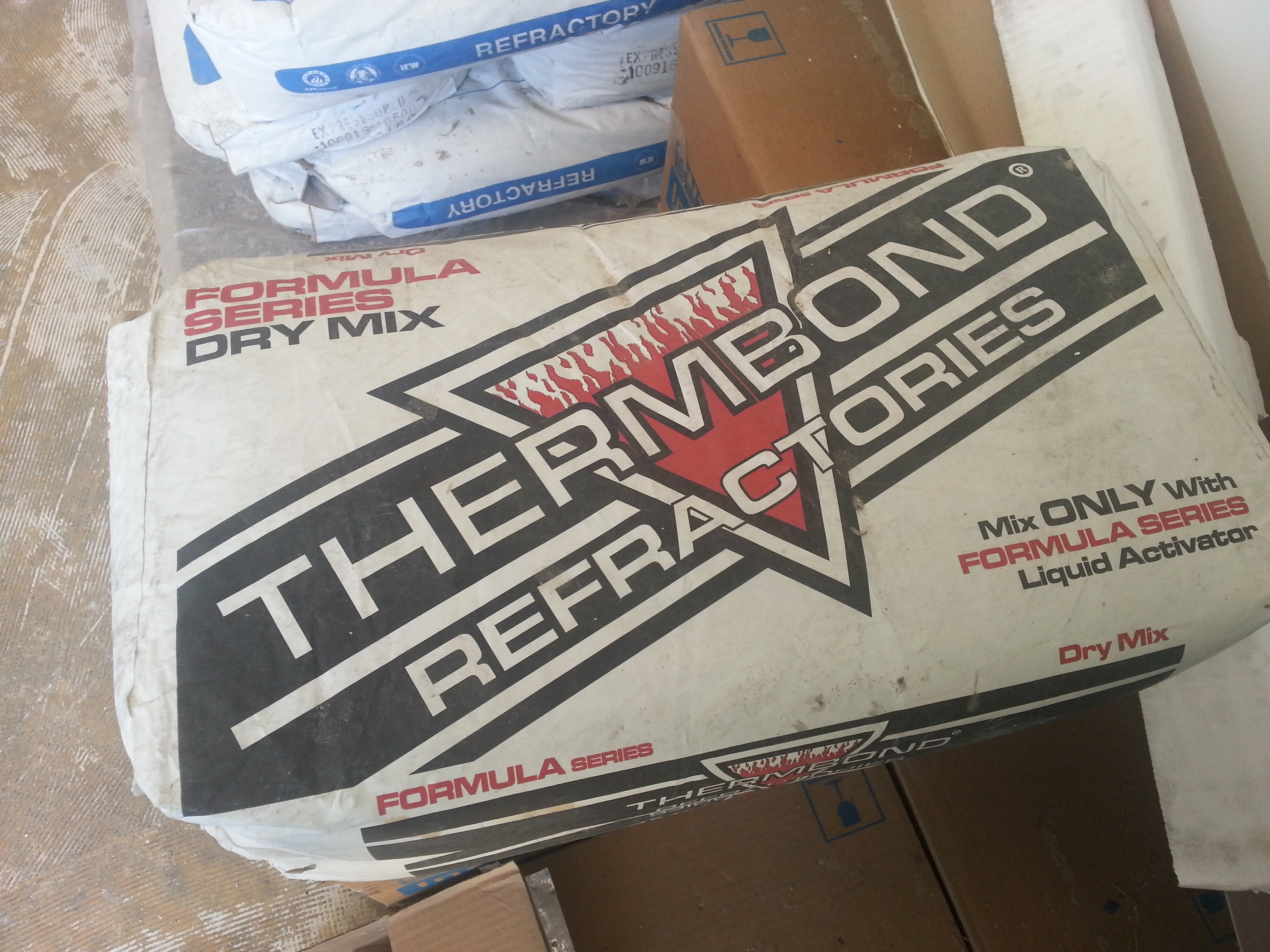

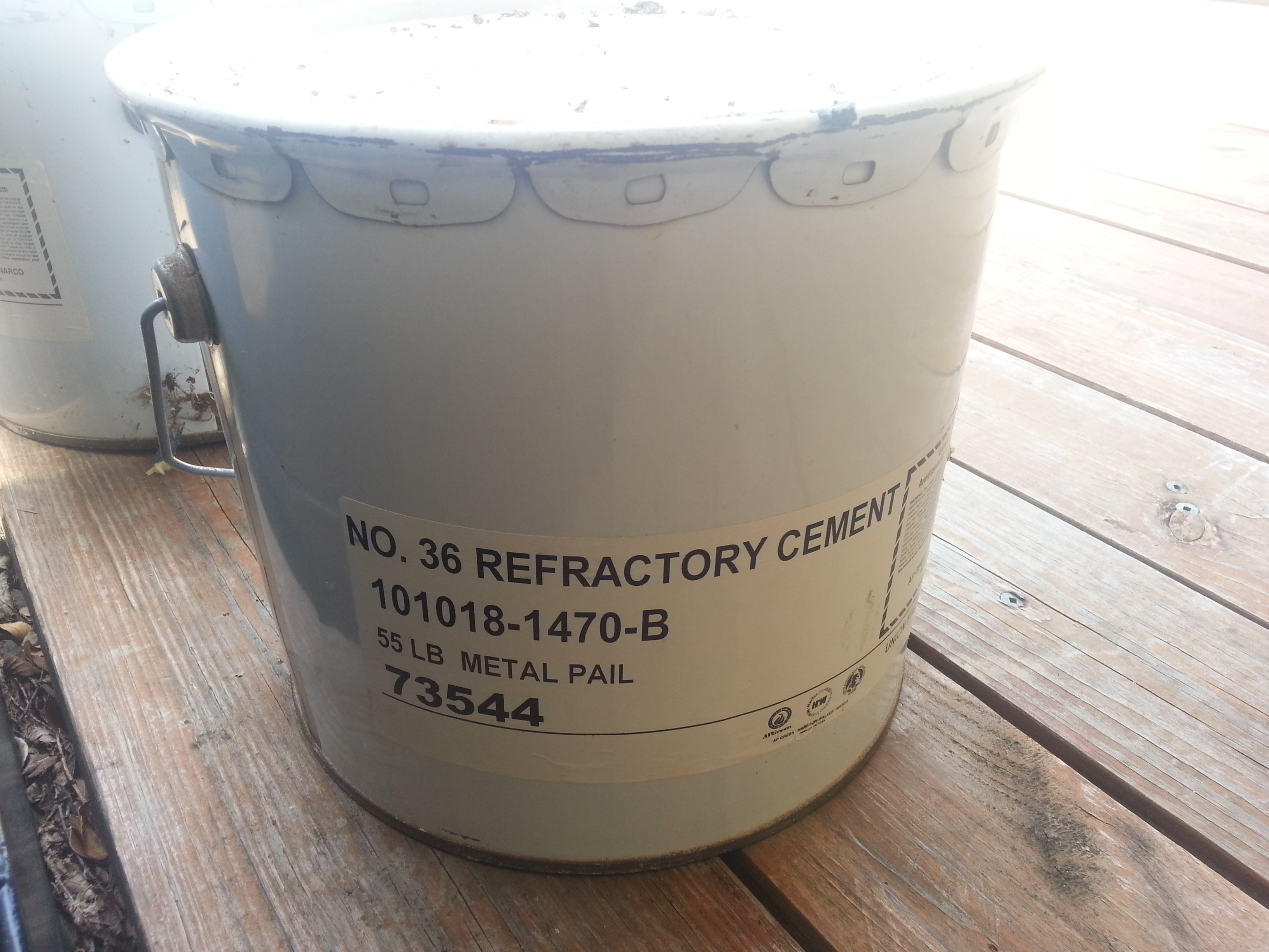

    Anyone have any experience with this mortar? It's pre-mixed and is over $100 a pail. I scored 3 pails for cheap from a guy who builds Crematories.

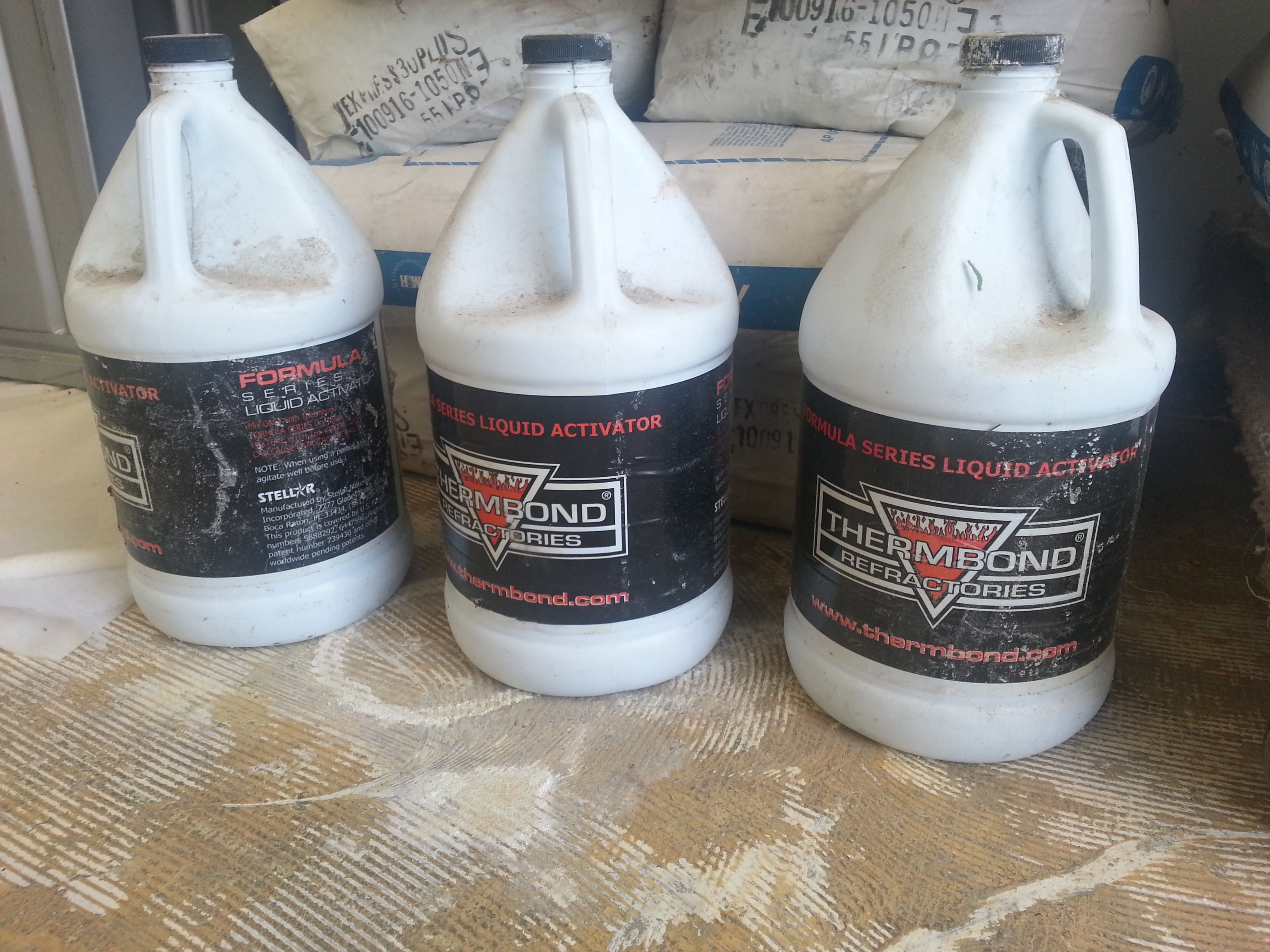

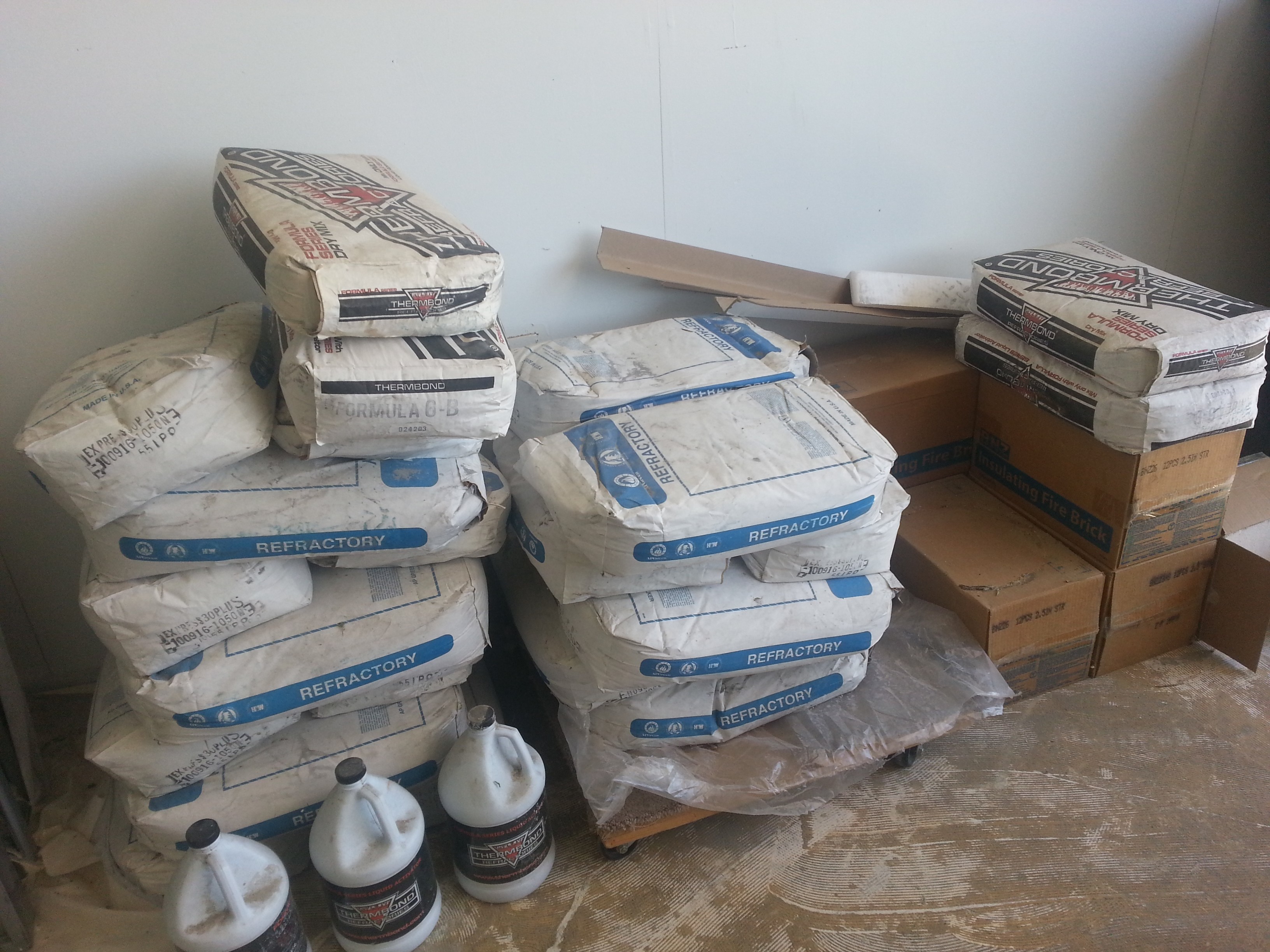

    He had a few other types of mortar that I didnt buy but still could later:
ID:	319992 Click image for larger version
ID:	319993 Click image for larger version

    Re: Pre-mixed mortar? Anyone? Anyone?
    I didn't use the pre-mix. There was some chatter a while back and the bottom line was that it is not recommended. Hopefully one of the refract guy's will chime in. The blanket is good, just stagger and stack as you have mentioned.
      Where in the world did you get that?
      Are you building a cast oven? That is a castable refractory, not a mortar. You will not be able to use it as a mortar, as it is, basically an epoxy and has an exothermic set.
      I won't say it won't work, but you will have issues making it work building a normal oven. I may be interested in a swap to try it as a castable, though.
        I got it from a guy who builds Crematories who had and overstock. I know
        took a chance buying it. He thought it would be OK but I had not read of anyone using it so I was curious about the "food" application. No big deal if I cant. Being near Austin, where did you find your materials? MPI on Todd Lane has some refractory mortar and Fire Bricks. Going to go look soon. Not pinching pennies on this project, I want the best materials I can get, too much work to not get the best stuff possible,, within reason.
          That is where I work, although mostly at the North store. It is food safe, but the set time is very short. You would have to mix an amount to lay each brick basically. Physically it is inside the envelope, practically, not really. I do want to build a cast test oven, so we may be able to work something out.
