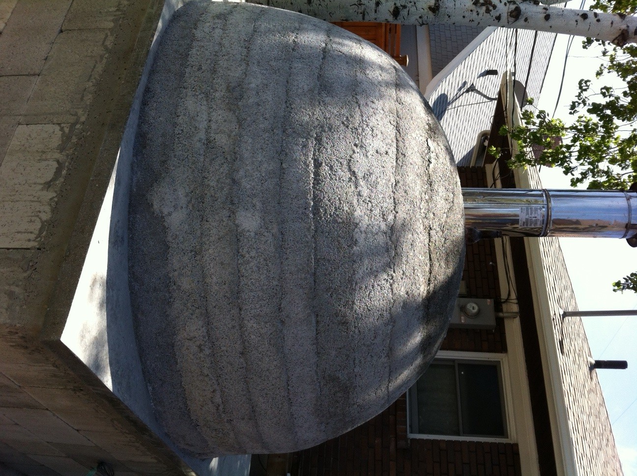

            I used commercial grade perlite for my dome pcrete and did not have any issues with the coated perlite. More important is using the correct consistency, not too dry, not too wet, not too thick at all at once.
