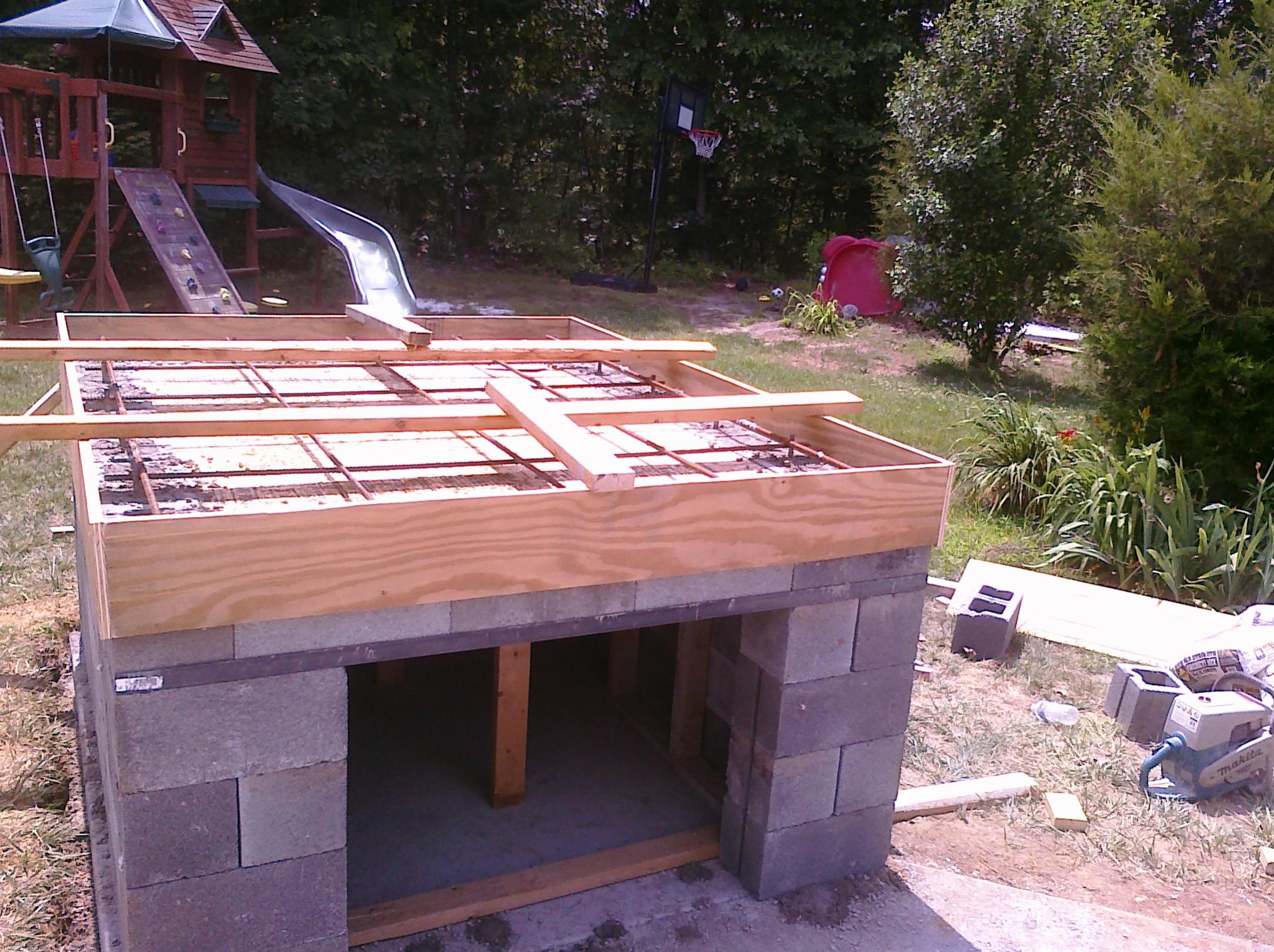

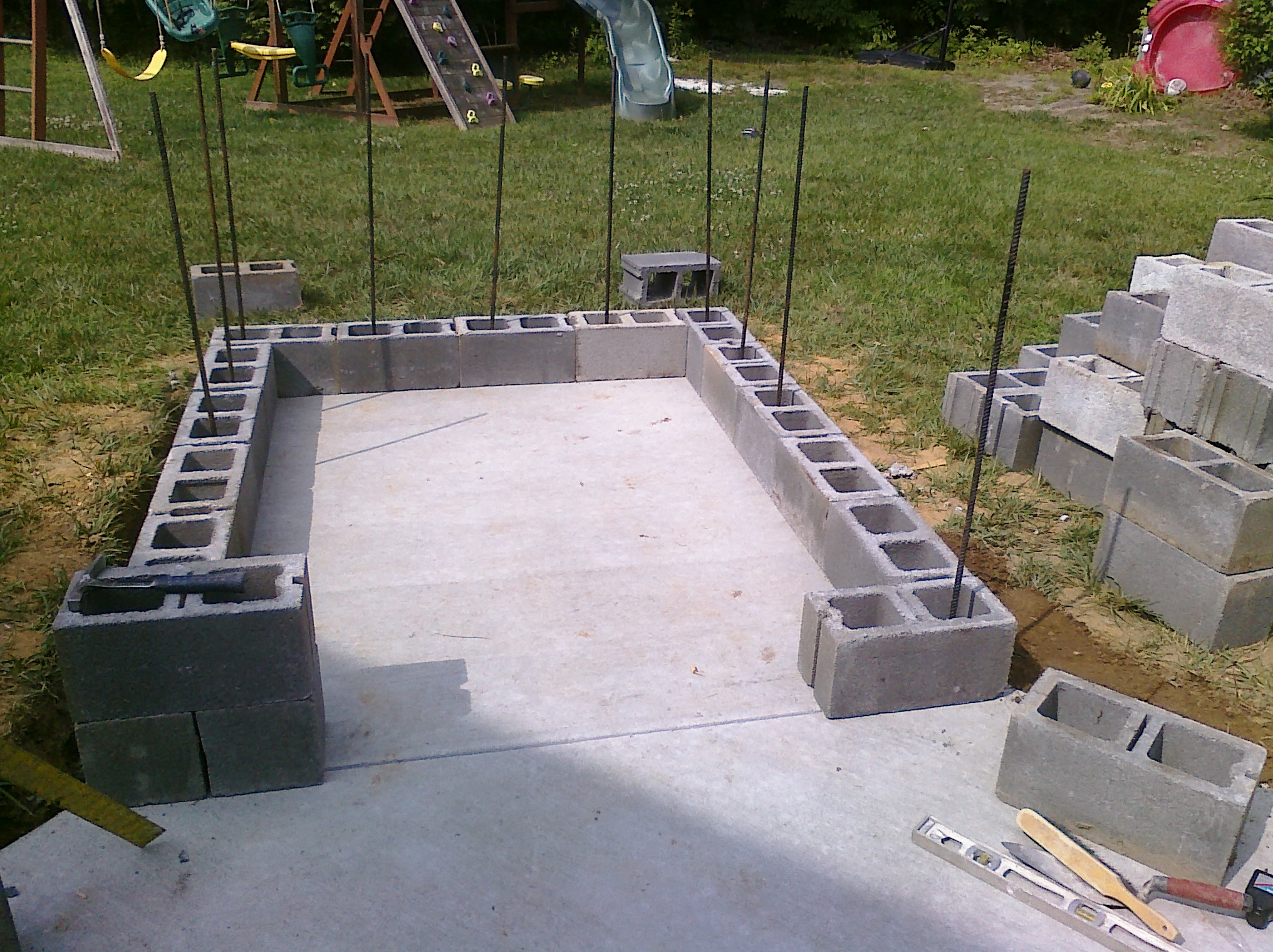

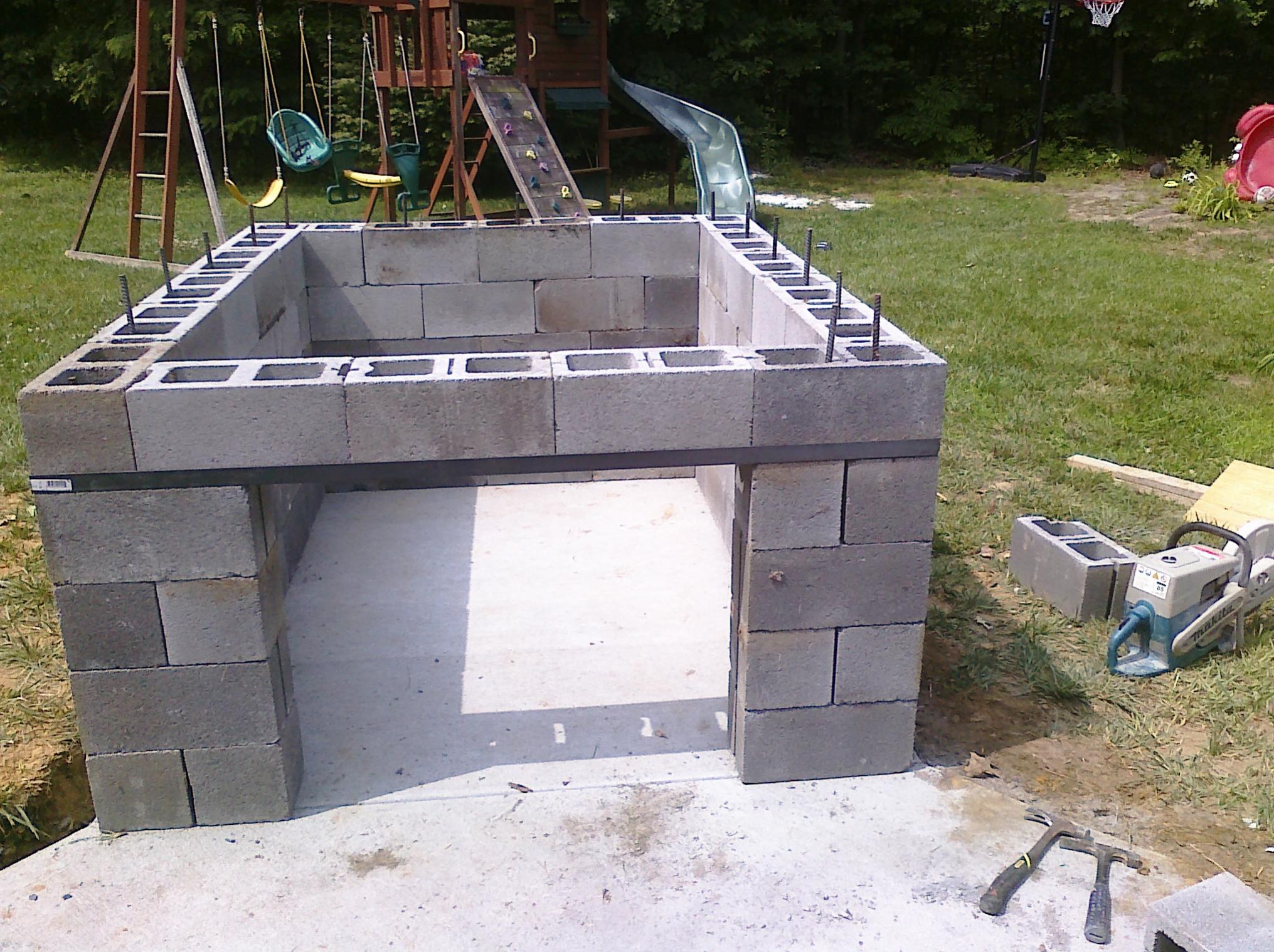

Started this weekend and here is my site so far... i am increasing the size of my "patio" and adding in the stand (oven to follow soon i hope). need to find some insboard or other insulation board. i live just outside of DC in Maryland..... any suggestions?... if not wish me luck, and i"ll post as progress allows

You could cut joints after the pour to control the cracks. It is concrete - it WILL crack, on the upside, no one will steal it.

If I were mixing concrete in a wheelbarrow or in a small mixer I'd do in 3 separate pours, 2 joints separating 3 slabs.

Large or irregular slabs will crack, especially if you have an "inside" corner. The trick is to make then crack where you want. Controlling the cracking is usually done by a construction joint (formed by separate pours) or by cutting a joint 3/4 to 1 inch deep within a day of the pour.

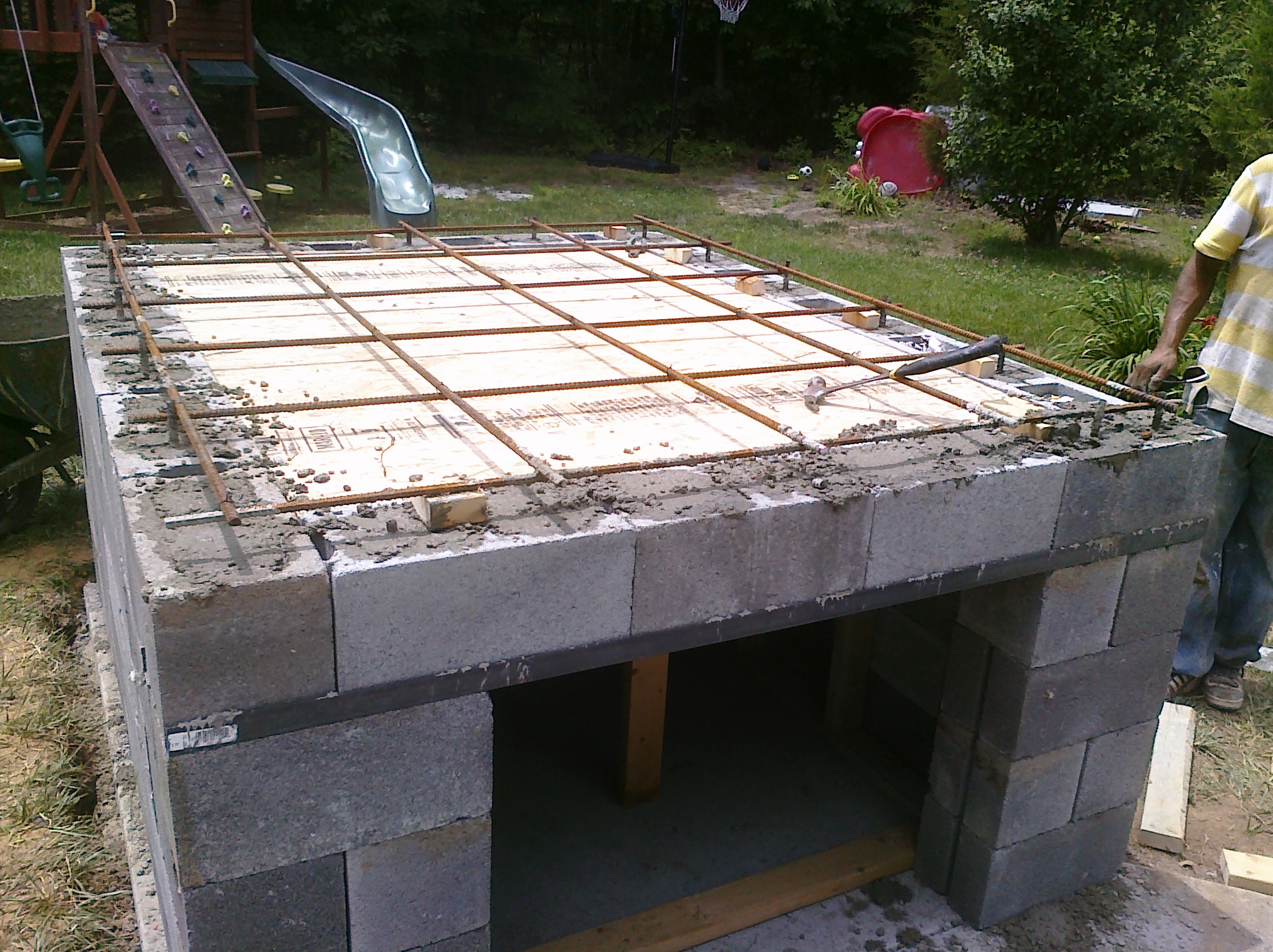

busy weekend,
Had my slabs poured earlier this week and got my stand done. so i was able to pour my hearth today. I decided to go a full course higher on my stand , it seems a bit more comfortable for me (hope i do not regret it later). So i am now waiting for my insulation to come in (should be midweek). i was unable to source 2" ceramic board so i ordered 1" but will double up. I assume the weight of the oven will be enough to hold the layered boards in place (i hope so)

Sure will! Well, assuming "normal" weather conditions I guess.I assume the weight of the oven will be enough to hold the layered boards in place (i hope so)My Clay Oven build:
