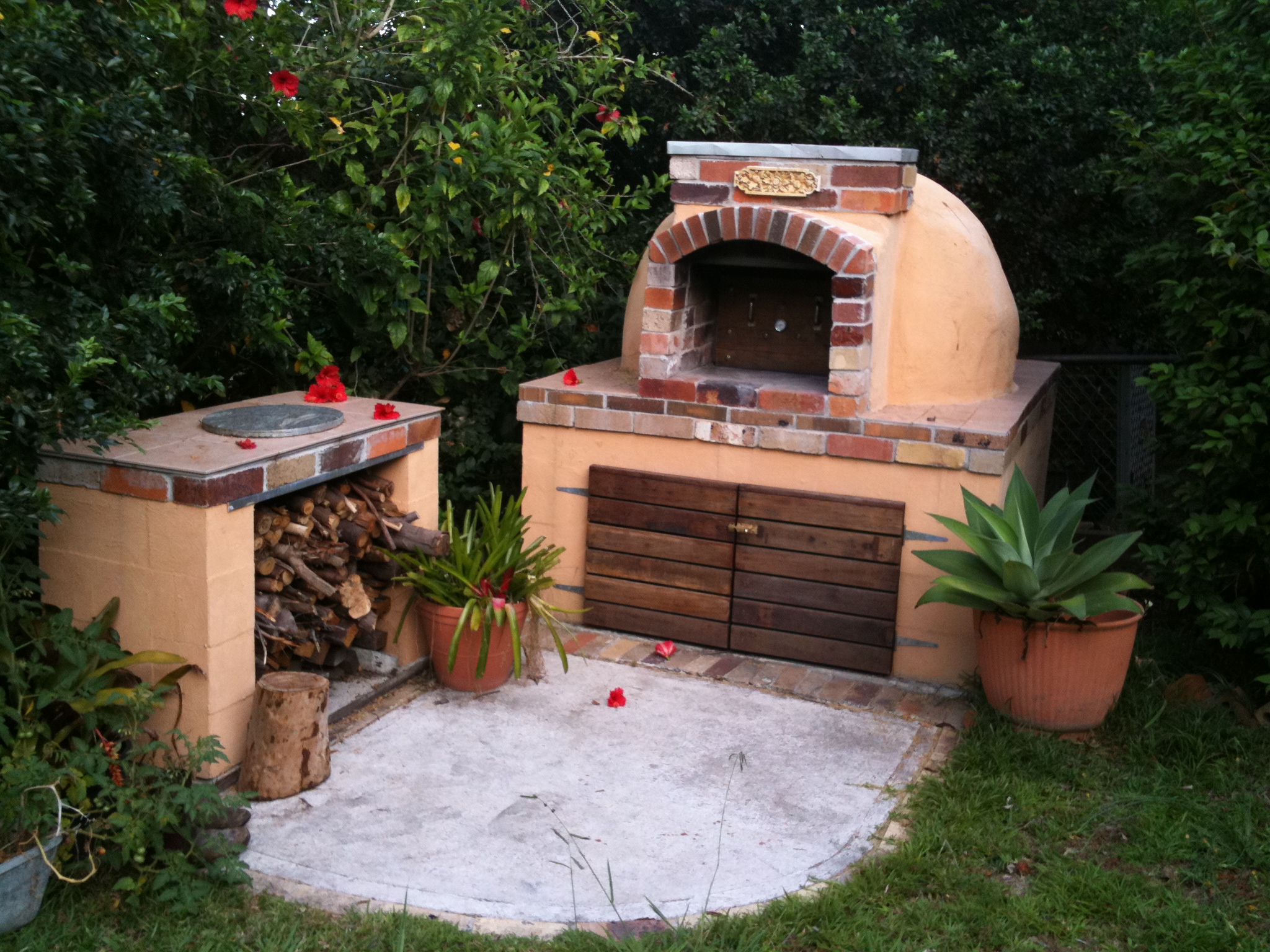

        Gudday
        yes I have used plain brick for my entry/chimney ....no probs...
        You have to admit firebricks are pretty boring looking ....gives you a chance to bring in colour and texture
        Regards Dave

                    • 2849
                    Re: Entry/landing brick to use?
                    Gudday
                    Love to use old bricks love the difference in colour and texture....and found it suits my less than perfect bricklaying. Theres a pretty funny lot of bricks and payers used commons and house bricks. One brick came from an old pub (hotel) that was 100 yrs old and we used it as doorstop for years and some more from our old church building when they took it down ( fire damaged)...so the ovens got a bit of history and interest
                    Regards Dave
