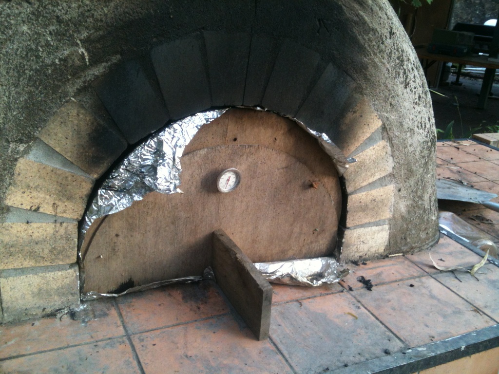

                              Gudday Annie
                              I could think of many reasons for that thing not to work but it did a number of times! for a friend of mine. I'm sure you can do better
                              Regards Dave
