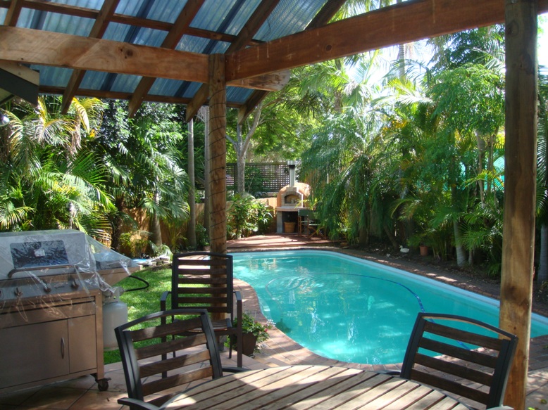

                        My pool is nearly downwind of my oven. In the photo below the camera is facing southwest. The prevailing winds here come off the ocean at various points from southwest to northwest. I have had no problems with ashes/embers to speak of that I can recall, but even if some fell in, I don't see it as a big issue. Like everyone with a pool, we get leaves in our pool, bugs, and even a mouse once in a while. The skimmer, vaccum, and filter take care of that stuff.
                        What was certainly noticeable was when I was grinding brick with a 4.5 inche angle grinder I would get tiny little drifts of firebrick dust accumulating at various points on the bottom of the pool until the random pattern of the vaccum eventually got there.
