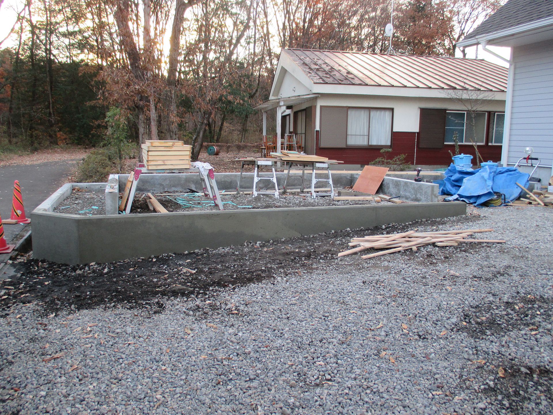

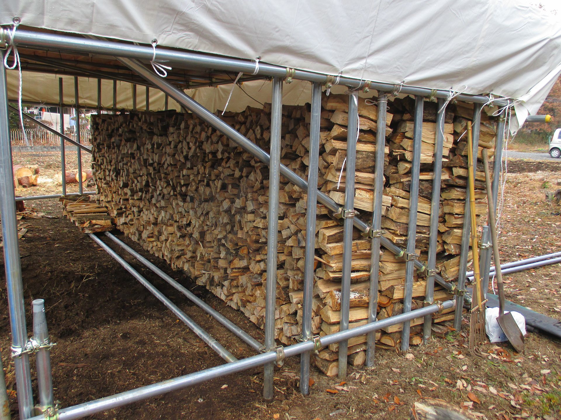

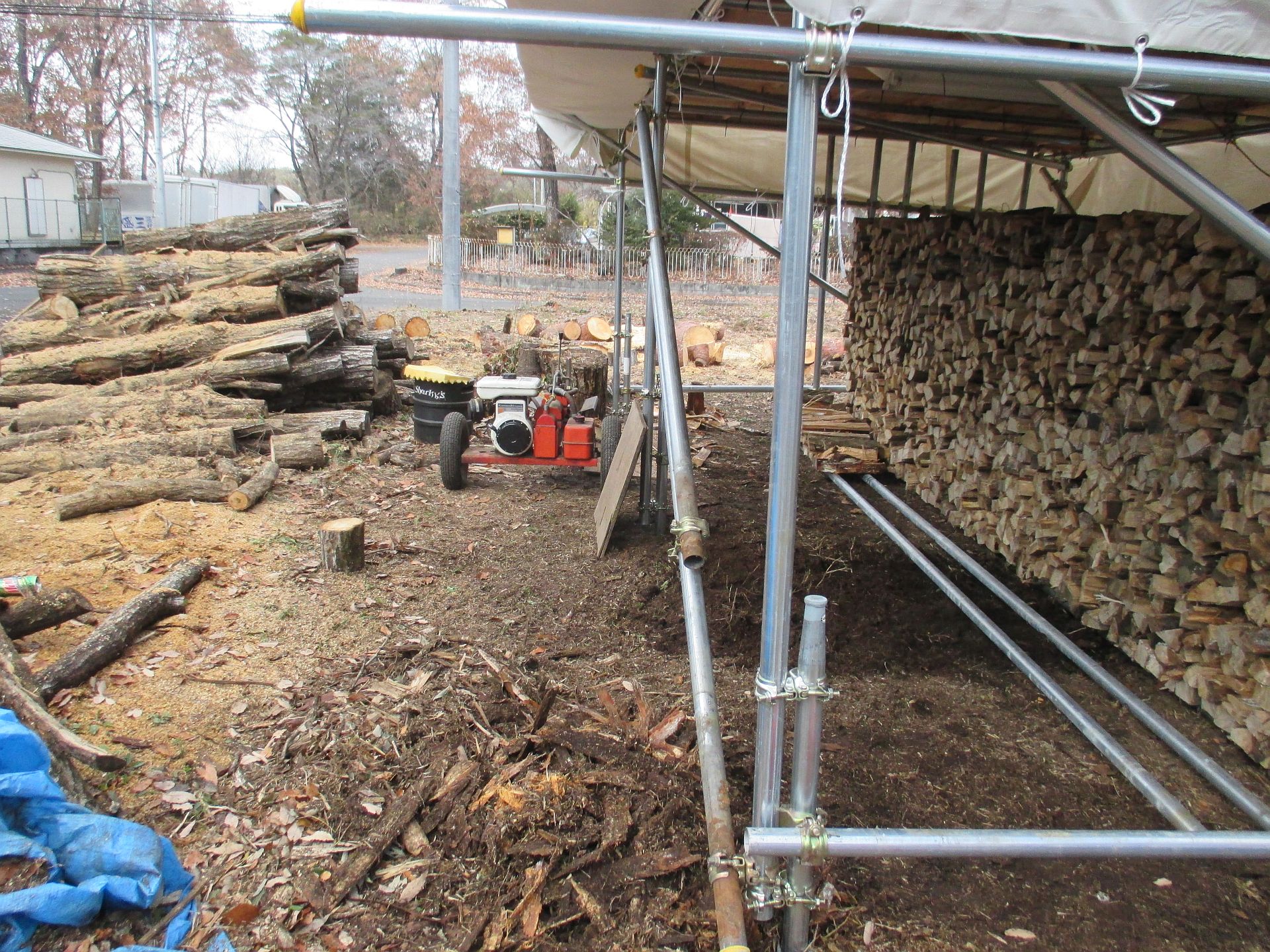

            I disassembled the previous woodshed, did ground preparations, formed and poured the concrete for woodshed and oven location---now the concrete is curing so time to hit the wood pile hard and see if I can cut and split all before work calls me back to being busy. Had to make a temporary structure to keep the newly split wood undercover until it can be loaded into the new woodshed. That is still some time off!
            The concrete took a bit of wind out of my sails. Mixed it all by hand, but surprisingly it came out better than I expected. All the walls are 150mm thick with reinforcing steel (welded together)--I am lousy with tie wire!
            Maybe a home for the oven soon? When who knows?
            I am sure lucky to be able to use my friend's wood splitter. It sure can bust apart some mean pieces of oak--even chunks where the tree wyes or large branches begin. Just tears right through them without even a cough!

              That is a serious amount of wood. You foundation look very good especially with a hand mix/pour. It is cold here, 9-10 degree F in the morning with a high of mid 20s. Nice to have a neighbor with a splitter. Were you not looking a building one from an engine you were rebuilding?

                The concrete work did end up being a pretty hard project. Used almost 4 tons each of sand and 1" crushed rock. The design and need for a retainer wall developed as I worked with the variation of land levels. When I have free time, I just like keeping busy no matter how difficult the project might be.

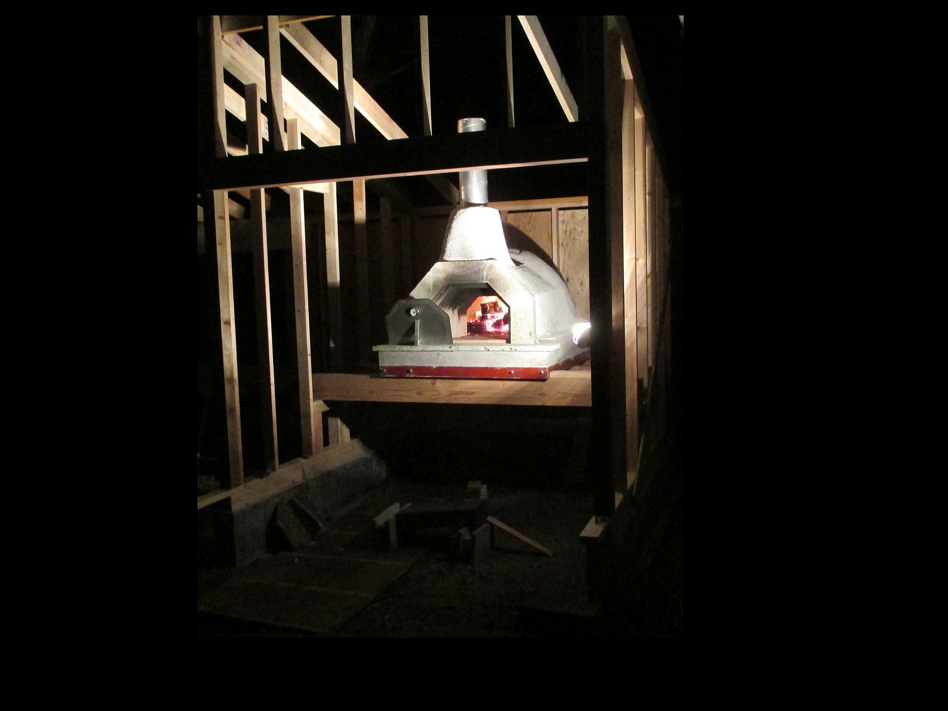

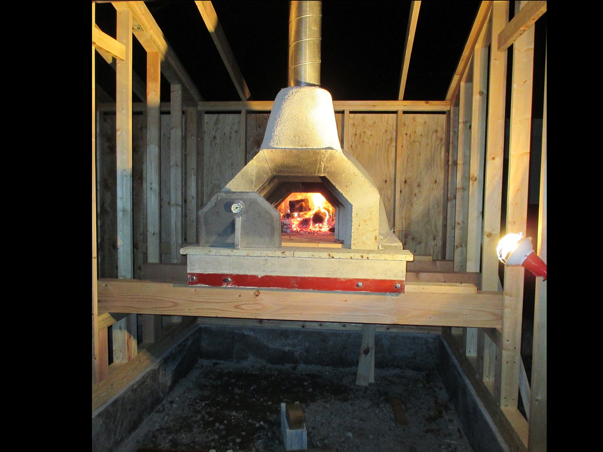

                  Got the oven outdoors over the last few days. Now a lot of work to get everything wrapped up and finished. That should take 2014, but will be able to use the oven much earlier under any weather condition.

                  Oven is supported by 3- 180x105 Douglas fir beams (free span 2185 mm), this gives an open area under the entire oven. And now the entire oven can be insulated again.

                    No more bending over to cook pizzas, enclosure is looking very nice and precise as usual will all of your fabrication processes.

                      Right now, without the ground slab in place, it is too high for easy access.
                      Once the concrete slab is done, it will be fine for me, but my wife will need a booster bench. Otherwise it is OK. No possibility of lowering it now.. just don't have to equipment necessary and won't borrow any again!
                      When the enclosure is finished, pizza making will be like the old saying for the USPS--concerning bad weather deliveries! Don't know current motto of Post Office.

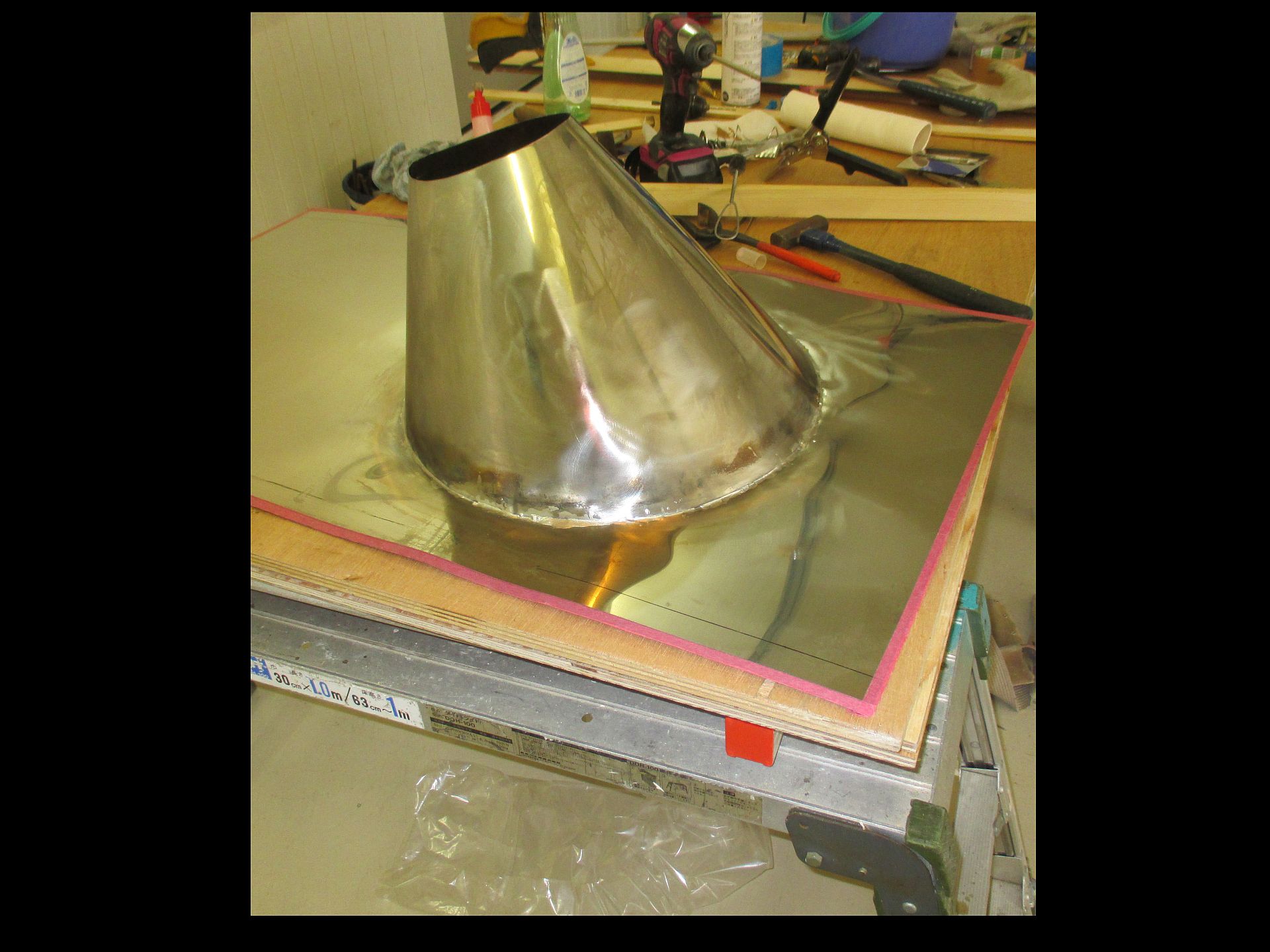

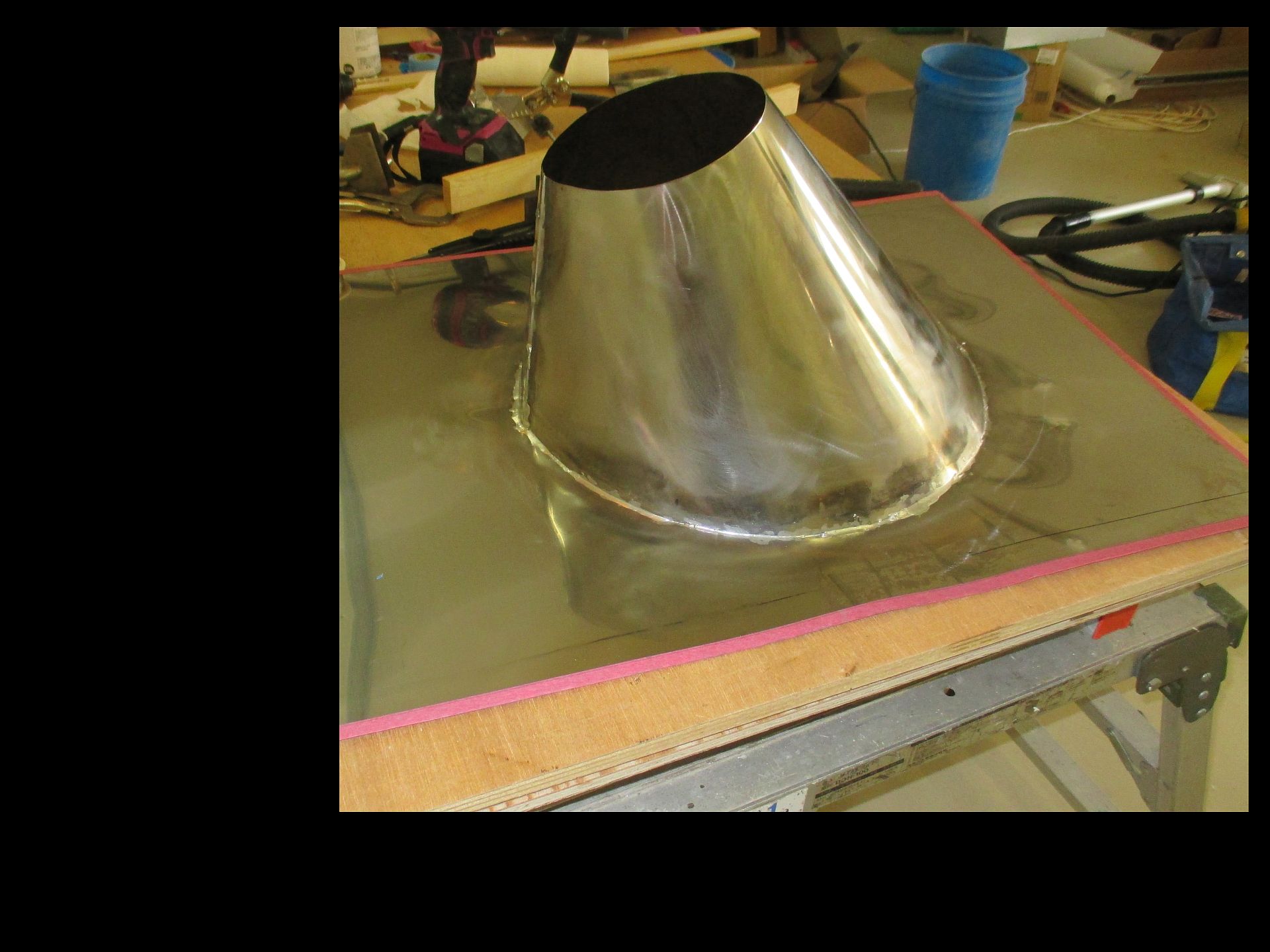

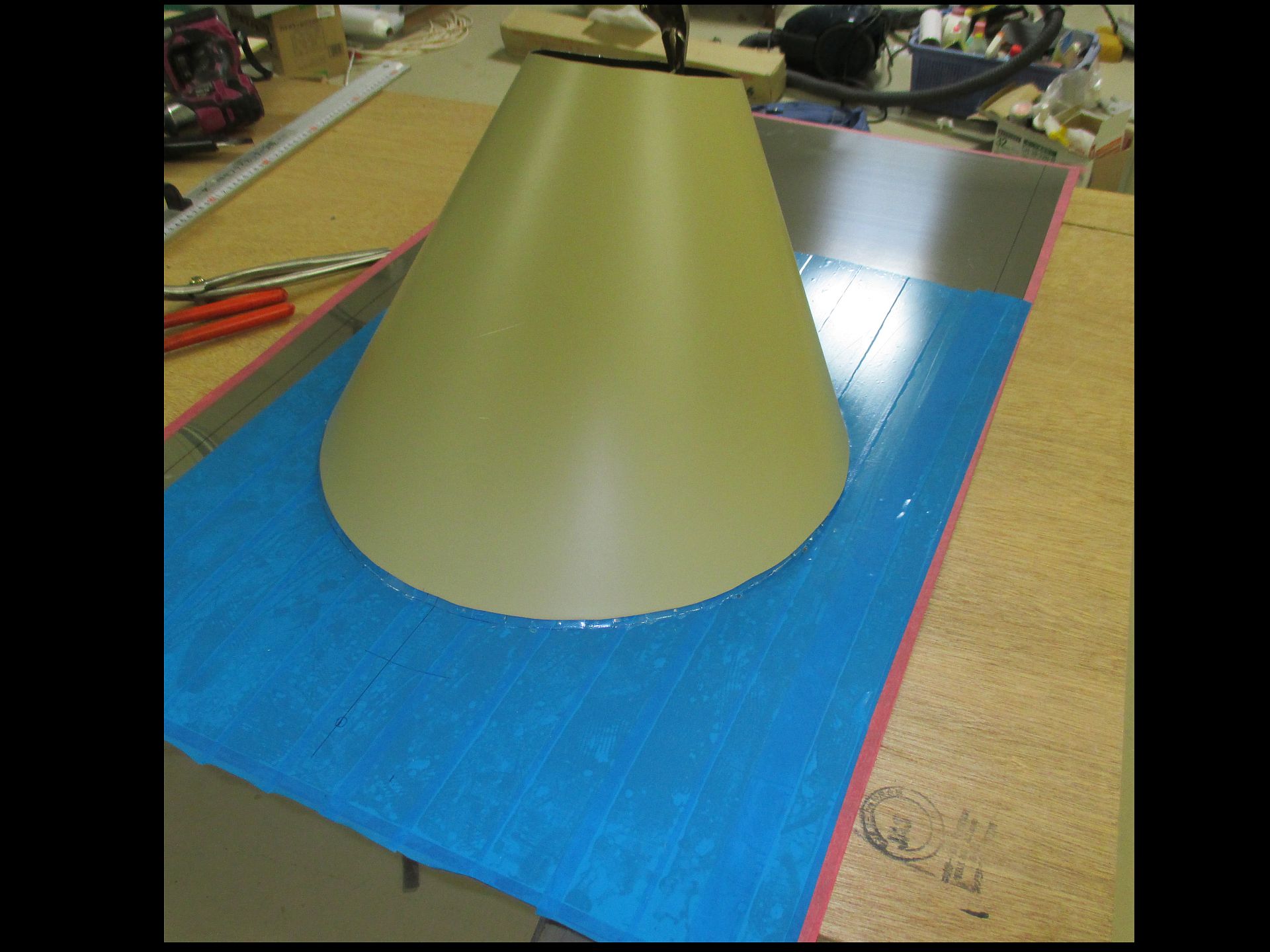

                        Most of my roof is in place but the biggest hang up is the roof flashing for the chimney stack. Been trying to save some money in doing the work myself -- again. Fireworks stove shop wanted over $200 for a roof flashing, so did some web surfing how to fabricate a cone from sheet metal with a roof slope; tried the graphic layout first on plain sheet metal, then transferred pattern to .3mm stainless. Then had to try soldering stainless.
                        My joints came out OK, but having clean metal I guess is the trick. Washed everything with soap, then acetone, then flux and finally soldered. The stainless really heats quickly so you have to be very watchful and do a little at a time. But do able! The seams "are not perfect" but they hold together. Will seal one more time with paintable silicone, then spray the transition black with high temperature stove paint.
                        The silicone should be far enough from the stack not go be combustible--I hope.
