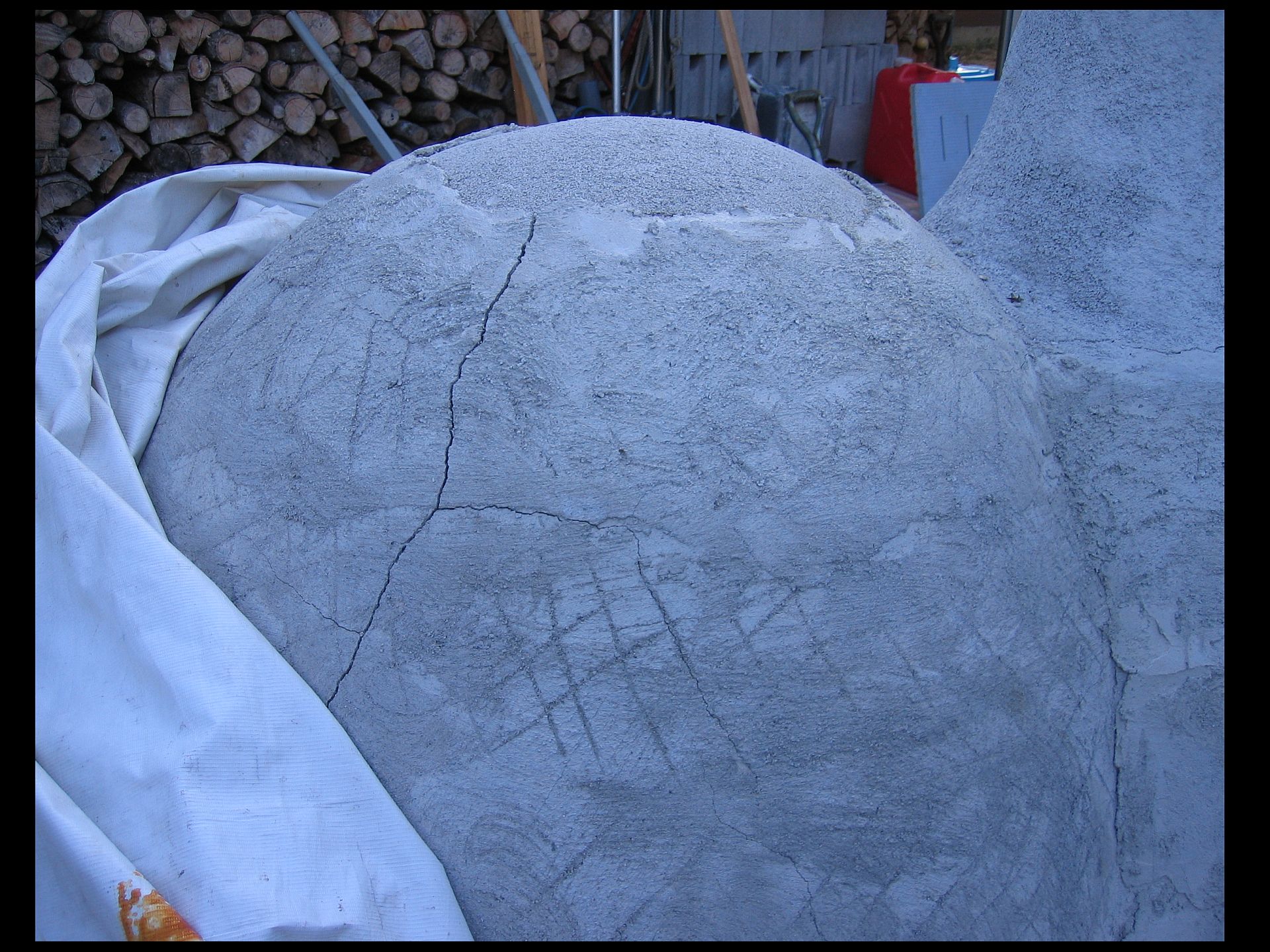

    Now I have to think about this topic. The oven is cured, but it does not have a final render coat or anything to make the oven waterproof or water resistant--if there is a difference.
    My oven heats up very quickly, but it looses heat equally quickly! If you have been following my thread, I have at least 4" of pericrete surrounding my entire dome.
    The pericrete has cracked, so what--the castable has not! But where the cracks are, there are hot spots. Hot enough to make you pull your hand away because it is too hot! Other locations are cool, like around the insulated chimney.
    I am thinking about adding a layer or two of ceramic fiber to the outside of my render, then apply chicken wire and another coat of render!
    Anyone see any problem with this idea? As long as the oven is insulated, the location of the insulation in the assembly is irrelevant--- RIGHT? Please, please correct me if I am wrong! If I add two layers of 1" thickness ceramic fiber to the outside of my --now half complete render coat, it should help retain heat longer--even though it is not the closest insulation in the total assembly!

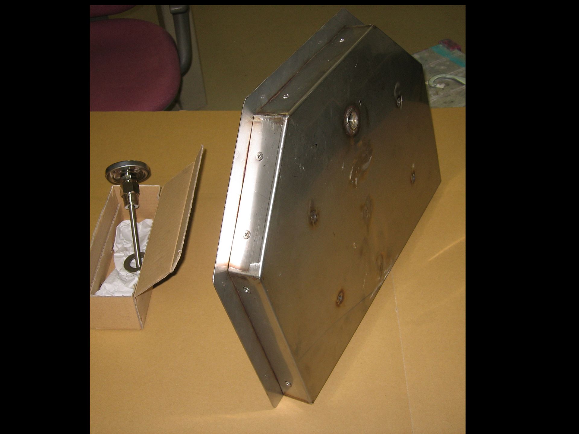

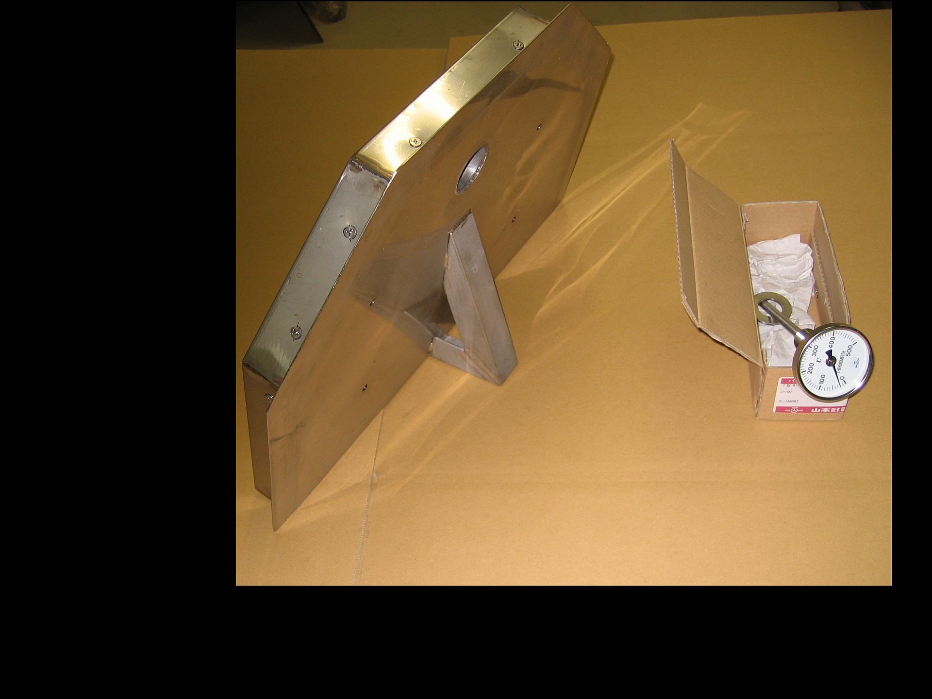

    Door in progress-
    Same time I got wood stove woven rope (door seal) and furnace cement to attach to rope to the door surround. That should seal things up nicely! Have to wait a few days to put the time into finishing the door!

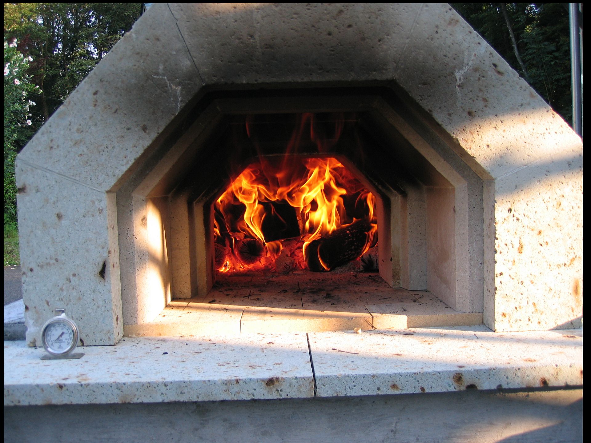

    I am beginning to learn a few things about using a WFO--I guess it all takes time, each oven is a little different...so no one can really give exact advice on how to fire one over the other.
    Sunday, I did not start a fire until early afternoon 1530 or later...after it began burning nicely...I loaded it completely with dry oak firewood and let it roar. Really not too much roaring but the fire quickly heated the oven to what I believe a saturated temperature. I quit putting wood into the oven around 1800 and removed the coals at 2000. Instead of using a "blow tube" that you physically blow into, I took a 5' section of 3/8" flexible copper tubing , one end flared and used the "blow gun" and compressor to blast air into the oven!
    It makes a pretty good cloud of ash dust, but it does clean the oven nicely. I just stay out of the line of the hot ashes and left over charcoal pieces that fly around!
    Since I do not own any peels yet, I put a pizza--maybe 12" diameter on a pizza pan into the oven. I noticed that the crust started moving around as soon as the pan hit the bricks. After checking several times (the bottom of the crust) for browning- I removed the pizza in a little over 3 minutes. Everything looked fine and the crust was not burnt in anyway! Just a nice crust.
    While removing the pizza, it started to sprinkle and rain developed quickly! I had already removed the SS chimney when I blew the ashes out--so all that was needed was to put something over the chimney hole--a couple of firebrick that were handy and then pull the tarp over to keep water away! I really hope I can find time to make an enclosure and base for this oven. Like Brickie was saying before--to paraphrase his comment--just another Japanese thing that you had to kneel down to use! The kneeling down is beginning to be a pain in the butt!
    Oven holds heat pretty well, morning after temperature still over 260degC, roasted a block of beef in the morning--evening temperature still over 200deg C.
    Ended up baking a few loafs of bread the following day!
    I'll see if there is some pictures to attach..
    Nice to use the oven--even though it is not done!
    The oven really fires up quickly, the entire casting shows no signs of cracking. It is a 2 piece dome, with separate transition to landing and chimney. I don't know all the fuss about brick cracking???? The pericrete has cracked and so has the render (first coat).
