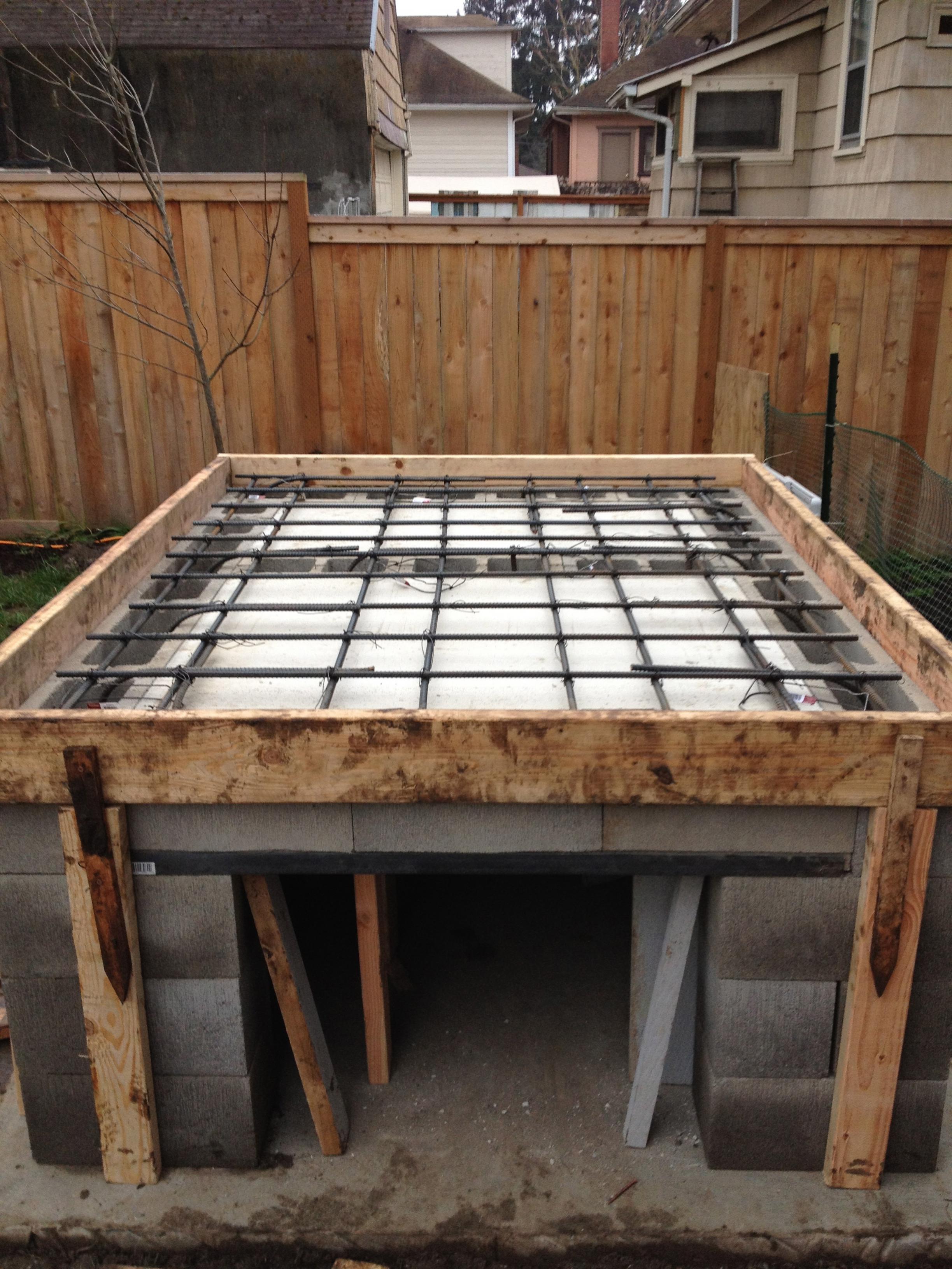

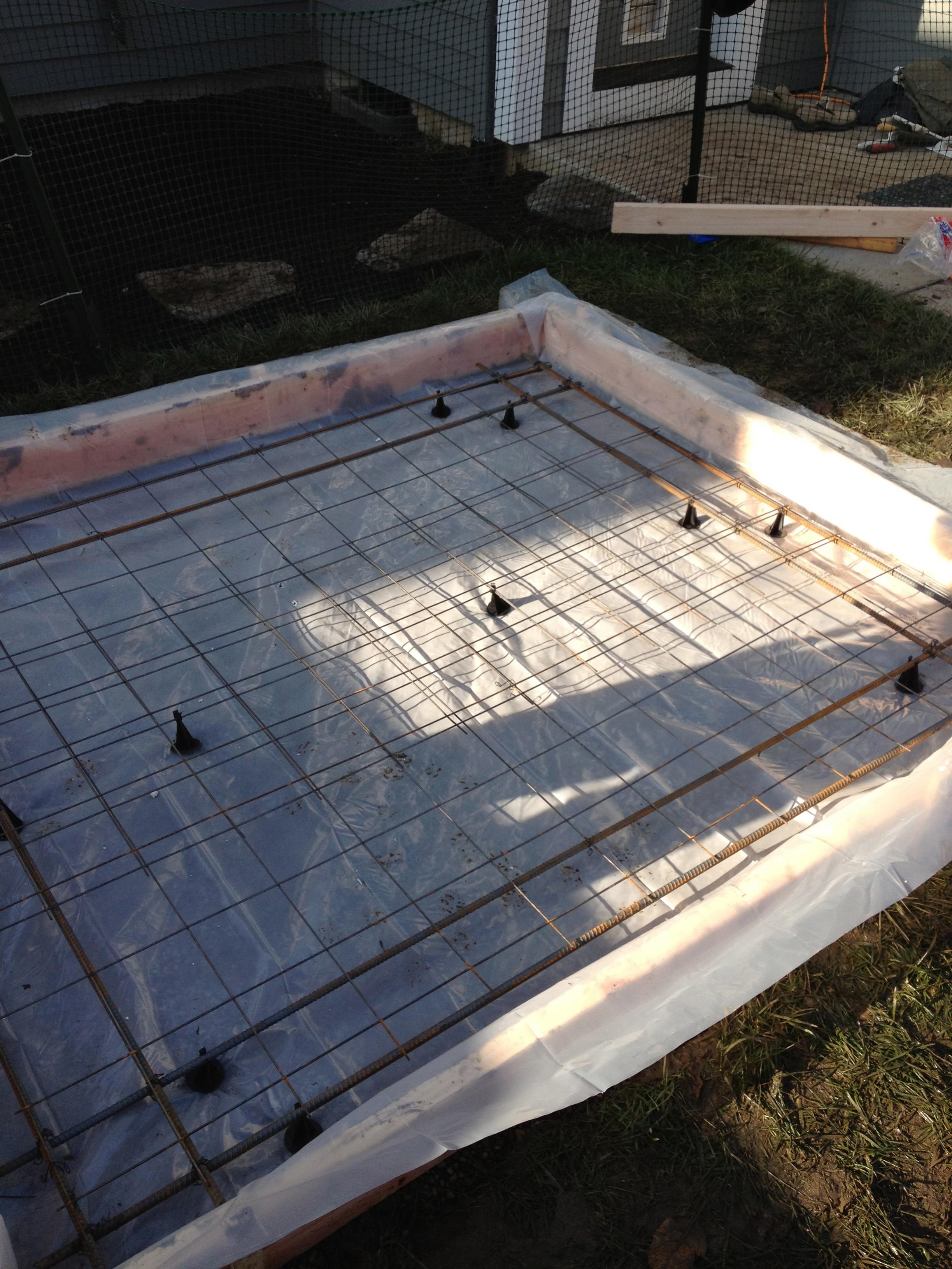

    After being a mooch for so long, I finally have something to post to the forum. I have started my 42" build in Portland, OR... going to be doing some wet-weather construction shortly.
    We had a couple of nice weekends, so I tried to capitalize on them as best I could. It turns out planning is not my forte... I was tying the last of the rebar together as the concrete truck was pulling into the driveway! It was my first time working with concrete, and I am glad that it will be hidden by the oven stand.

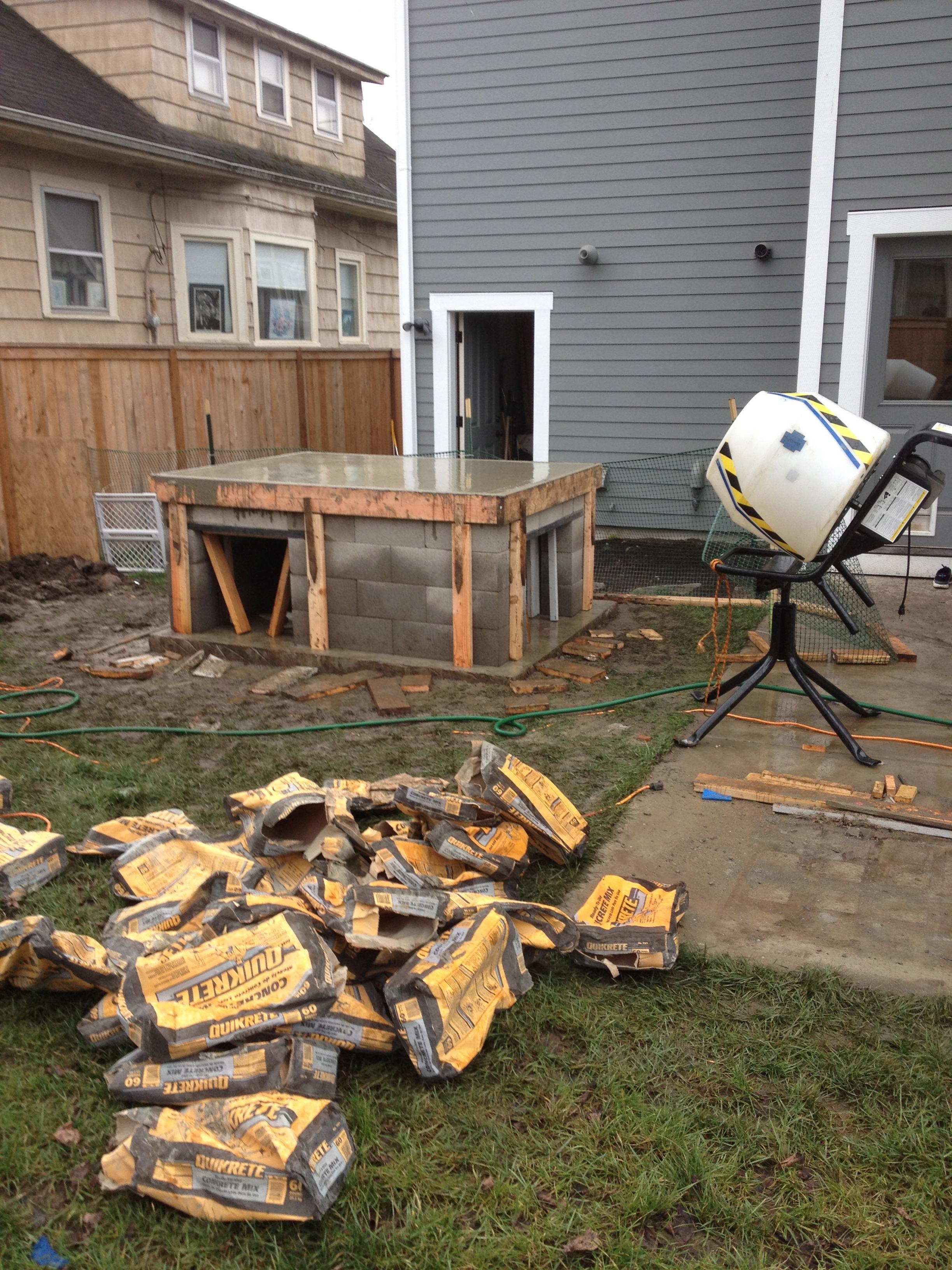

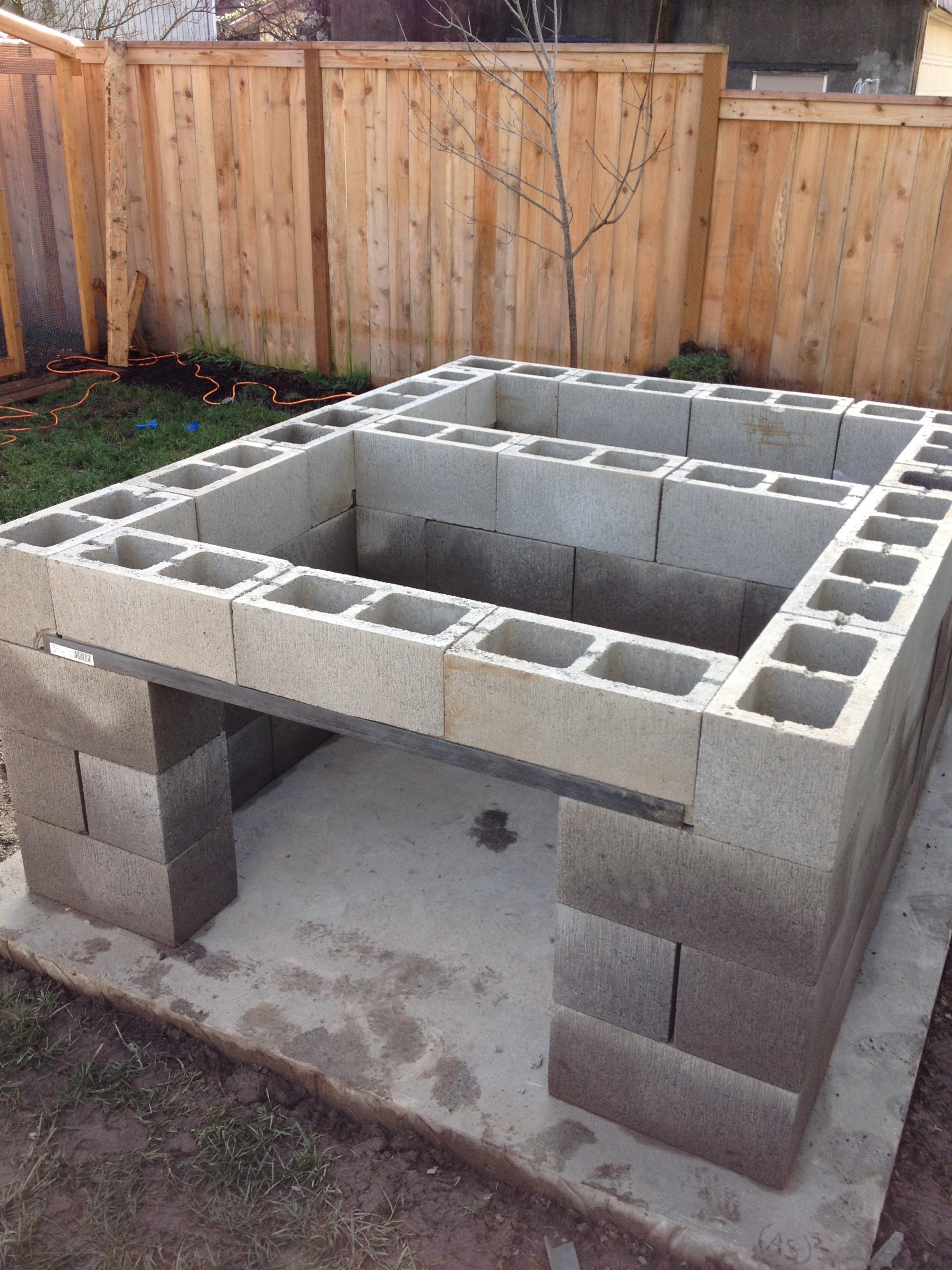

    I have shamelessly copied from the wealth of information on this site, and have modeled my stand after others on here. I have a wood storage area in the front, and a shovel / tool storage area in the back.

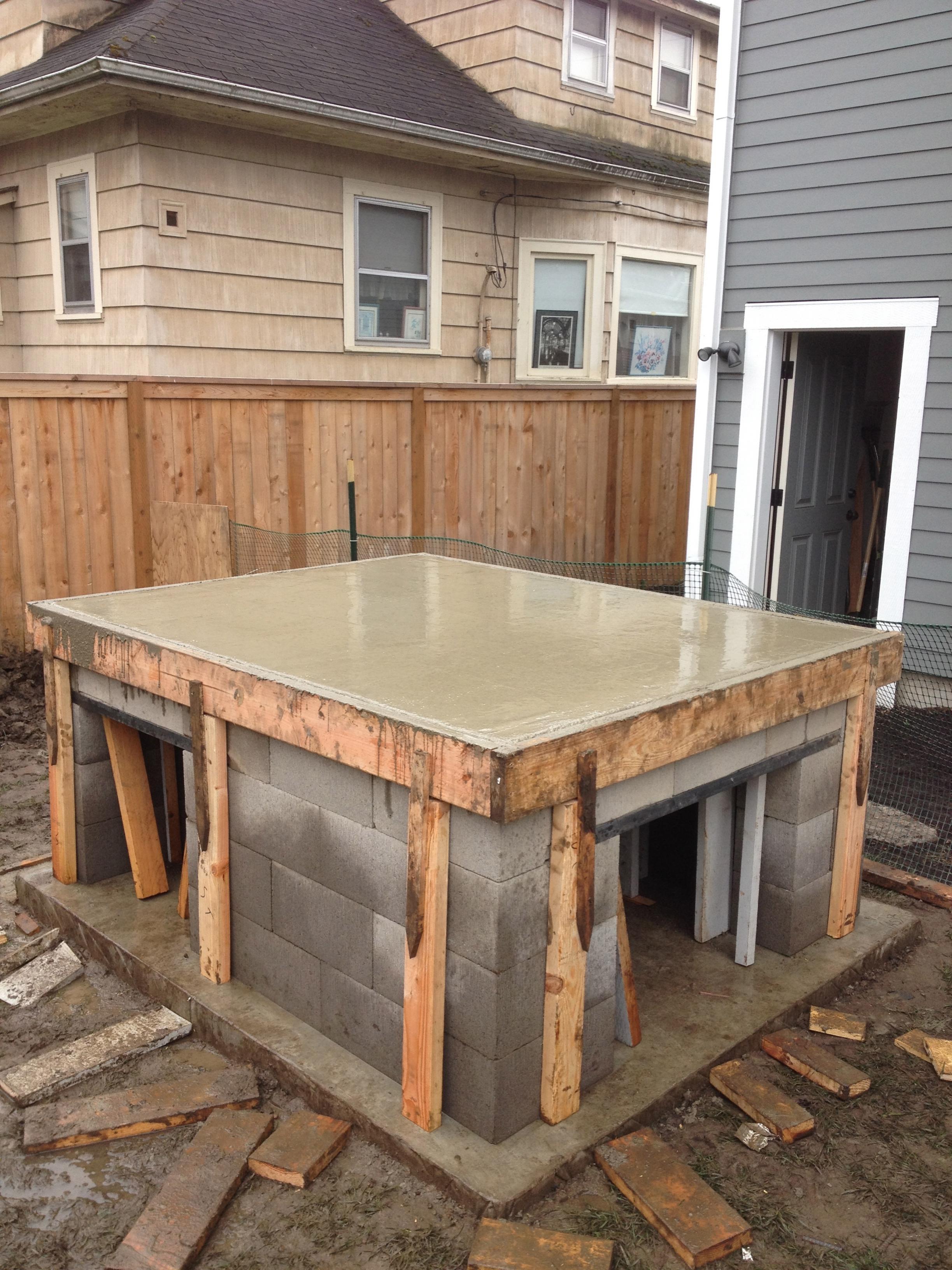

    Finally got the hearth poured, cured, and the form removed. Boy is that a great feeling - being able to stand on a piece of concrete that I poured. My wife was definitely surprised how big these things are...
    Were I to do it again, I don't think I would try to use the little mixer for the hearth pour. 3200 lbs of concrete gets a bit tiring when you are lifting it multiple times (into the car, around the house, into the mixer, from mixer to hearth). Who needs a gym with hobbies like this?

    I'm impressed! I mixed 2 bags of concrete in the "little mixer" for my hearth slab and then immediately went to the phone book and called for the delivery of a yard of premixed. Guess that I'm too old for the gym or that much manual labor.
    You might want to consider putting in a thermal break between your enclosed oven and the landing bricks. It doesn't need to be very wide, but it seems that many here on the forum highly recommend it.
    Are you going to build a cover for the oven so you can use it during our rainy winters?
