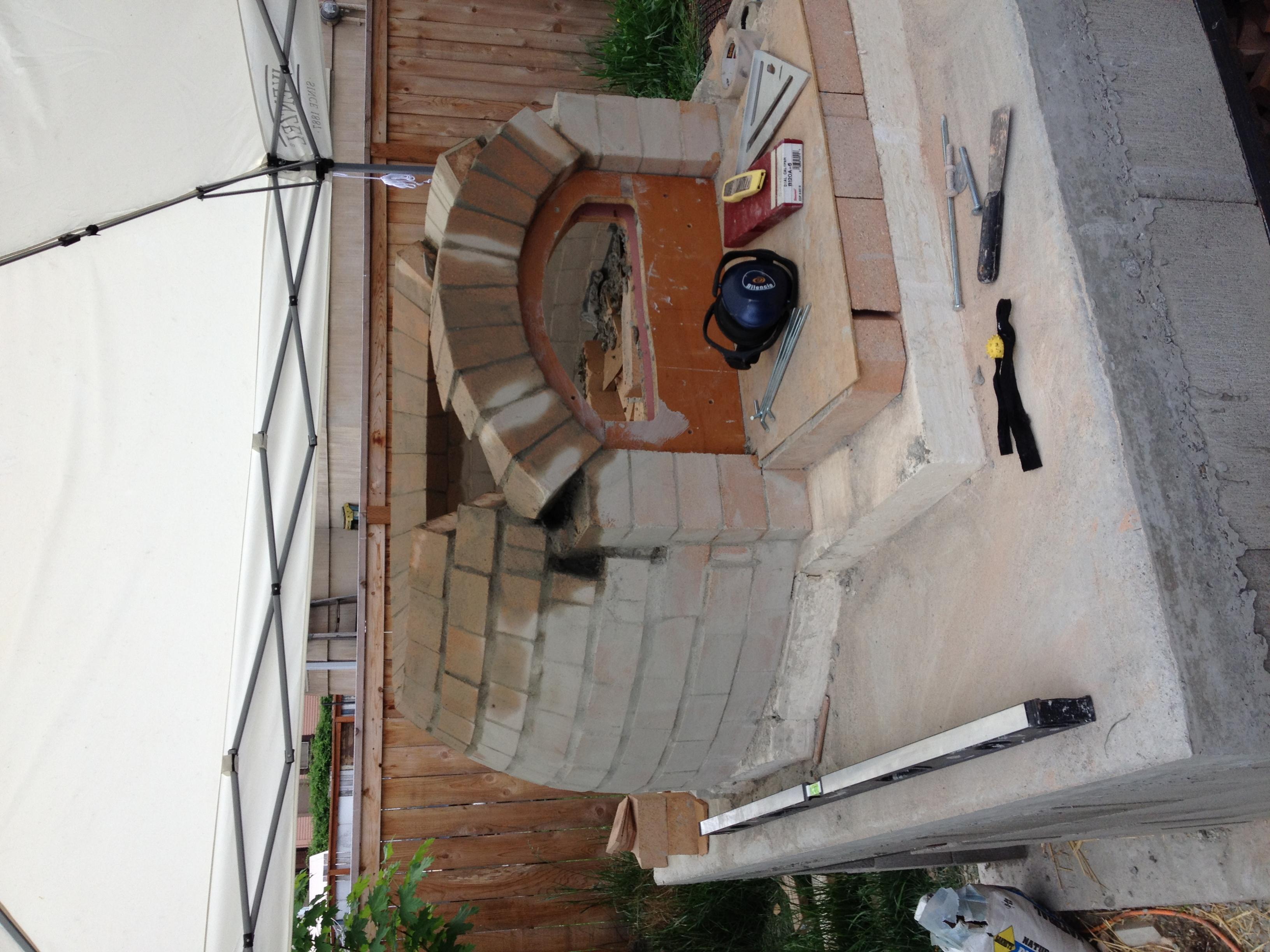

                                #30
                                Re: 42" in Portland OR
                                I had gotten the recommendation to use a higher amount of fireclay in order to slow down the shrinkage / cracking of the mortar. If this hasn't been the collective experience of the group, should I go back to 1 part (rather than 1.5 parts) fireclay?
                                I took the entry arch apart and reset it. Man, that was a pain in the ass. Nothing like spending time to re-do a part that you had already mentally checked off.
                                Anyway, here's a quick update pic of the progress. I'm certainly not going to win the award for the prettiest or cleanest dome of 2013, but I am hoping it will work just fine.
