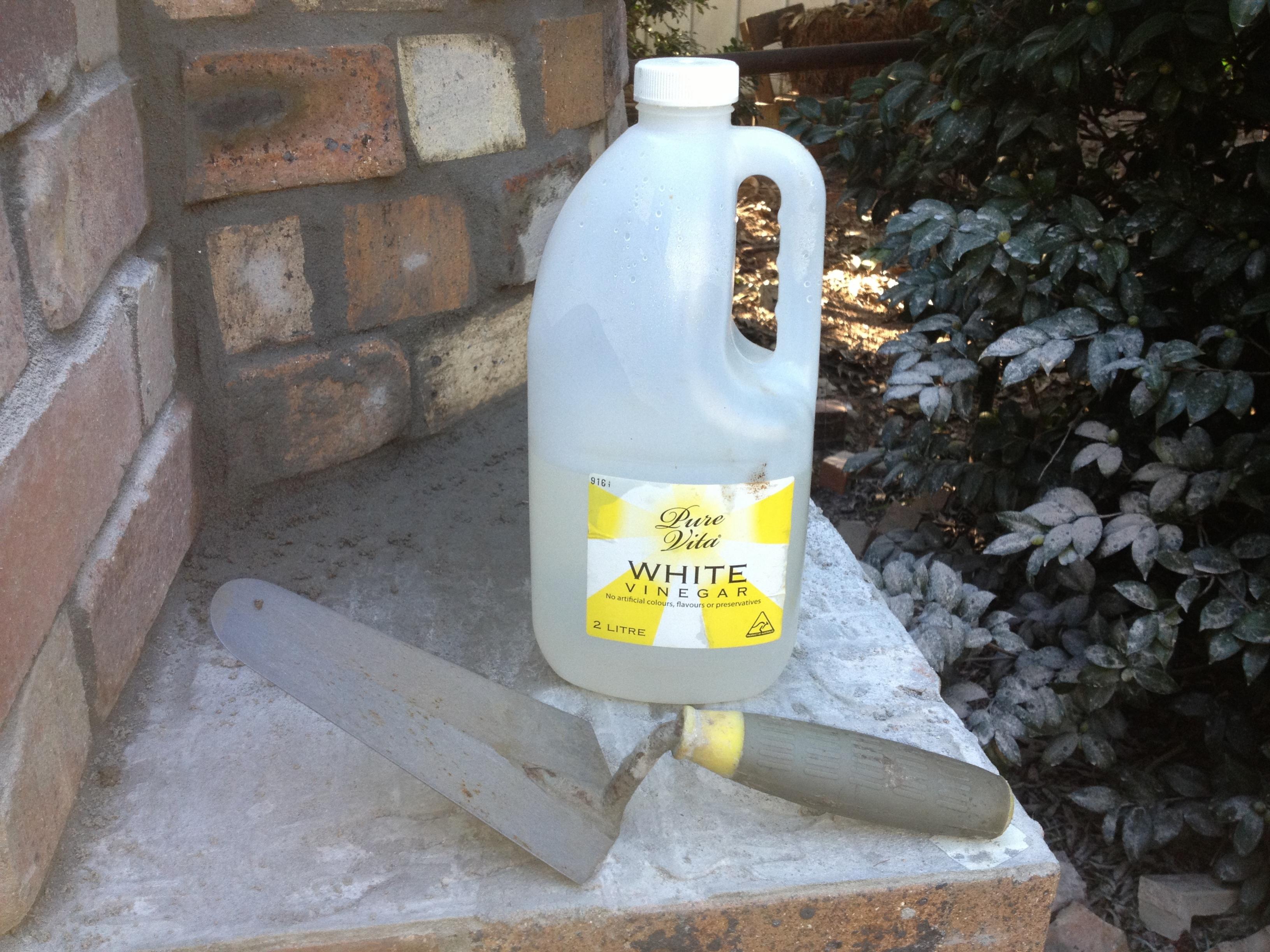

Look what I have:Originally posted by cobblerdave View PostGudday Bruce
[ATTACH]35324[/ATTACH]
The trowel pictured is easy to use due to the round end( brickie by this stage is not impressed as its use is for plastering )1 Photo

Gudday Bruce
Mixing small batches .....get one of those cheap paint mixers the one designed to mix 20 lt cans. Just put it on your electric drill . Full a bucket of water and use a dipper so you have better control over how much water goes in, never be tempted to use the hose!
The vinegar is to take the sting out of your hands after you can't help yourself and play with the mortar. No it will not heal them the damage is done
Regards Dave1 Photo
