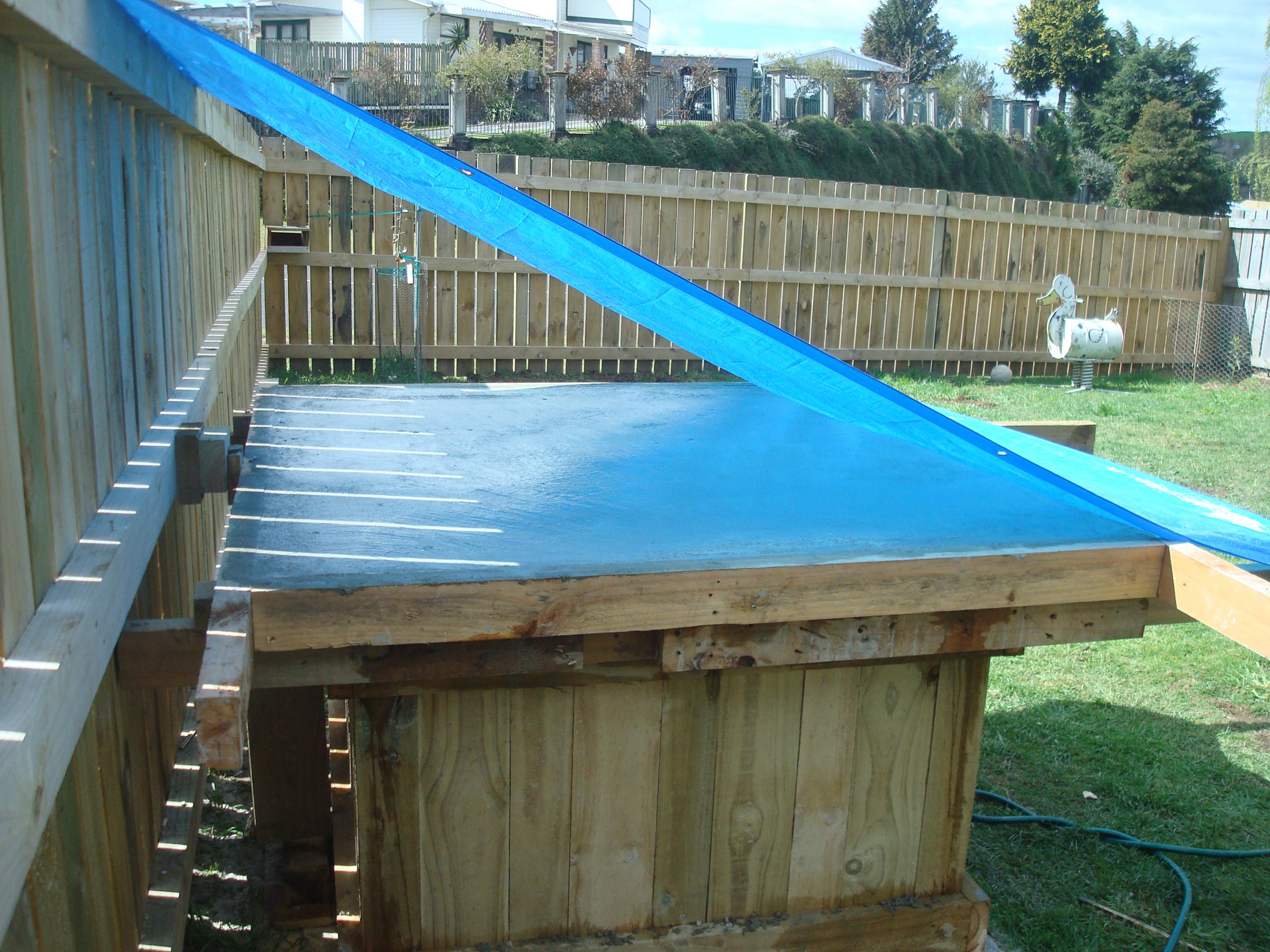

    All my bricks are rain wet but only the bottom ground layer will be saturated.
    I got the concrete slab done while I was losing my mind over stupid bricks!
    Should I give it a mist with the hose every now and again or just let it do its thing?
    Cheers,
    Bevan

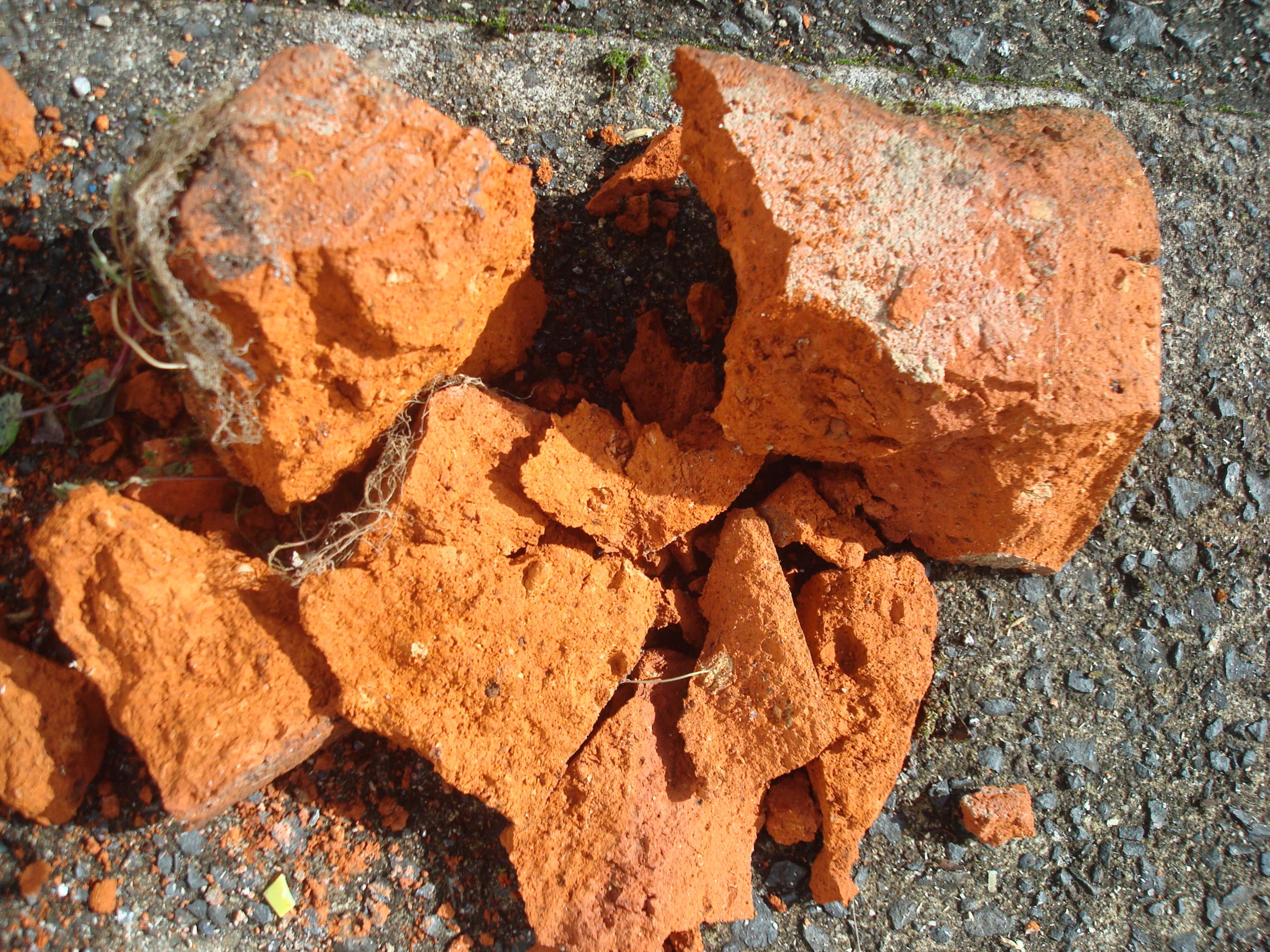

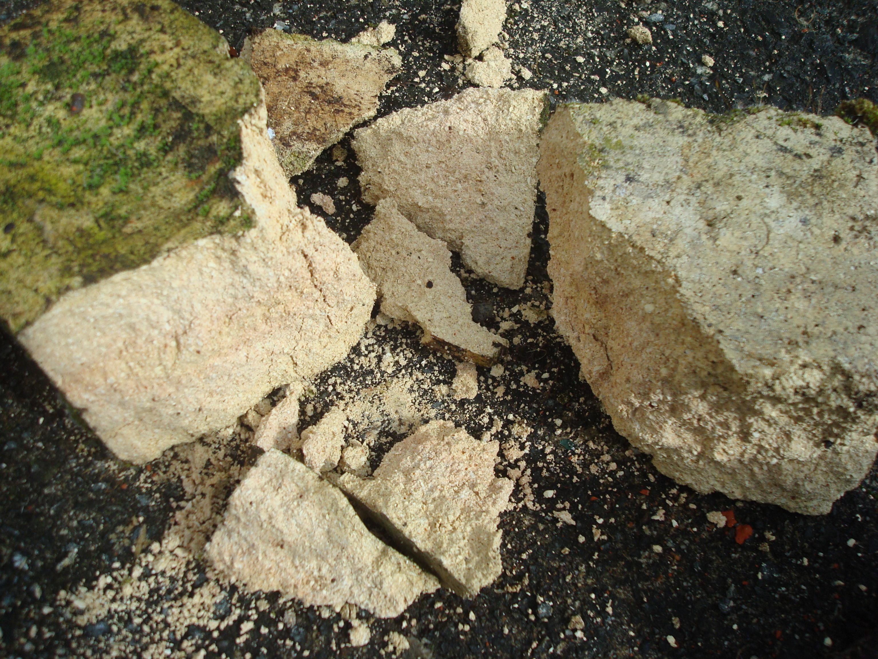

    Ok, so I would like to submit a comparison of the cream solid pressed bricks I could keep an eye out for if you guys really feel they will be significantly better and more suitable for the oven.
    First off the second red brick that crumbled badly:
    Here are the two options side by side:
    Close up of the cream brick interior after 12lb sledge:
    The red bricks weigh 7lbs (3.2kg)
    The cream bricks weigh 8lbs 6oz (3.8kg)
    So I can save up and get the cream bricks for about $1 each if you think it's the best road to take...
    Cheers,
    Bevan
    Leave a comment:

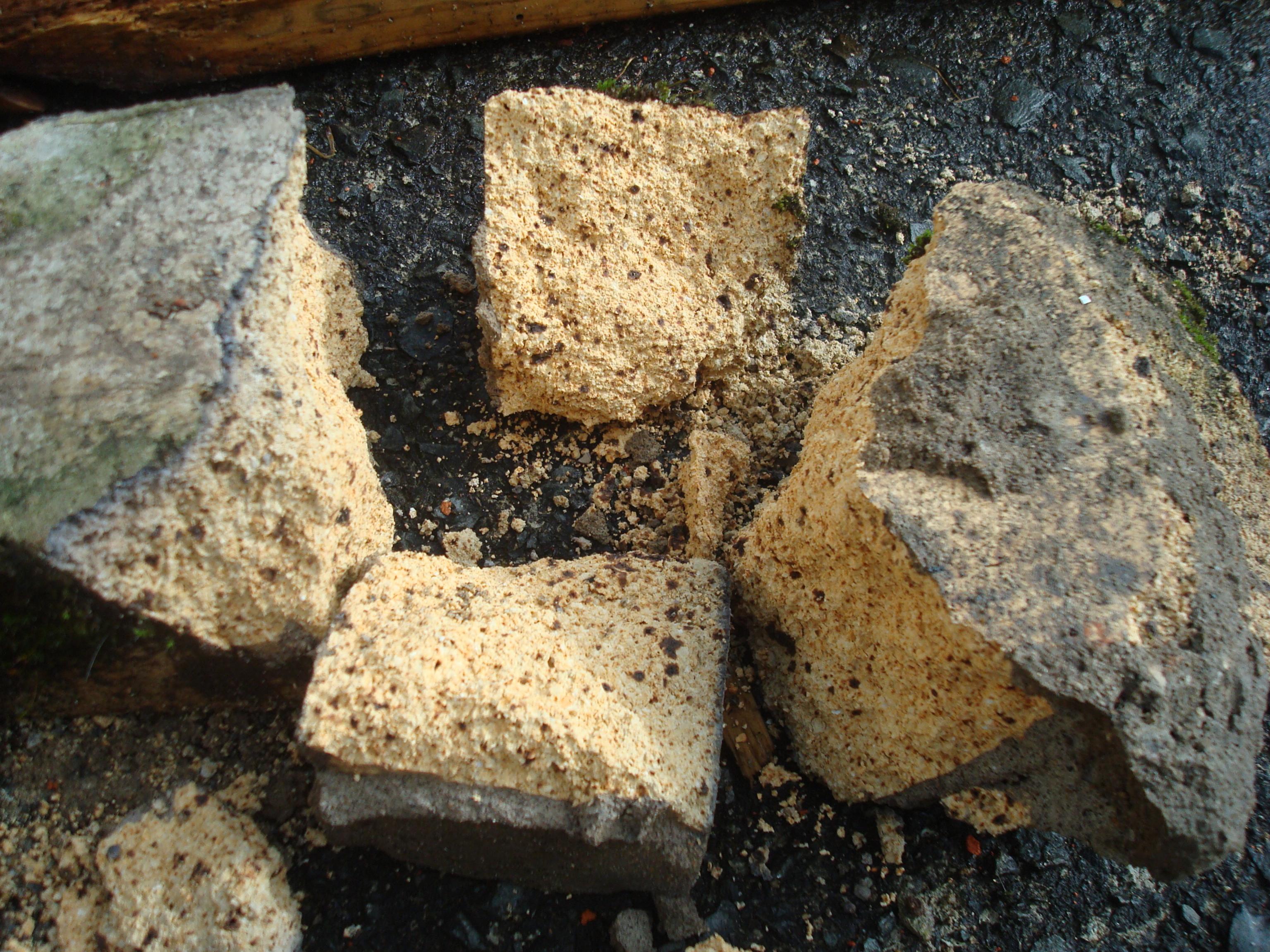

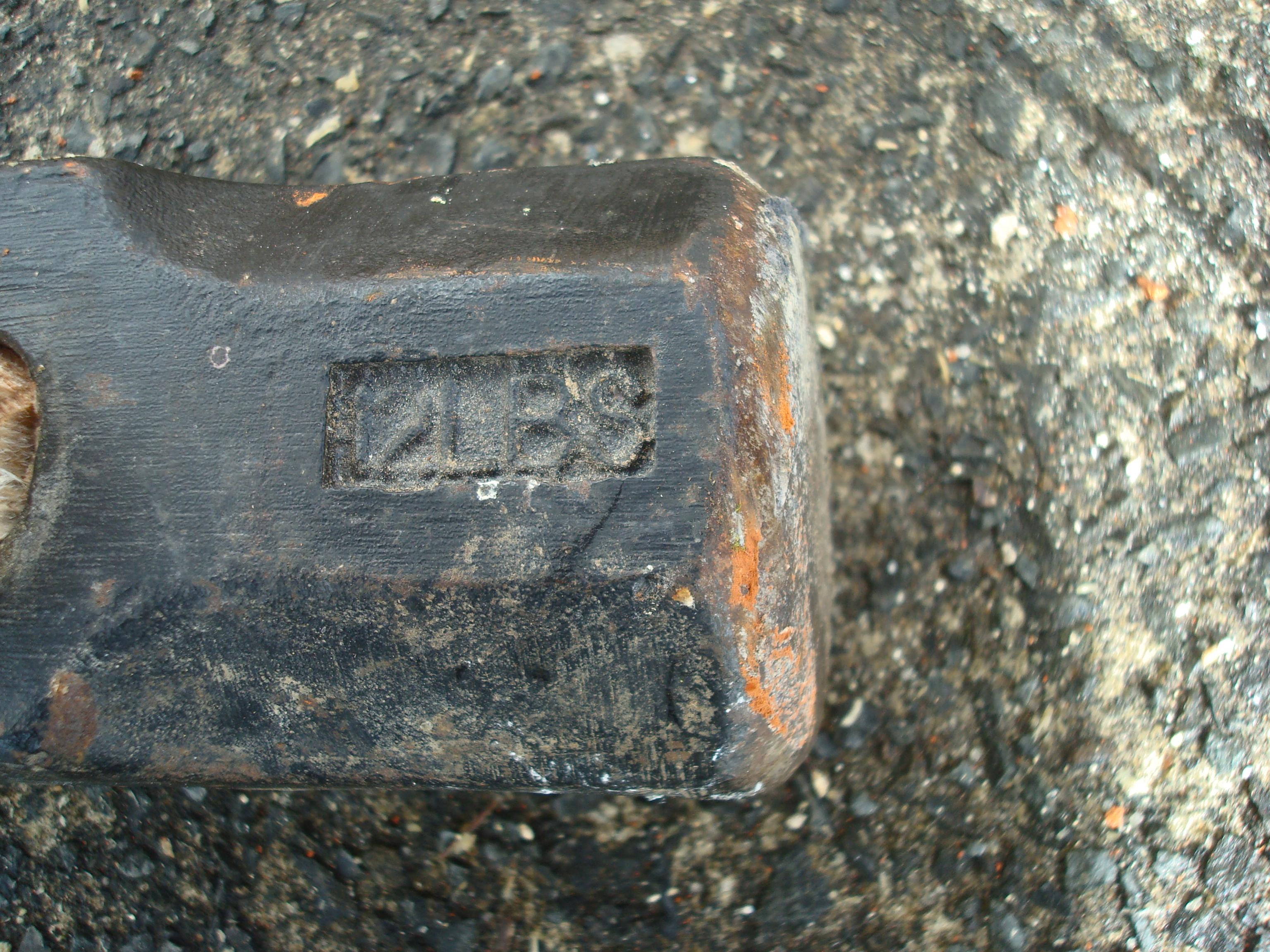

    I think it was DavidS that said hitting a brick with a hammer is pointless and proves nothing. I would like to confirm his hypothesis with my experiment detailed below.
    12lb sledge hammer head dropped from waist height onto various bricks.:
    First up is the real deal commercial refractory fire tiles:

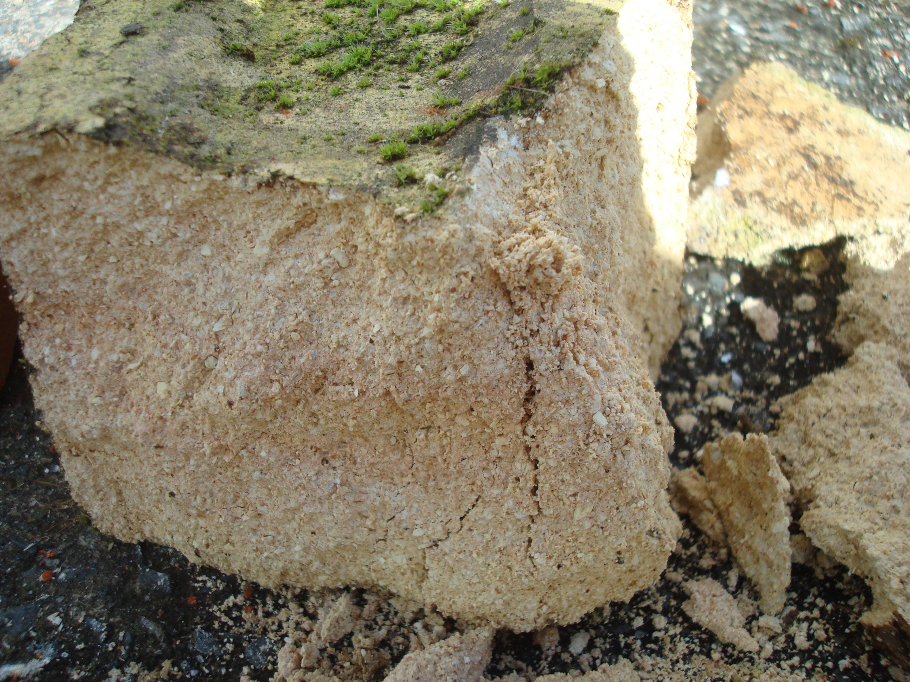

    Second is the proper marked firebricks from a firebox:

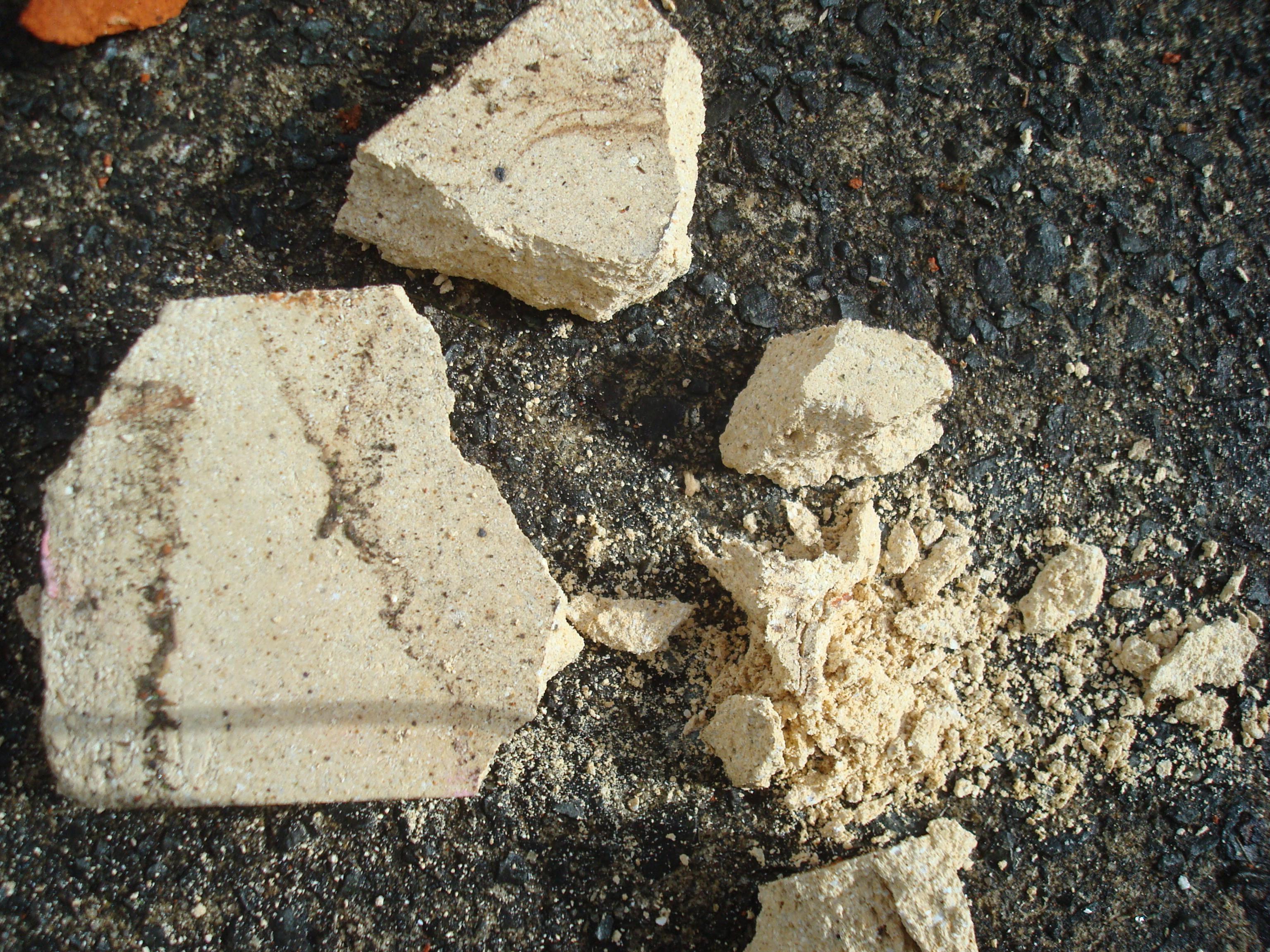

    Third is a solid cream brick from the 1950's. These are pressed and a potter I was talking to this week (not selling anything) said they have some refractory properties to the clay they were made from and he uses them as firebrick.
    And last are my crumbly orange bricks. I smashed two, one held together well (this photo) the other crumbled badly (photo next post)
