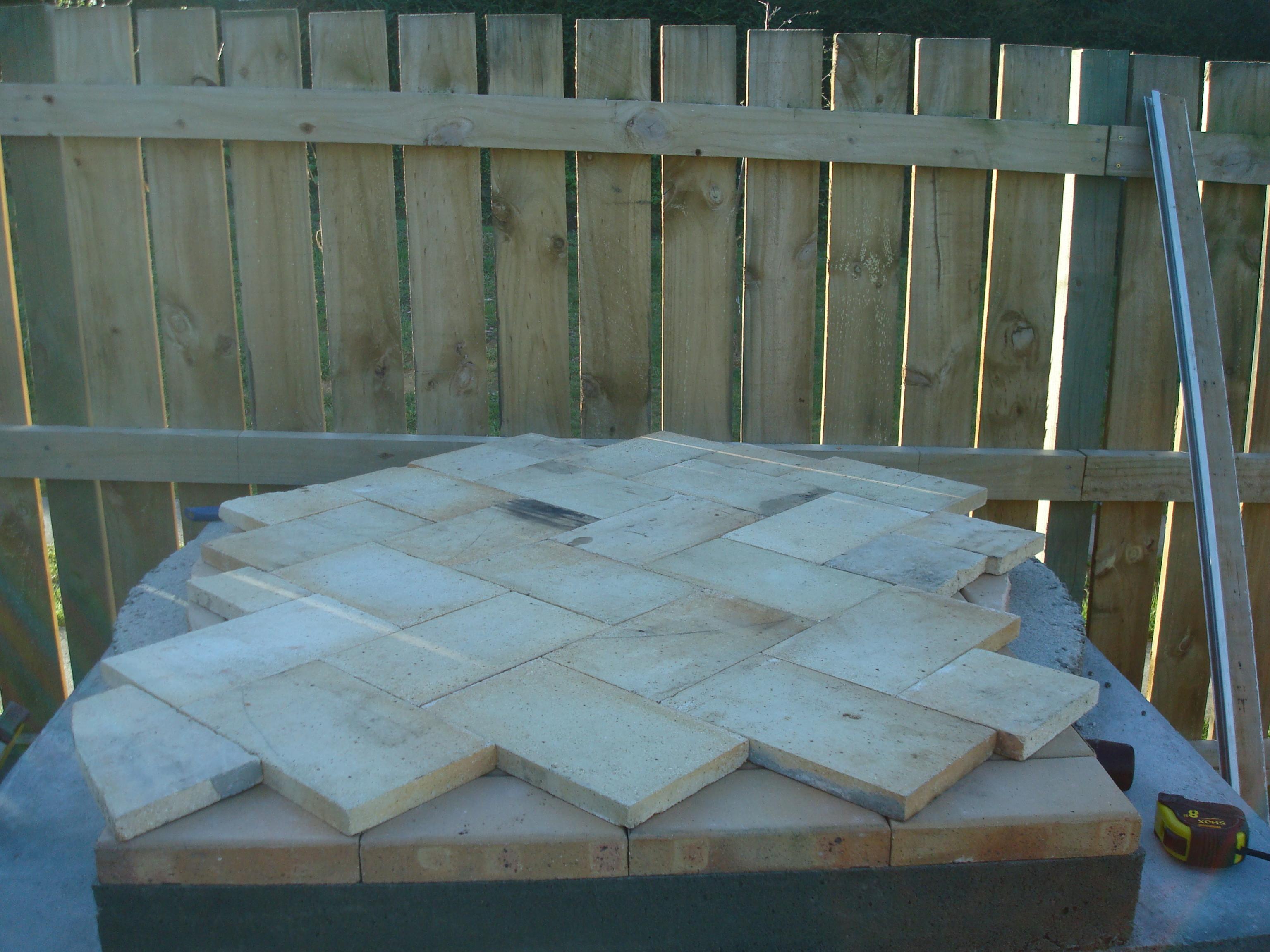

      I got the insulation layer all leveled out with sand and then layed the pavers.
      Then I put the fire tiles on top to try and work out which pattern to go for and also if I should put the dome on the pavers or the fire tiles.
      I think I should probably use sand/fire clay to set the fire tiles onto the pavers.
      Cheers
      Bevan

        Re: Budget Build 36"
        Cheers
        Bevan
        I used clay pavers underneath my fire tiles too, my tiles are 40mm thick.
        The only problem I have is that a few of the fire tiles have cracked because I chuck huge logs into the oven.
        They will still perform the same, next time I would use thicker tiles.
        My Build.
        Books.

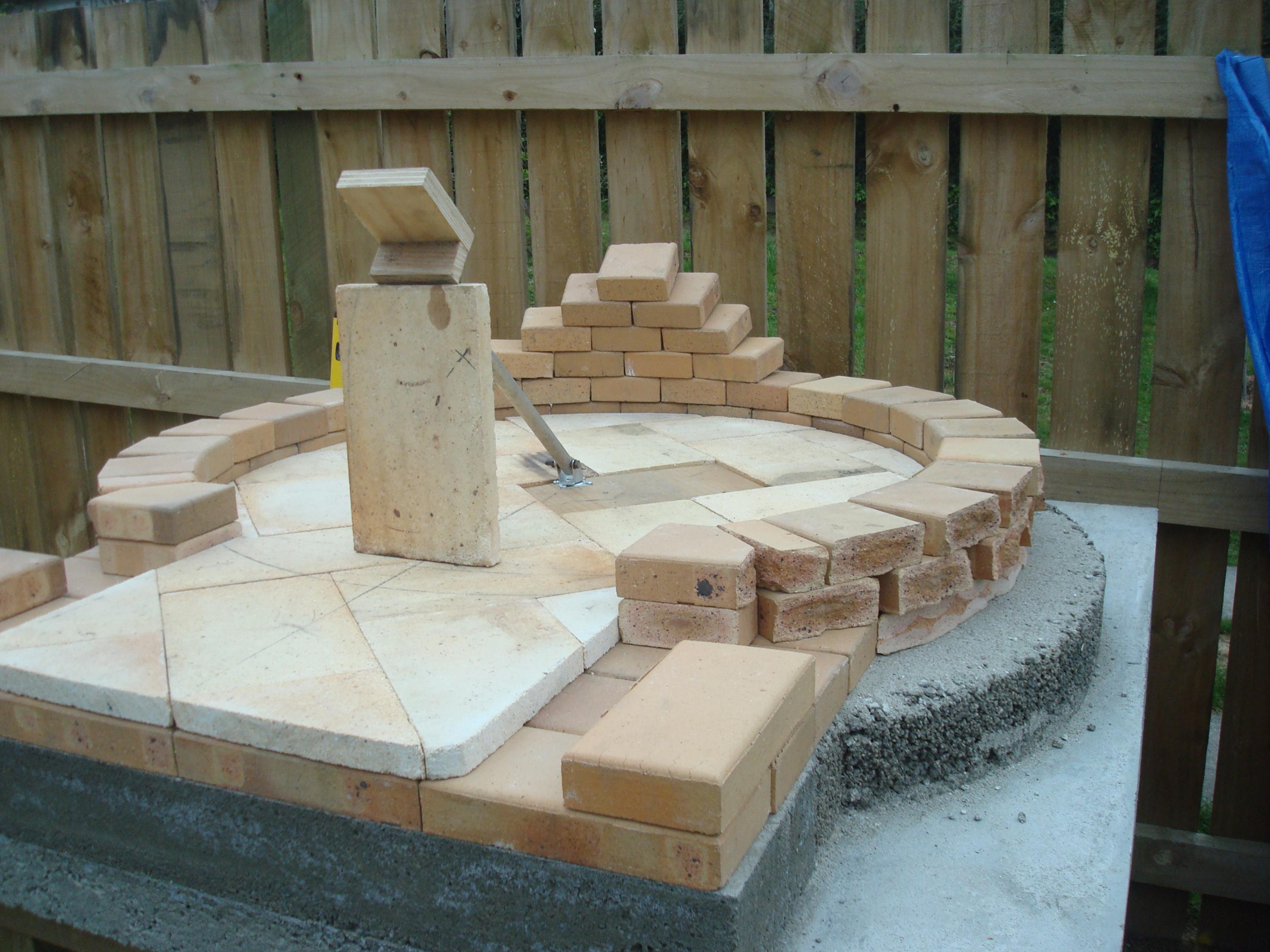

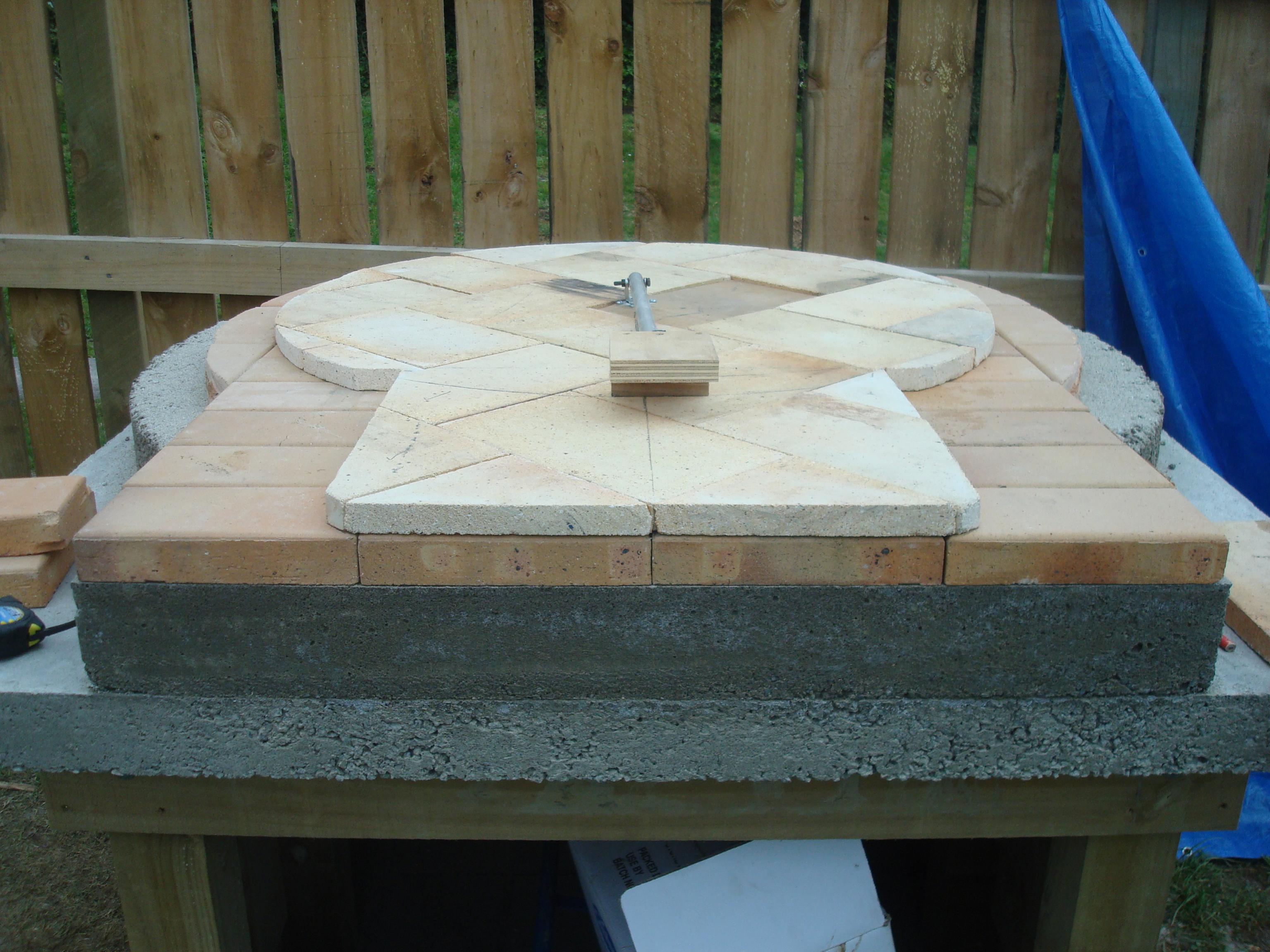

          Managed to get the floor tiles cut to sit within the dome. I did make a mistake on the landing and cut the sides in line with the inner arch instead of further out in line with the outer arch. Nevermind, It will give it some character not being perfect!
          Also split some pavers and had a bit of a mock up.
          Also whipped up an IT to make life as easy as possible.
          Hopefully tomorrow I can get to mixing up some homebrew and get going.
          Bevan

            Gudday Bevan
            It appears that you have replaced a tile with a piece of wood and screwed you IT to it ?
            • Laspaz
              • Sep 2013
              • 81
              #81
              Yep that's what I have done Dave. Trying to get the pivot point of the IT closer to the floor. Hope that is ok?
              Thanks,
              Bevan
                #82
                Gudday
                If you have ever tried to replace a single paver in a driveway its bloody hard to get it in. You got to either remove a lot of pavers and relay right to an edge, or trim a mm of the sides so you'll always have a loose paver
                The adjustment that you see on most ITs is to gradually make up for the inch or two that the pivot point is above the hearth surface.
                So placing on a ply piece is a good way to go and you have the added advantage that it all protect your hearth from the inevitable drips of mortar. Cut it into section small enough to fit through the entrance and screw together with battens

                  #83
                  Thanks Dave, words of wisdom for sure. I will try and sort out the plywood.
                  My IT has no adjustment, I could drill some adjustment holes, but I am not sure that the extra 1/2" of dome height will matter too much.
                  Thanks for the tip,
                  Bevan

                            Progress is slow as the weather has been crap and still waiting on the fireclay.
                            I did win an auction yesterday for some chimney flue sections. 2x 4ft long 6" wide and 1x 4ft 8" galv and 1x 4ft 9" galv.
                            I have 240 half pavers precision cut with hammer and bolster ready to go! I assume it will go pretty quick without custom cutting every piece.
                            Also converted the IT base to a full plywood 30" circle as outlined by Dave.
                            Ready to get into it!
                            Cheers,
                            Bevan

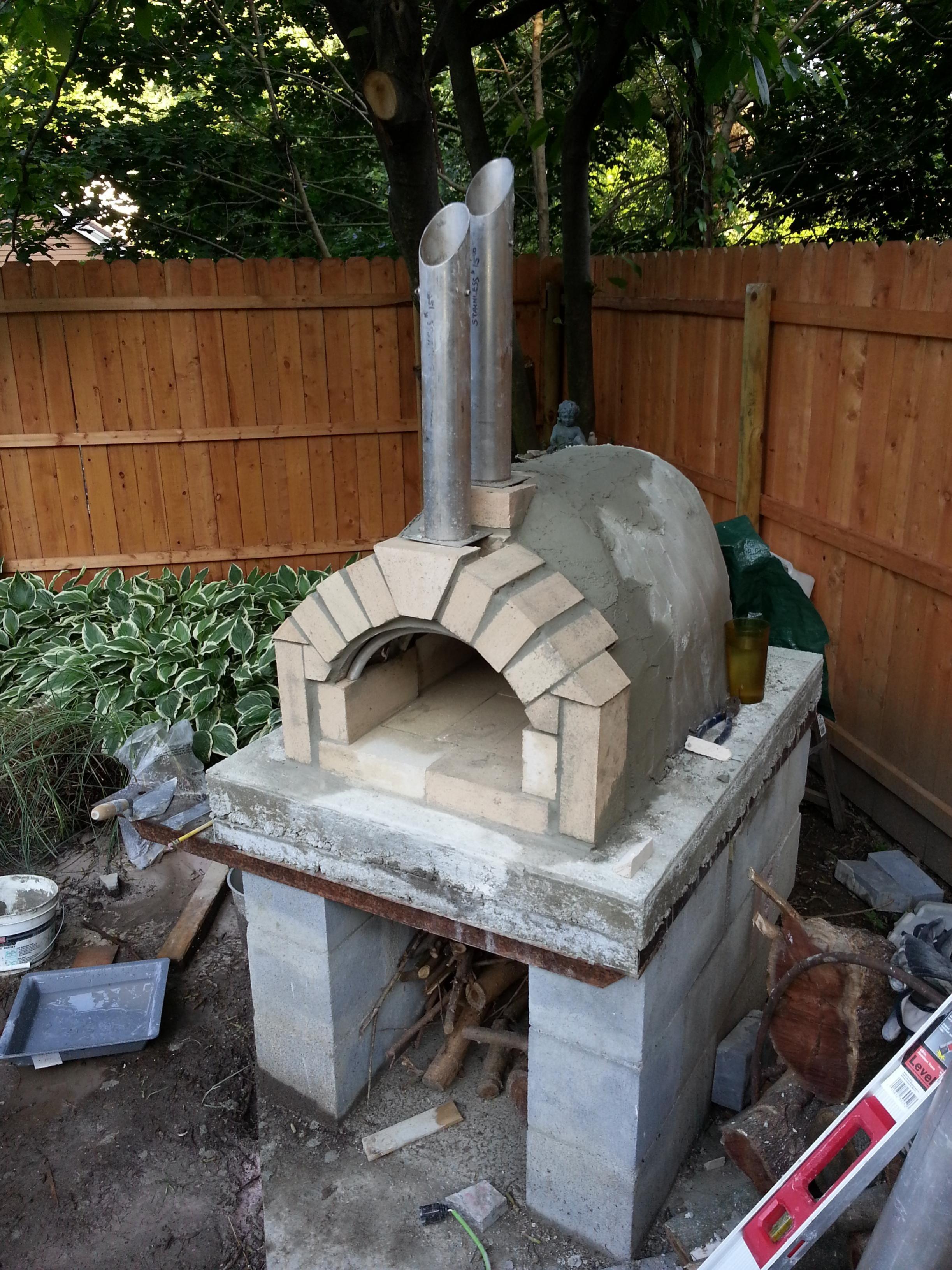

                                #90
                                Gudday
