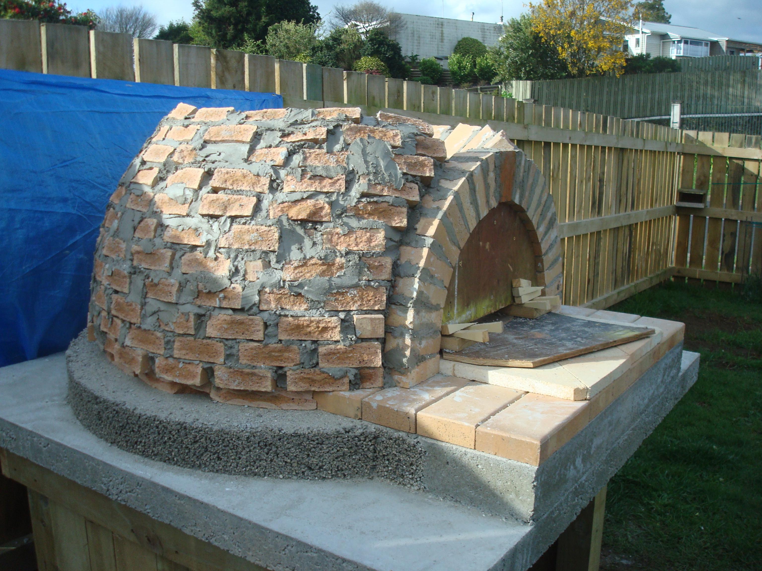

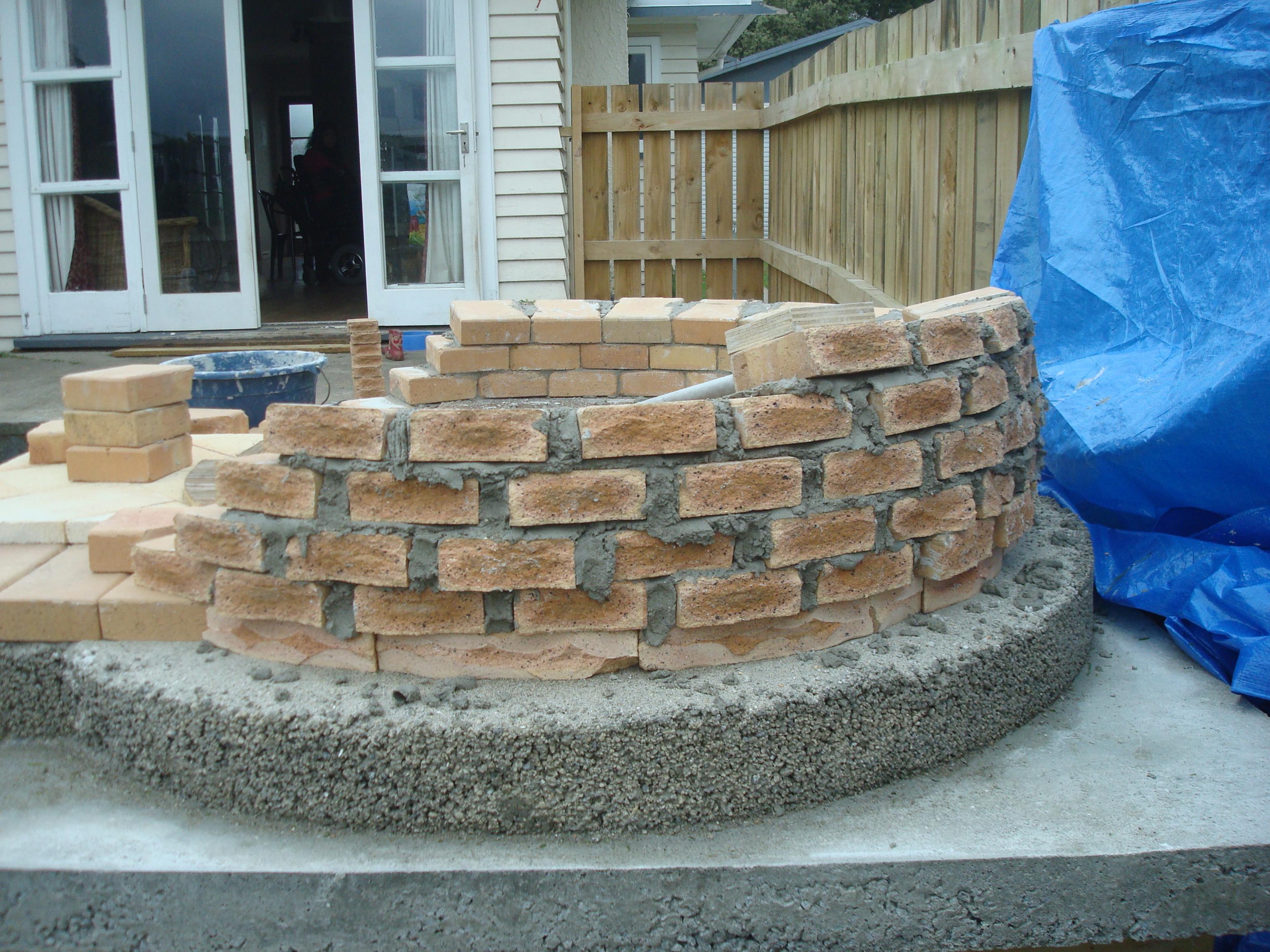

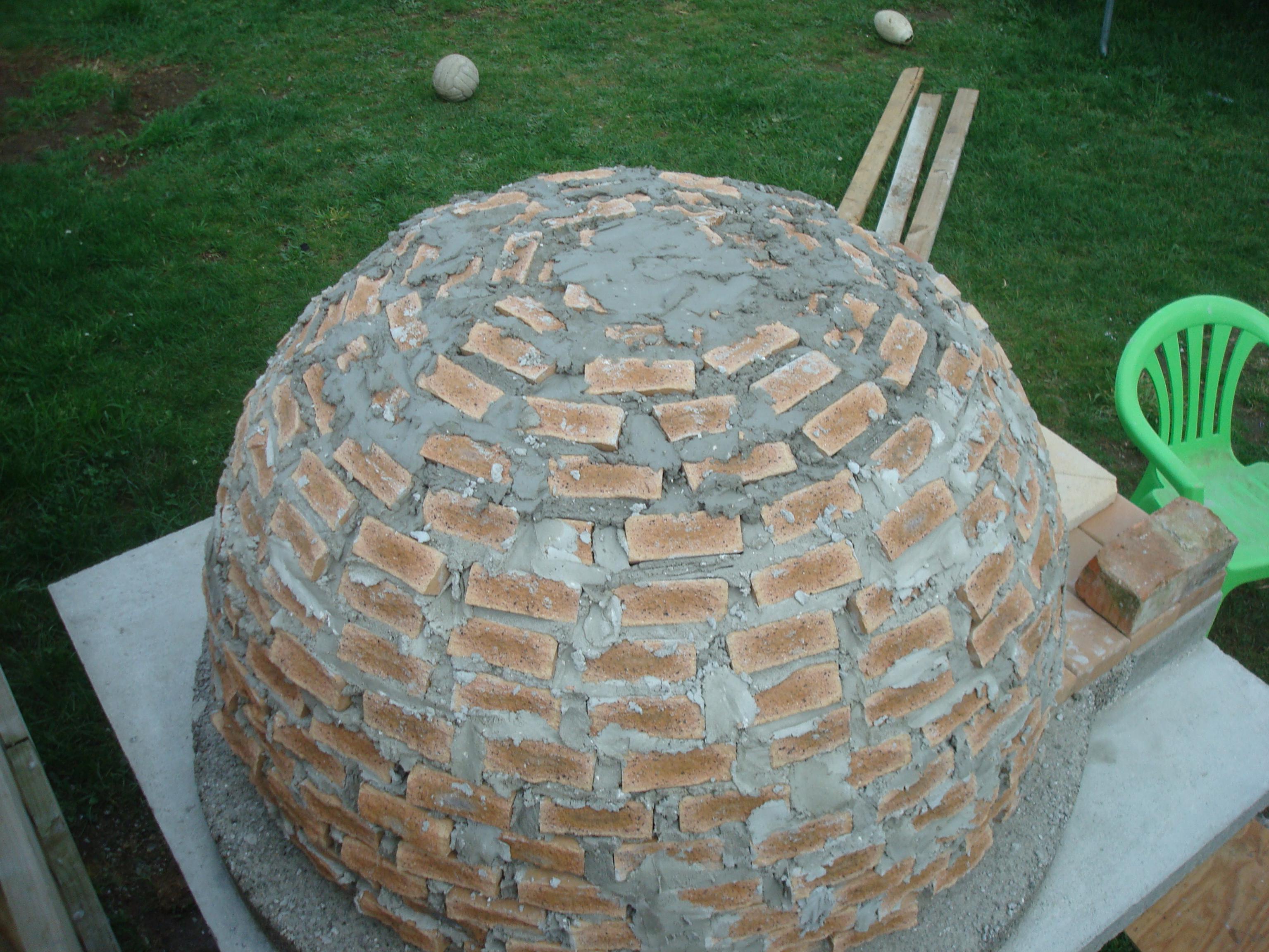

      This is where my build takes a different path from most of you guys.
      I have begun building the dome, but not using any cuts. And because I am using pavers with a rounded top edge the mortar joints look bigger than I hoped.
      I also decided to make some changes based on info I have found on the fourm, such as more sand in my poor man's mortar and not wetting the bricks.
      I would like to shorten my IT at some point soon to start bringing the dome closer in. This is because the pivot point of the tool is higher and if I don't bring it in I will end up with a 19" high dome. Better to do it a couple of times to make the transition smoother and earlier right?
      If these are mistakes please let me know!

        #108
        Re: Budget Build 36"
        Are your pavers concrete? If so I see a problem.
        Sorry, did not see conversation on clay in prior posts....
          Nope, clay pavers fired to 1200c. They should be fine. There was a run down on them and the other options a few pages back.
          Bevan

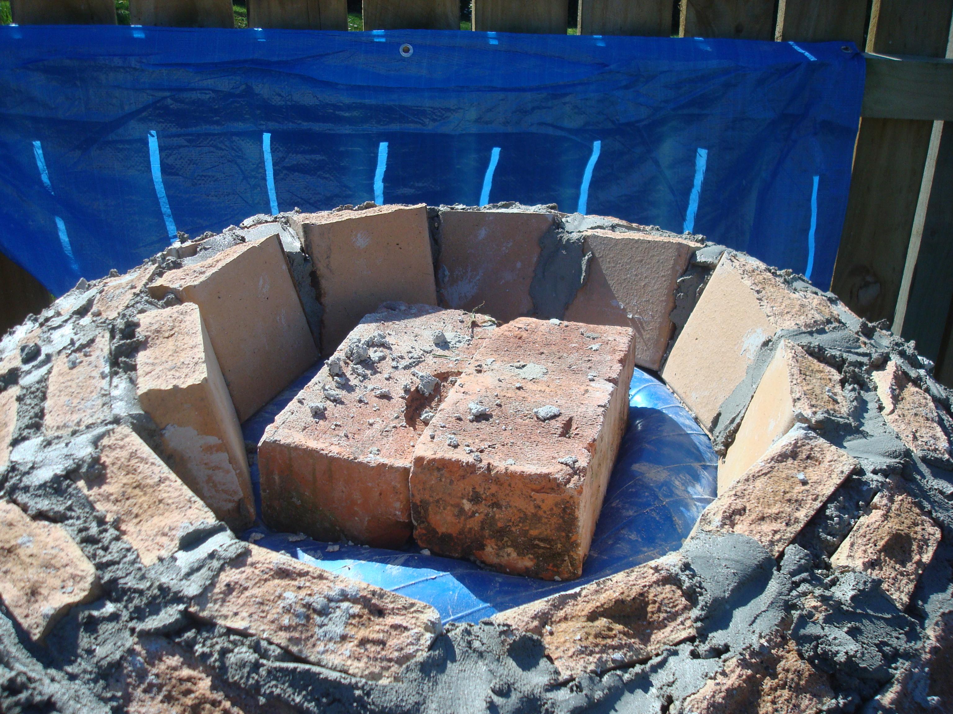

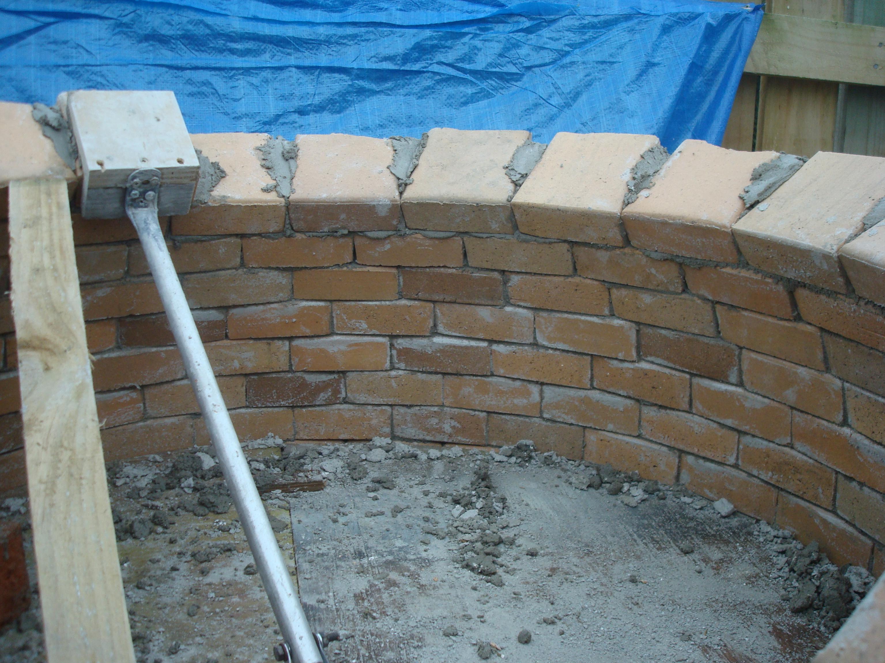

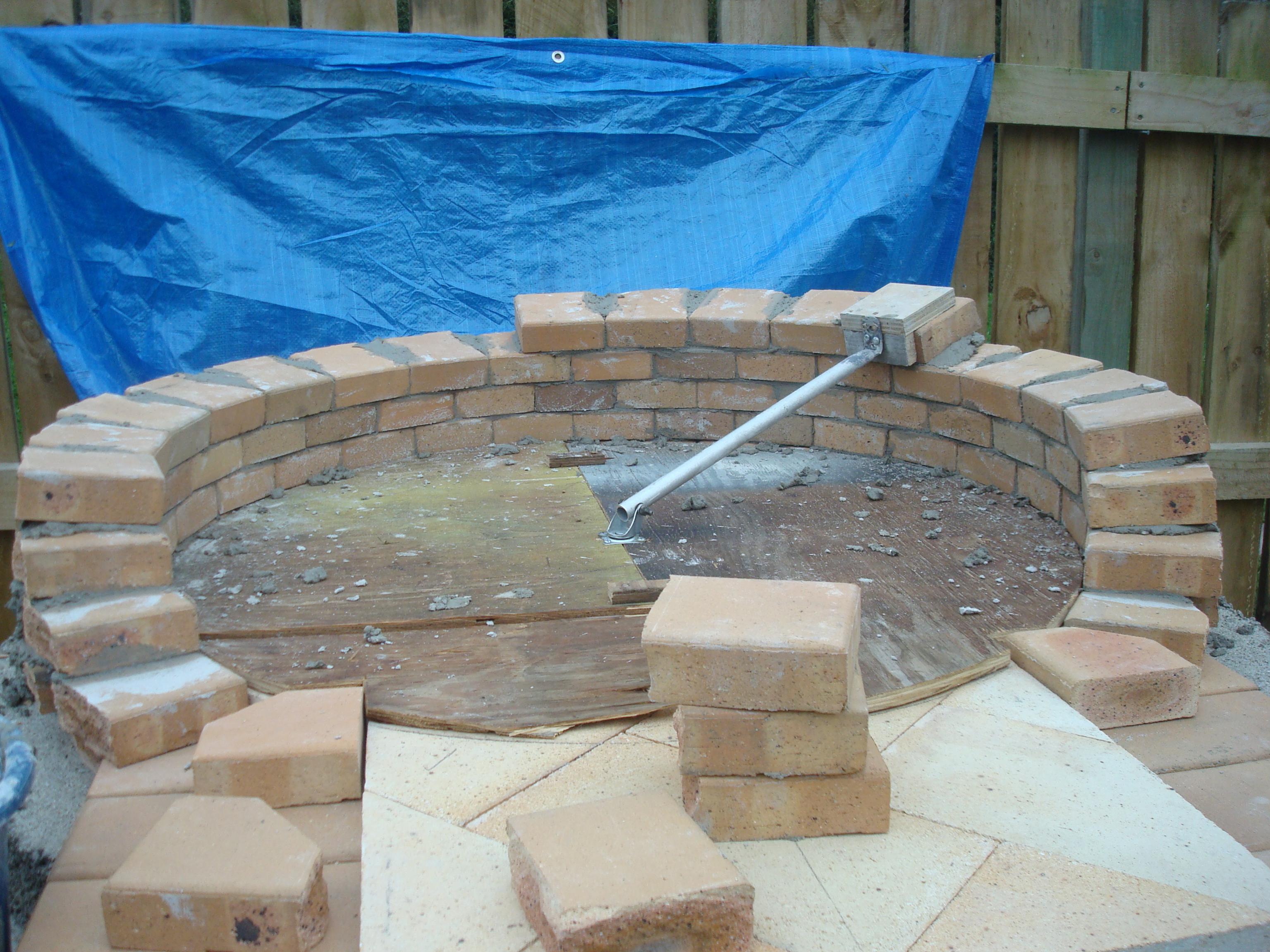

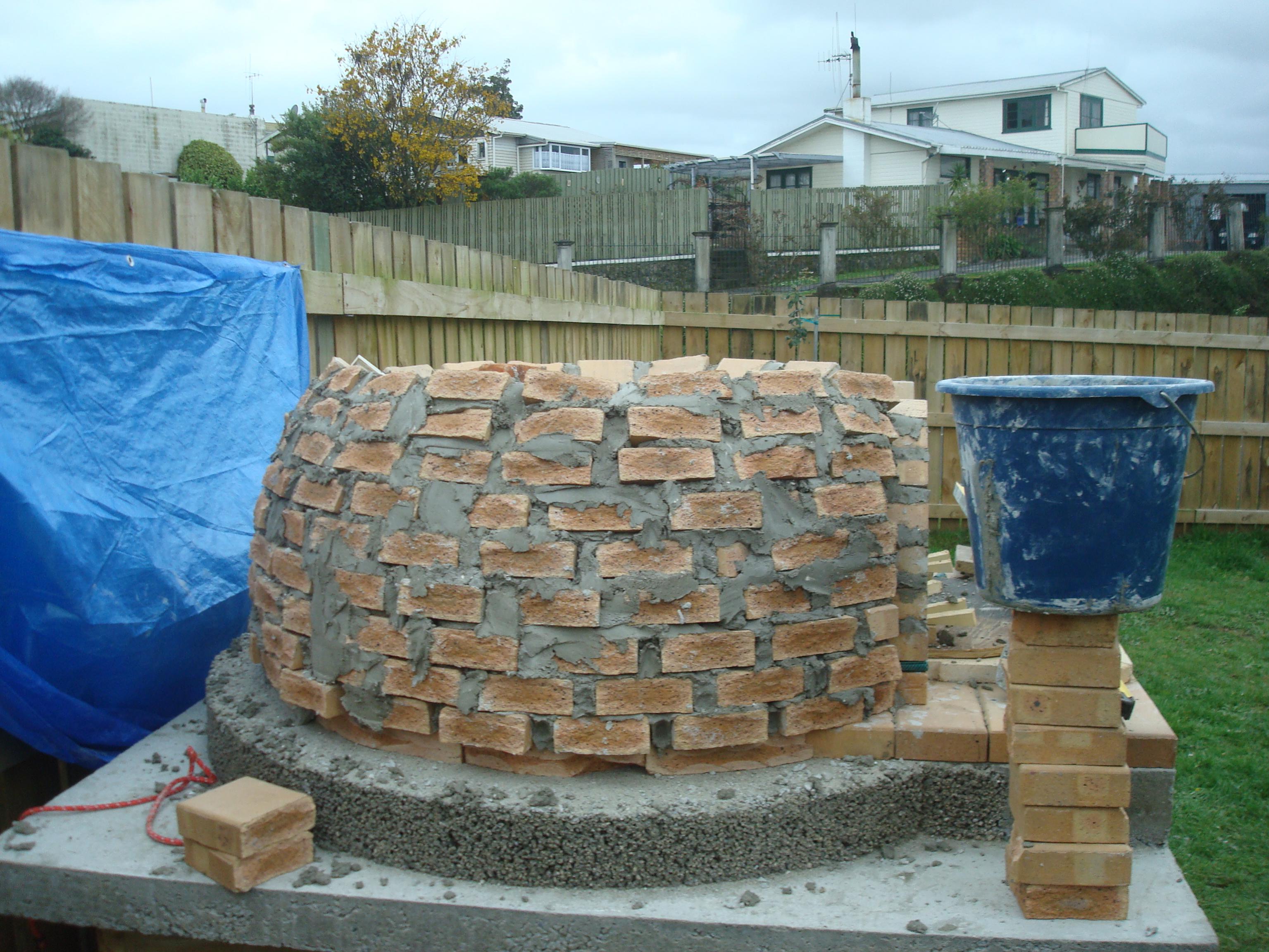

            I am scared to post photos of my recent progress. I'm just after an oven to cook some pizza's well, so it's not pretty!
            Gravity is starting to be a real PITA with keeping the bricks in place, so I think it is time to retire the IT and seek out a swiss exercise ball to finish the dome off.
            When am I able to remove the arch form? Should be fine tomorrow right?
            Cheers,
            Bevan
              #111
              Gudday Bevan
              It's looking pretty good from the photos. Leave the arch form for a week if possible . You ripping ahead compared to most builds so a little wait is alright.
              One thing you might try on the oven entrance is to clear the mortar off with a bucket of water and sponge. You'll find it impossible to remove when dry.
              Again great progress

                #112
                You may like to try this approach some cheap cramps and wood/leftover brick cramp the wood to the brick you are trying to lay

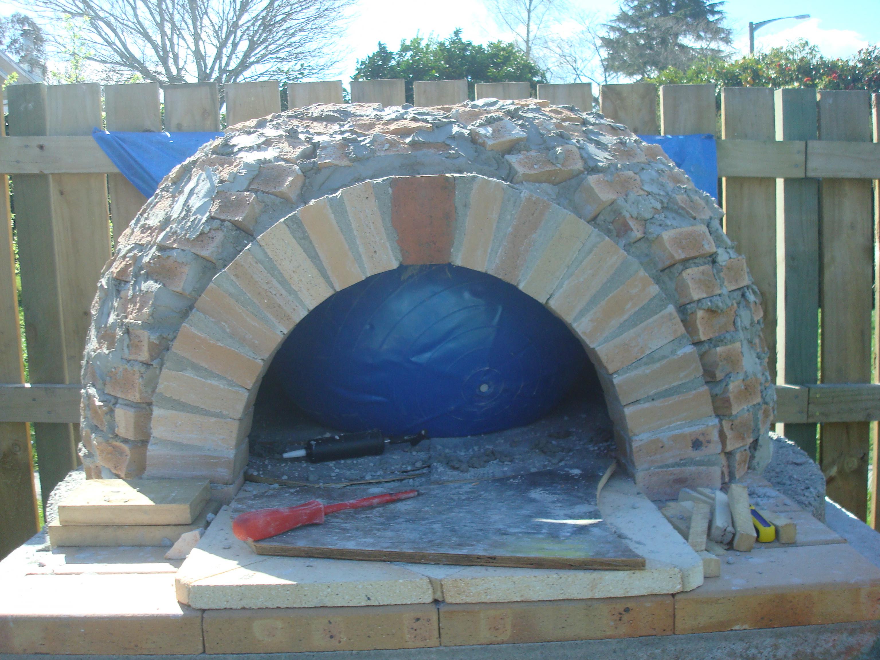

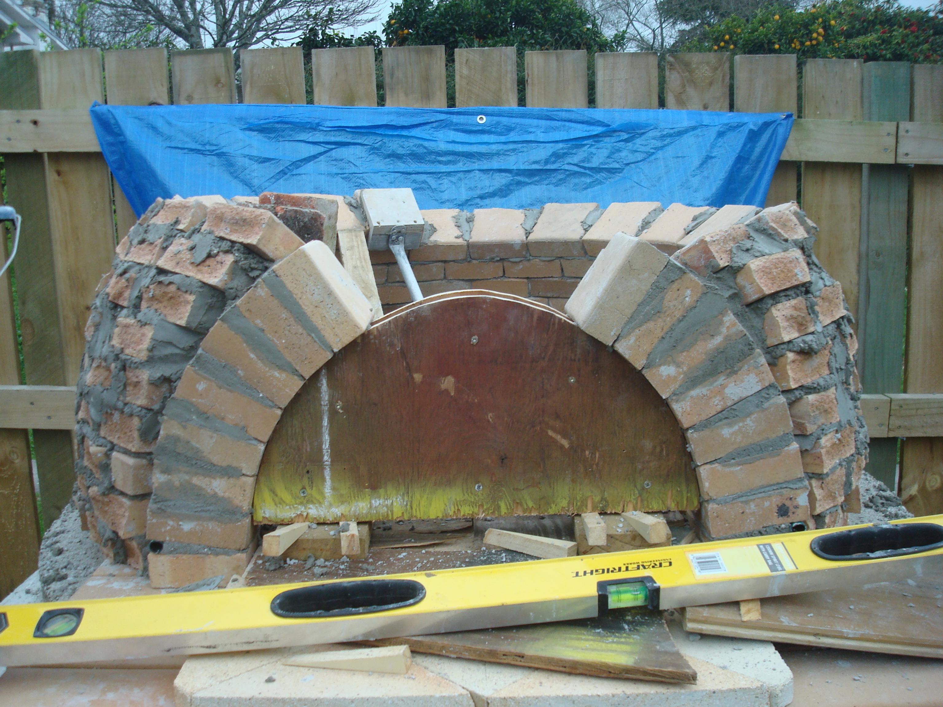

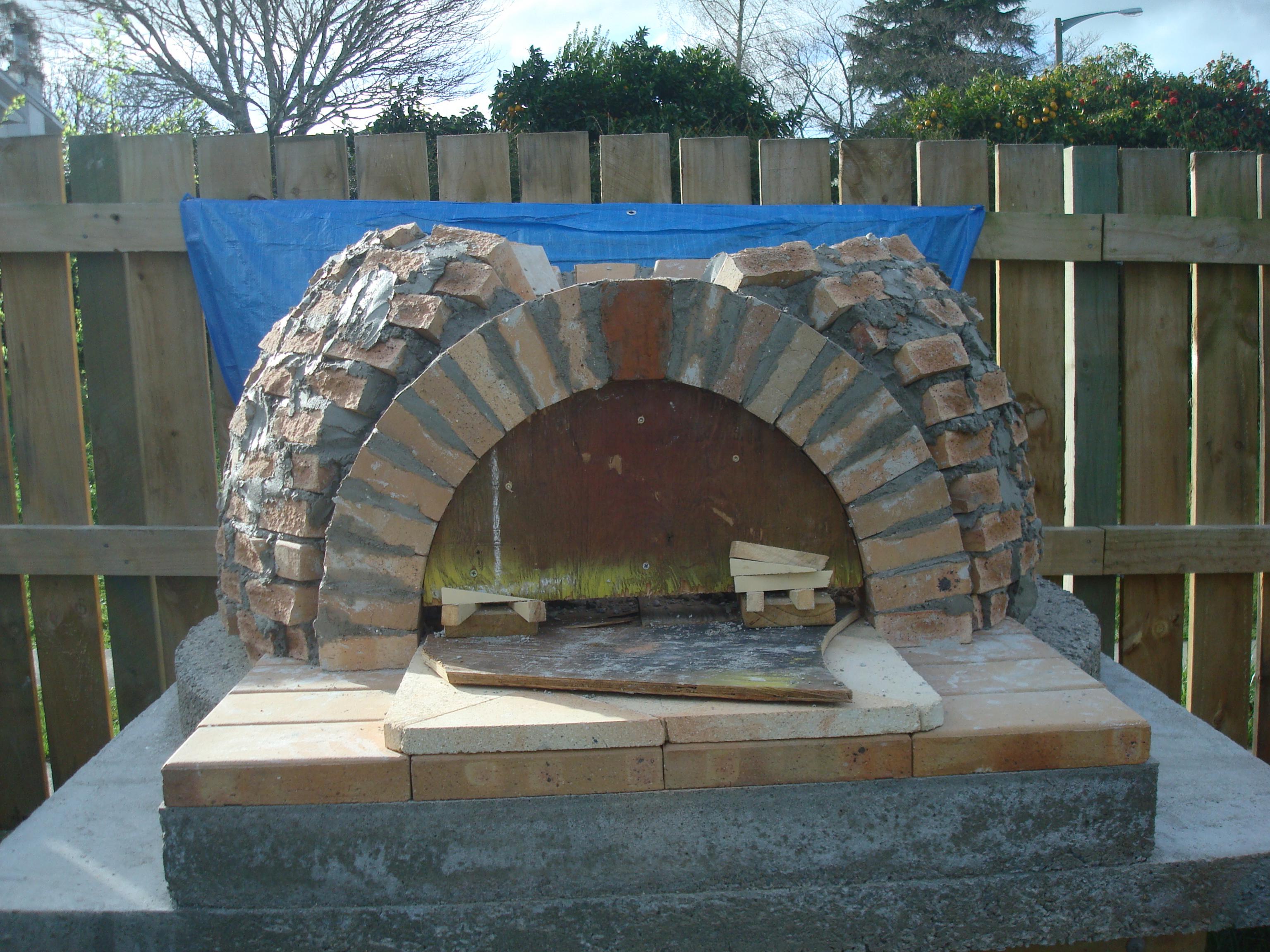

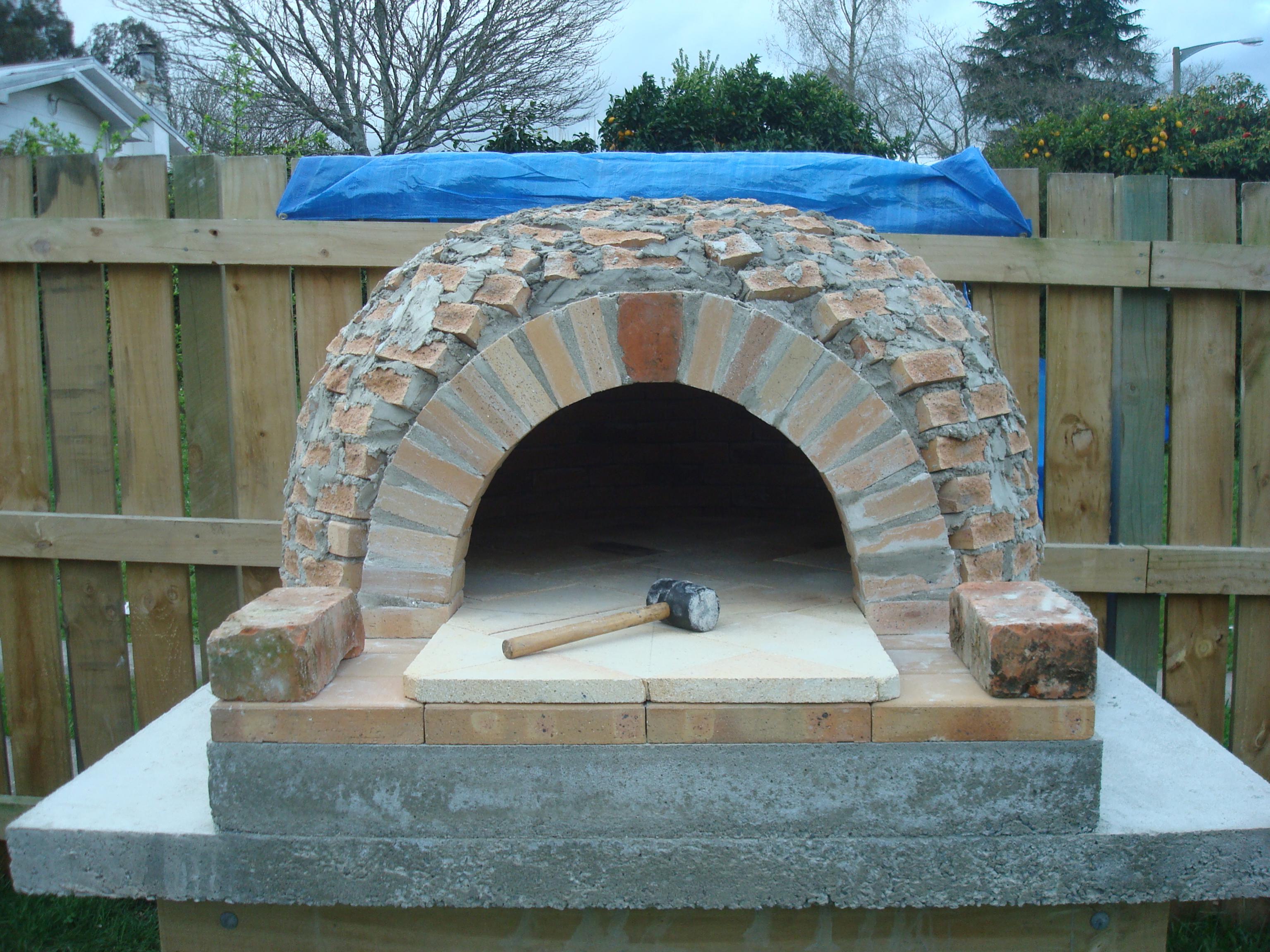

                              #119

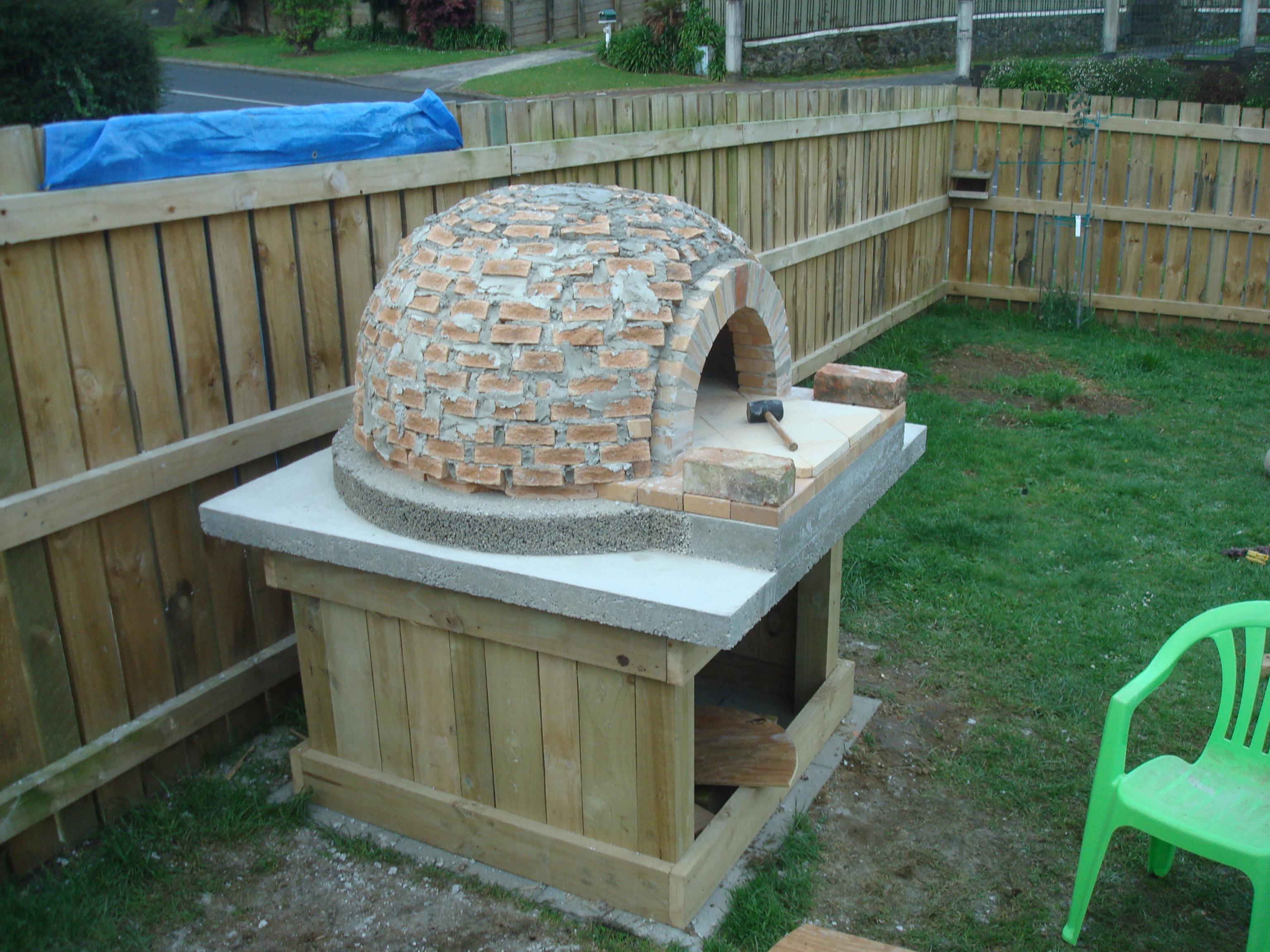

                              Hey Gang,
                              I decided to remove the form quickly and get the exercise ball in place, and the n put the form back in place. The arch held, fingers crossed that I haven't made it weaker by messing with it.

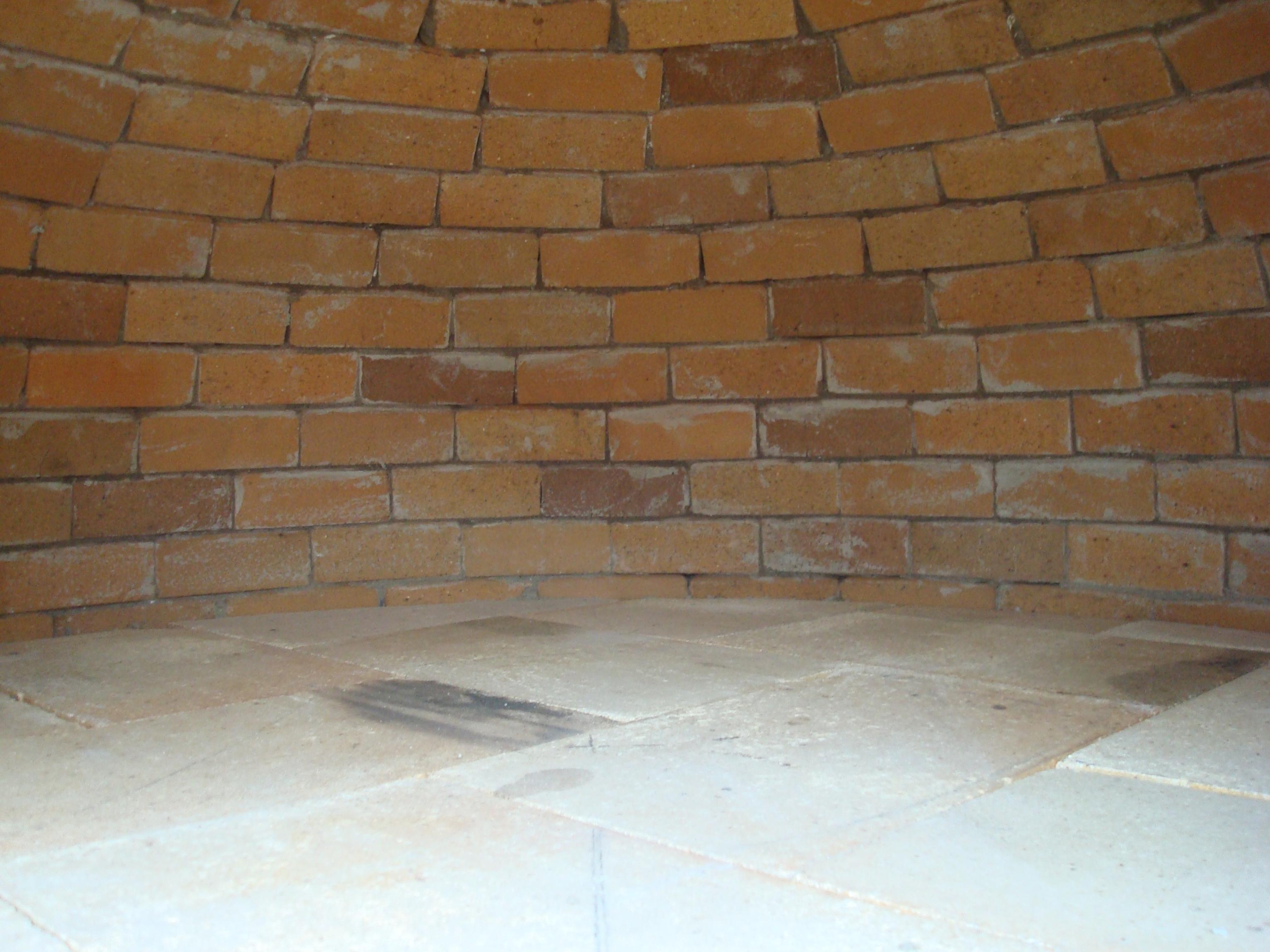

                              I had quite a bit of trouble with the ball and wouldn't use it next time. The ball needed to be at low pressure to have the shape I wanted. This made it really difficult to keep the bricks at a nice even level (and prevented me from being able to see)
                              I tried to use full bricks to weigh down the center of the ball making the pressure around the edge where the bricks were being placed higher.
                              The result was the top inside of the dome being quite uneven and quite disappointing. I guess that is another benefit of a cut brick vs. a uneven bolster cut one, you can know the inside profile based on the outside somewhat. I don't think this should limit the operation of the oven.
                              Either way, 266 half pavers later the dome is closed. I ended up with a 17" internal height and I am quite happy about that. I tried to make sure the dome had a more flat final few courses.
                              I did have to hammer in the keystone (stones) pretty firmly so I felt reasonably calm about removing the exercise ball right away. Hopefully she holds
                              Now I supposed to leave it to dry out for a week before starting curing fires right? Can I build the vent and outer arch while I am waiting?
                              Cheers,
                              Bevan
                              • brickie in oz
                                • Mar 2009
                                • 3445
                                #120
                                You sure can.
                                Exceedingly quick build..
