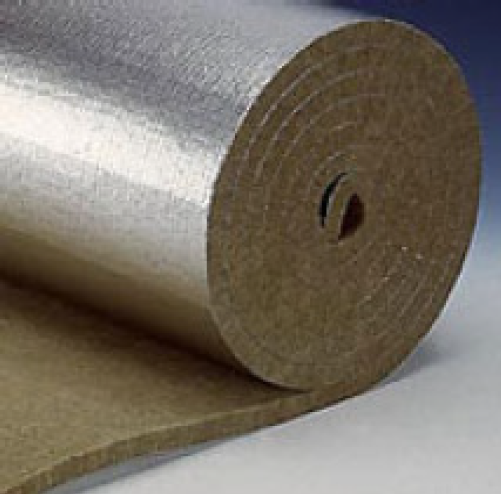

    What about this thing: http://www.szigetelesaruhaz.hu/pic/t...t-paplanok.png
    It has a layer of aluminum foil, is that a good or bad idea to use? Some say bad because it would trap moisture inside, but when it (the oven) reaches +100c it (the moisture) will find its way out, won't it?
    Would regular fibreglass from the 1960's do if it's placed directly on the dome? Or will it melt?

    Is that insulation rated to take the required temperature? I've found foil tends to trap moisture. The steam condenses on the cooler foil and then runs down to the base leaving water at the bottom of your dome. If the foil is perforated it is slightly better but steam will still condense against it.

      Oh yes condensation running down the sides must be avoided as I'm in the north and will be cooking during winter, I hope.

          Proper insulation makes any oven efficient. Pizza can be best operated at temperature higher than 750 F and exterior temperature should be cooler. There is problem of moisture with aluminum foil.
