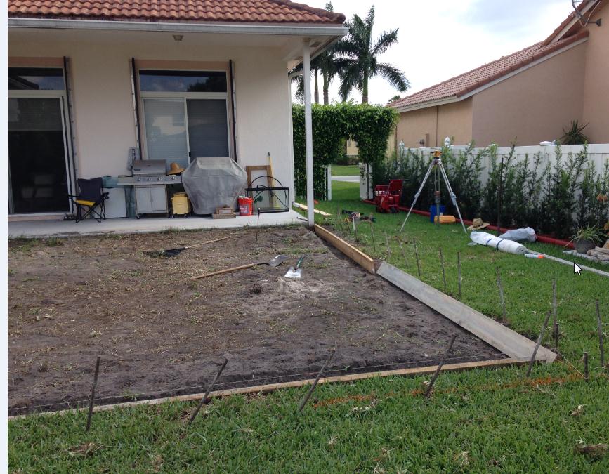

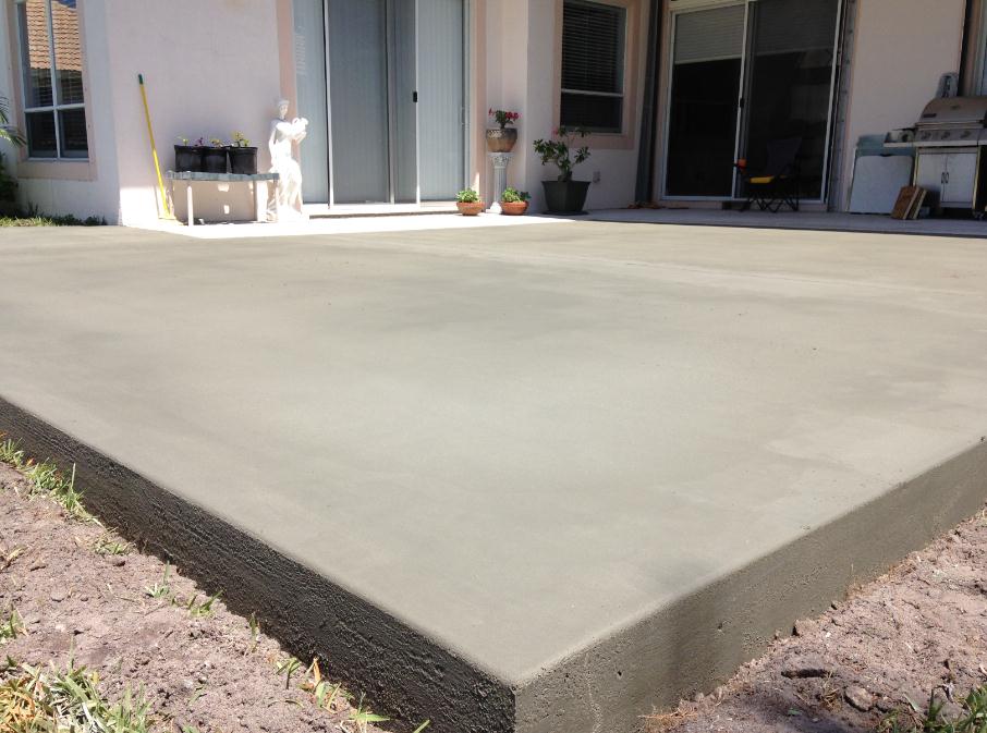

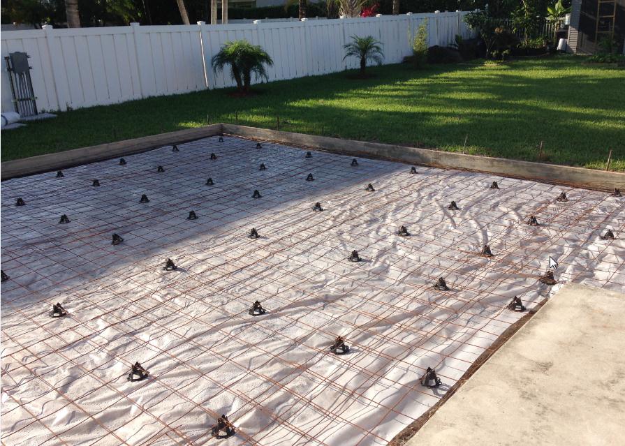

    Will this support the weight of the oven?
    I live in south FLorida, mosquito is my biggest enemy. Therefore I decided to put in the screen room first before i built my outdoor kitchen/pizza oven. My question for all the concrete expert out there is that with a 8"X8" thicken edge with 1 #5 rebar and a 4" thick patio. If i built a corner pizza over will this be thick enough to support all the weight?

    Re: Will this support the weight of the oven?
    Trippy,
    I am no concrete expert so if an expert responds their opinion will be better than mine....
    but, in my view it depends to a certain extent how good your base is under the concrete. It's hard to see the quality of your base from the photo's.
    I only used 4" of rebar'ed concrete under part of my oven, BUT I knew that I had a rock hard, compacted gravel base underneath that.
    We get a lot of rain and I have had no problems with shifting or cracking.
    So bottom line from me - if your base under the concrete is good, I think you will be fine.
    Neil
      I live in a city call Coral Springs. After 4" of dirt for the grass..everything below that is sand and coral. I can't even dig a hole for my tree without using a pickaxe. the conctractor removed a good chunk of the dirt to level it.
        The footprint pounds per square inch of a typical oven is trivial, less than a good sofa, much less than a refrigerator. It is heavy, but it is spread out over a big footprint.
