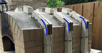

          Making some progress, my buttressing drama is now over! Thanks to Mr Chip! I have the perfect solution, which will not ad any mass to my WFO and it is not going anywhere. See images below. Thanks for this chip, I owe you one... :-)

            Looks great,
            The only thing i would have done a little differently is to round off the corners where the cable goes from the wall to the ceiling, This would distribute the load a little better and not be such a point load on the brick.,
            it looks like the stainless worked out fine, and it appears that you have done several curing fires. Has anything been cooked during the curing fires?
