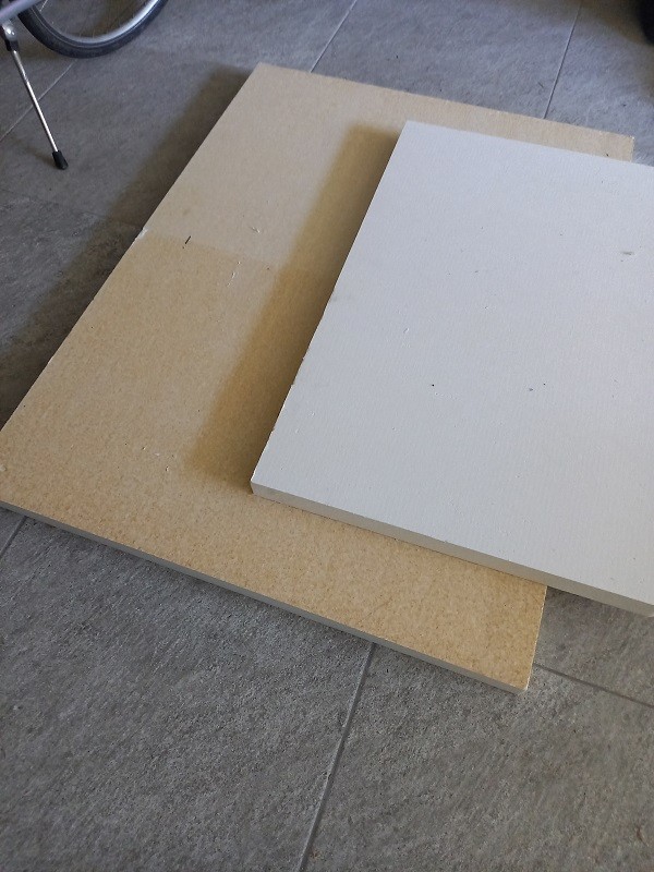

                            My FB Casa Oven came with the FB insulating board. It has 2 sides white and tan. Does it matter which way up it should be installed? It's not mentioned in the instructions or insulation packaging. Thanks.Click image for larger version
