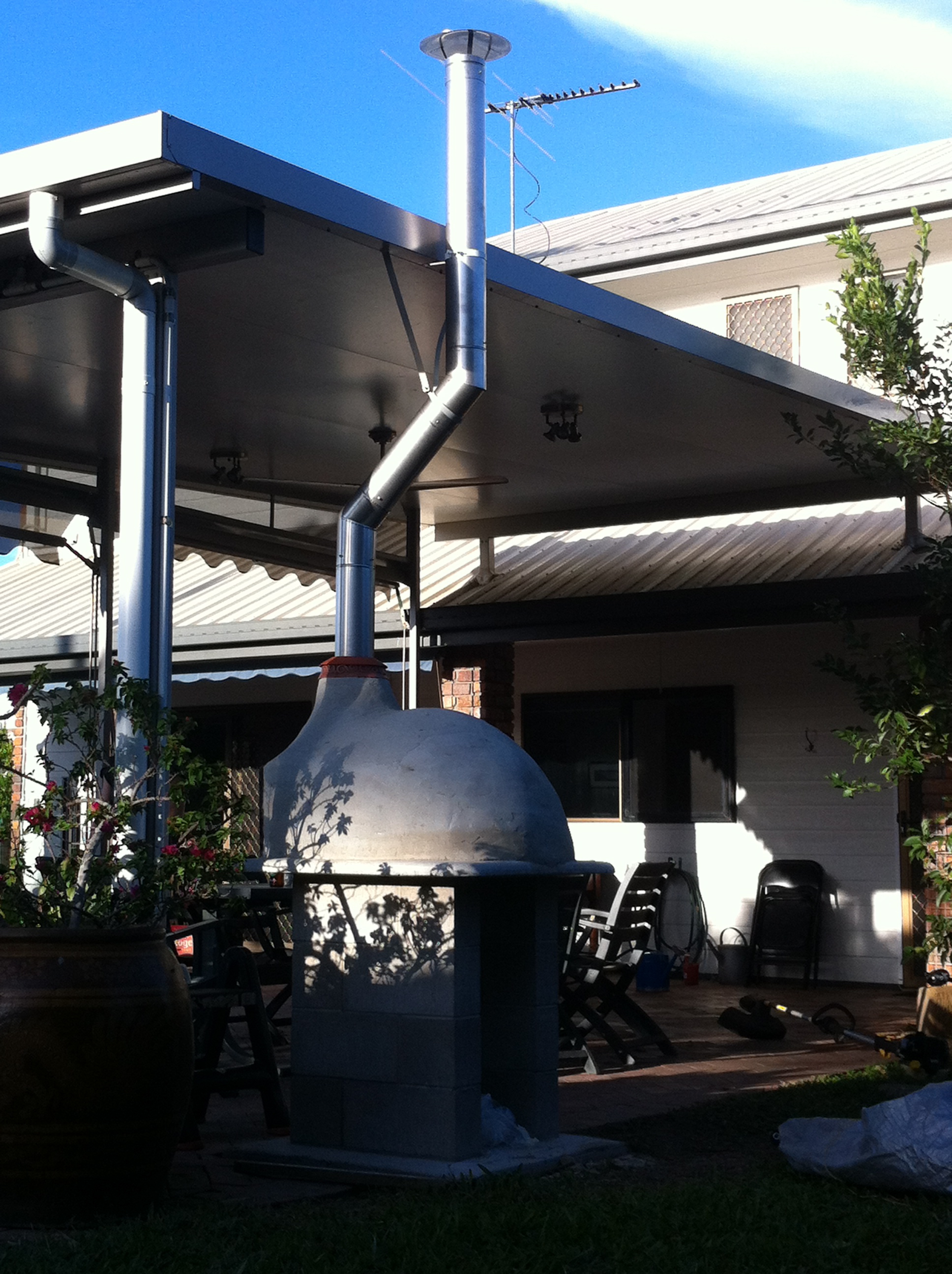

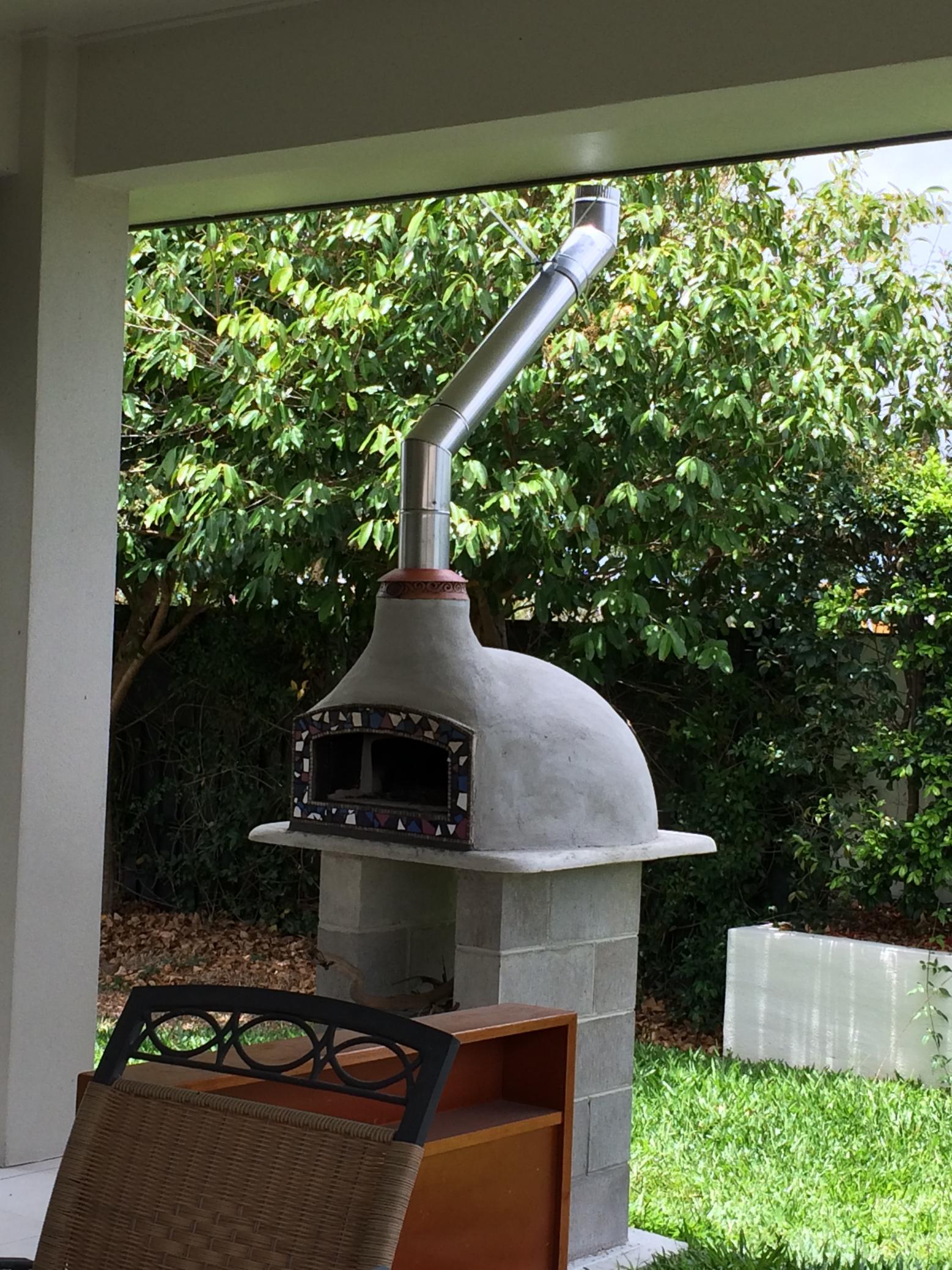

      Here's a solution for you. I've built a few like this Here are a couple.
Name:	Stu and Laras oven.jpg
ID:	384902 Click image for larger version
Name:	Tessa and Leighs oven jpg.jpg
        Thanks David. That certainly would work, but my wife does not like to see a long length of exposed vent pipe. That's why in my igloo design I have a chimney built up in the front. She's ok with a little pipe coming out of the top but would like it kept to a minimum.
