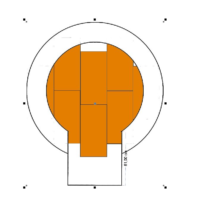

      What do you think for this pattern?
Name:	floor plates.JPG
        • 5262
        Looks fine to me, Just a side note, the FB ovens floors use large fire brick tiles and they are not on an angle and dont' stagger joints but I personally think it is better to stagger the joints.

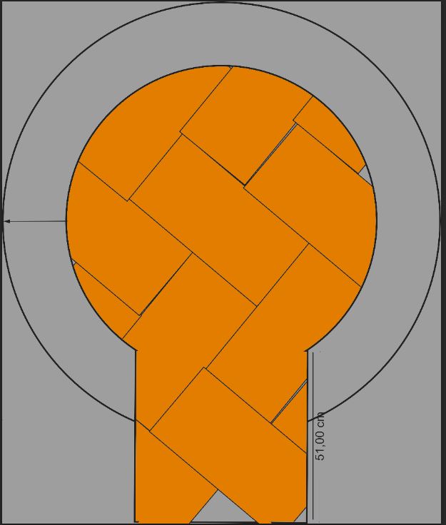

          I made another pattern.
          What do you think for this?
          I think,this is better than the previous.
Name:	floor plate2.JPG

            I like this idea better. With the Haring bone pattern you are much less likely to catch a edge on your peel. If it does not use to much more material I would do this option.
            Randy
            • George_M
              • Oct 2014
              • 290
              Nice!
              I will keep this pattern.
              No,is almost the same number of plates as the other pattern,i will use the cutted plates to fill the pattern.
              Thanks

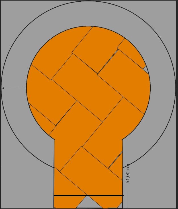

                George, something I learned from reading posts, if you lay out your pattern from the entry way back, you can avoid having some small or odd pieces visible at the front of your oven. I can't tell from your picture but maybe that is something you already accounted for. Not sure how well this will work with your larger size plates though.

                  Hi,
                  You mean the half bricks marked in the rectangle?
                  • JRPizza
                    • Jan 2012
                    • 1557
Name:	big tiles.jpg
ID:	386488 Yes, it's kind of hard to tell, but if I moved those bricks backwards any (slid the pattern) it would introduce small triangles along the front. I moved the pattern forward just to the point where the small pieces would be eliminated at the entry. If you read the "what would I do different" forum, you will see this brought up a few times where folks ended up with the small pieces where they were most visible and possibly prone to movement. If you move your pattern forward so the line I drew is at the right point in your landing it might work out.

                      Thanks for the remark my friend!
                      I will read the thread and i will make another pattern.
