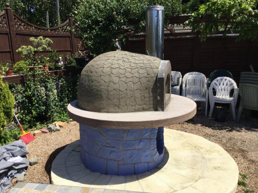

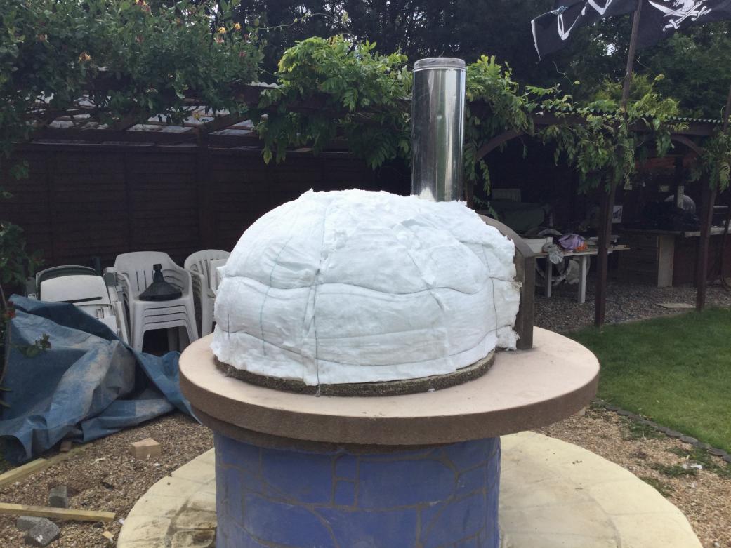

      • #33
        I used 4 x 25mm ceramic fire blanket & used two coats of cement to get this far.
        First coat was mixed 2-1 with added glass fibres, second coat just standard 4-1 Portland & coarse sand.
        I will use 4-1 Portland with fine sand to form the rock effect I have used on the plinth.

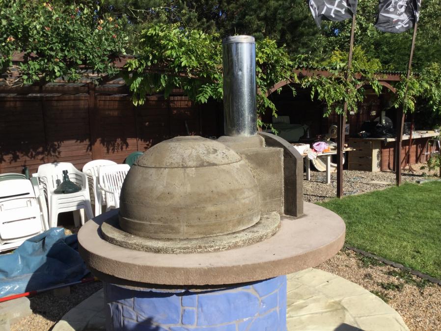

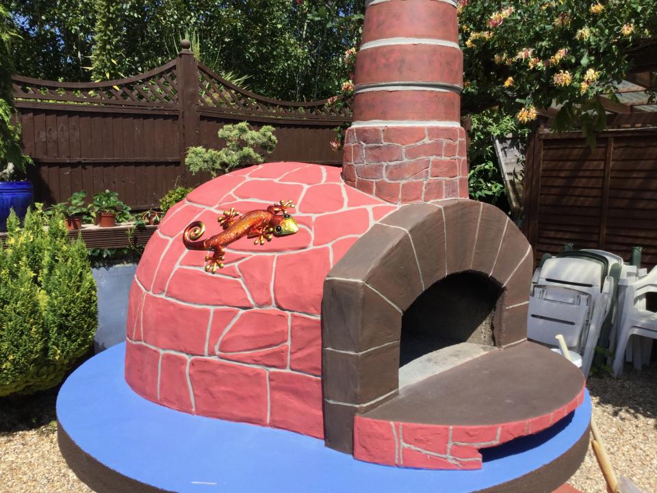

              Almost there.....
              • #37
                I cant find a chimney pot that will fit over the flue pipe, I hope I don't have make one!
                Anyway, I have been drying the oven with smallish fires for around a week with no noticeable issues so far, so we had our first cooking fire last evening.
                I got the sides up to 350c & the base to around 280c. I cooked a few dishes include some fresh mackerel I caught in the day, really good results
                I have plans to build a nicely shaped hardwood roof but I must now get on with casting the next one.....

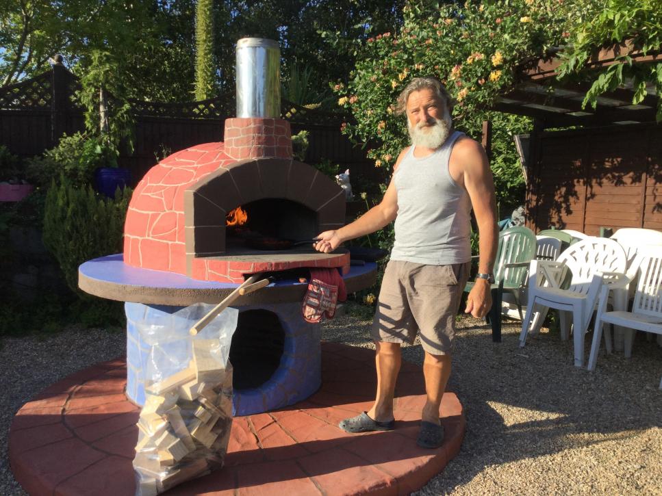

                      • #41
                        The oven works really well, no cracks anywhere..

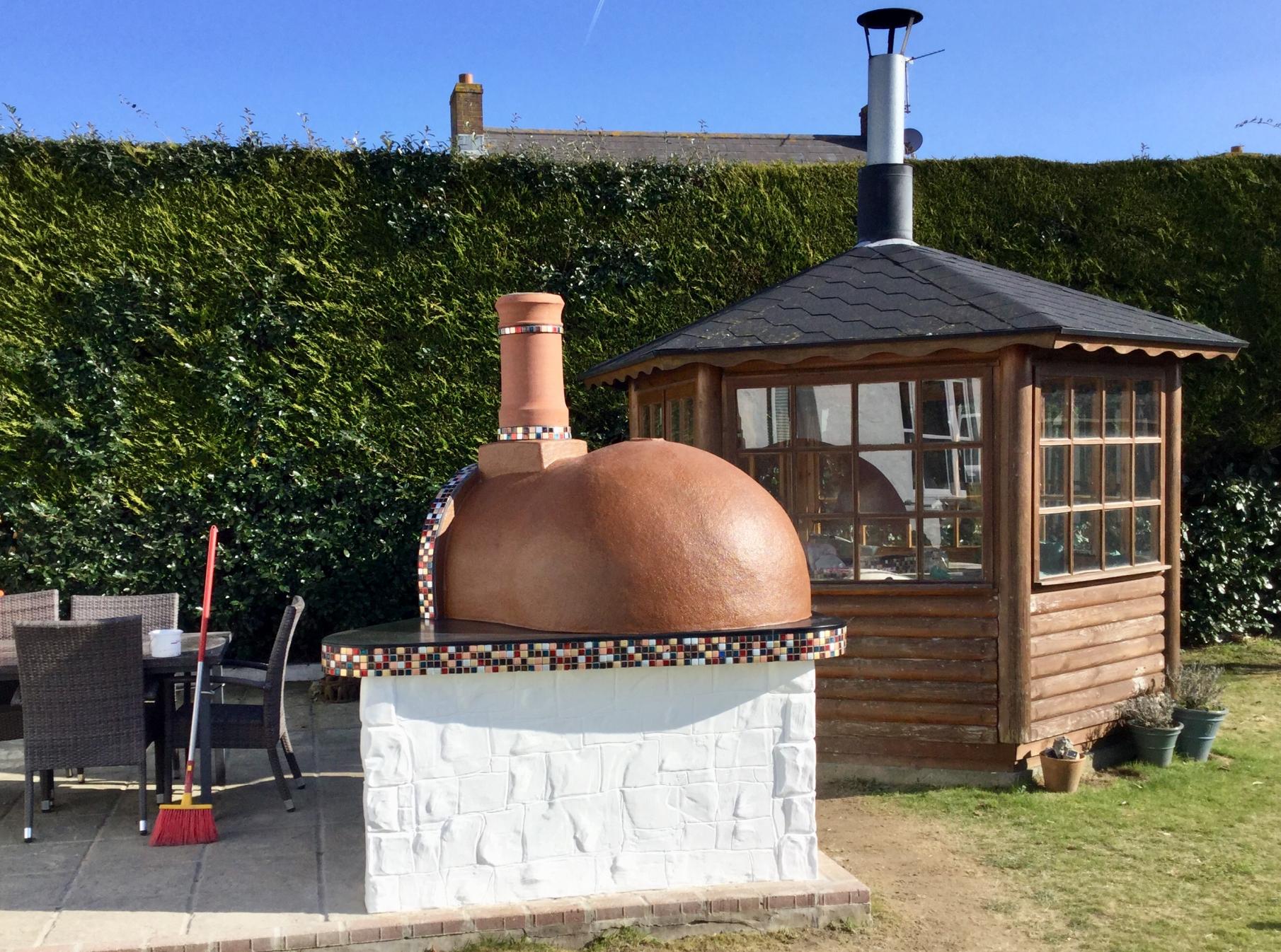

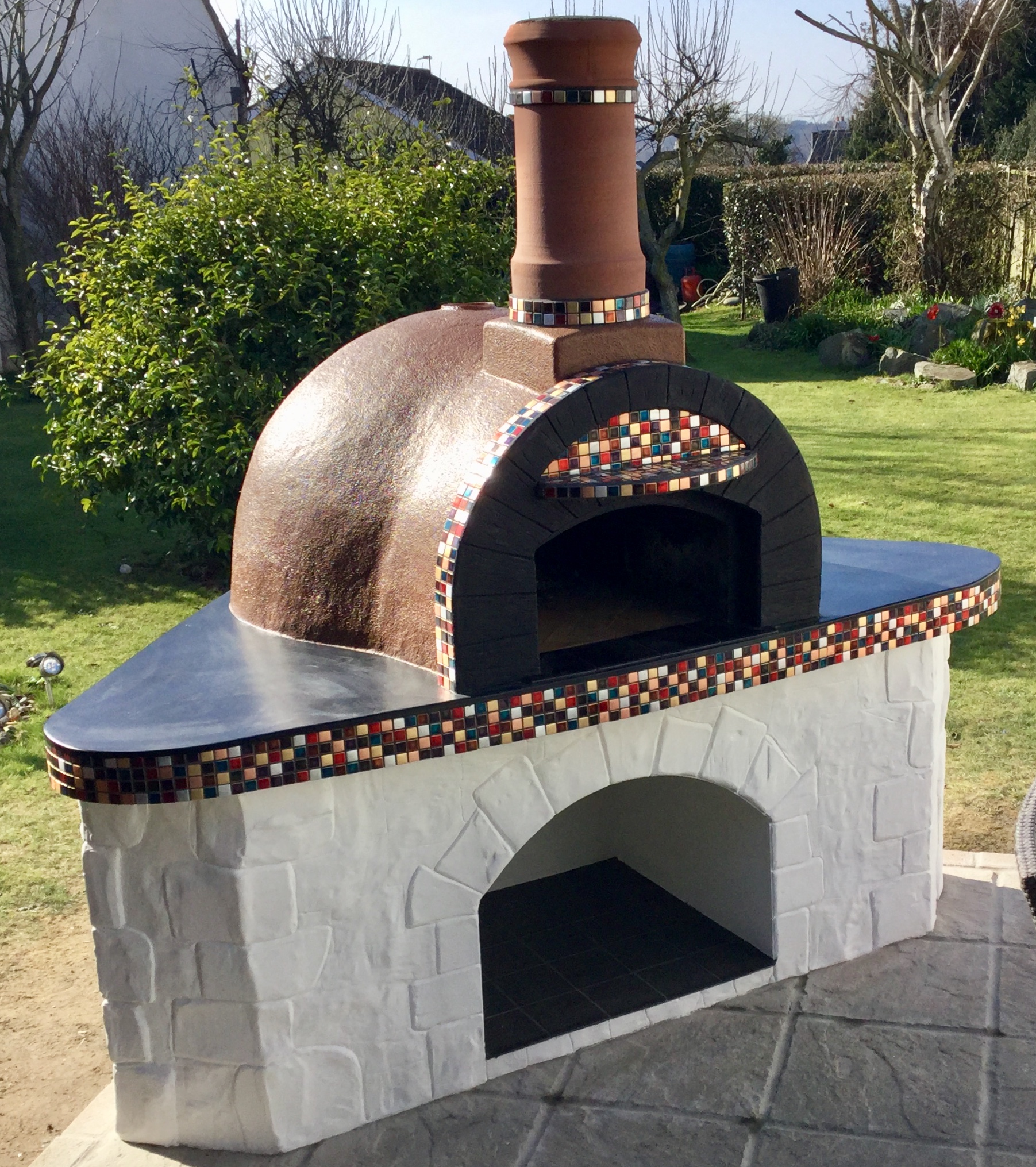

                        • #42
                          And the latest one...
