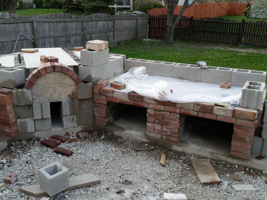

      Our bases have relatively short span and perhaps with enough rebar ( angle iron embeded in concrete ?) it will be sufficient to support the oven weight without flexing, but I wouldn't risk it . To maximize the opening height however I built a brick arch (on the left). Storage area Arch underneath oven opening Arch will look really good too

        Thank you for the replies, those were my questions. I will either arch it, or leave the lintel. Thanks again!
