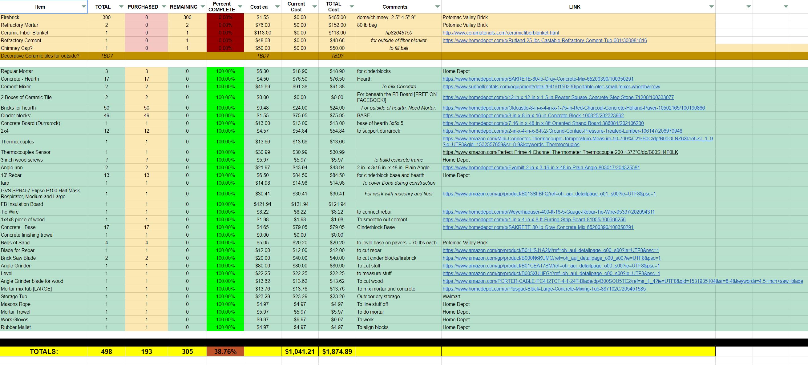

        I've been tracking everything on a google spreadsheet, so far, I'm at about $1800 for my 36" oven (including supplies, incidentals, tools/equipment, & rentals). The only thing I haven't factored in yet was how I plan to finish the exterior (tile or stucco).
        NOTE: I have estimated 300 bricks for this build... I plan on buying my bricks in batches of 75 so we'll see how many I actually use.

            I used to teach classes in Excel at our local community college and I just couldn't imagine not using a spreadsheet for tracking my build & baking costs. I also wanted to keep a tally on how many loaves (kind of bread and to whom it went) I gave away. I've attached three screenshots of portions of my record keeping work sheets. These are current as of today (13 November 2018).
            Bentedesco: Nice layout and use of the Google spreadsheet tools! I haven't tried working to any extent with that software. Looks like it's come a long way from when Google first introduced it...I'll need to take another look.
