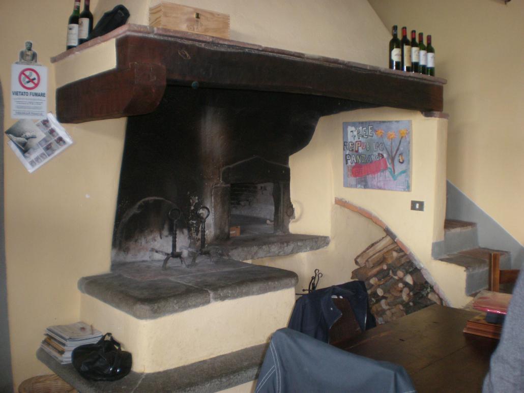

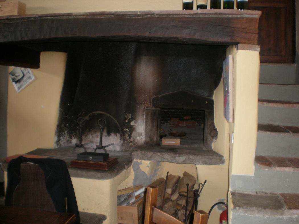

              Here's an interesting solution in an old villa in Penzano, Italy It has the advantage of doing away with the flue gallery to have to work past to get to the oven proper.
Name:	Penzano oven detail.JPG
ID:	411157Click image for larger version
