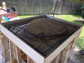

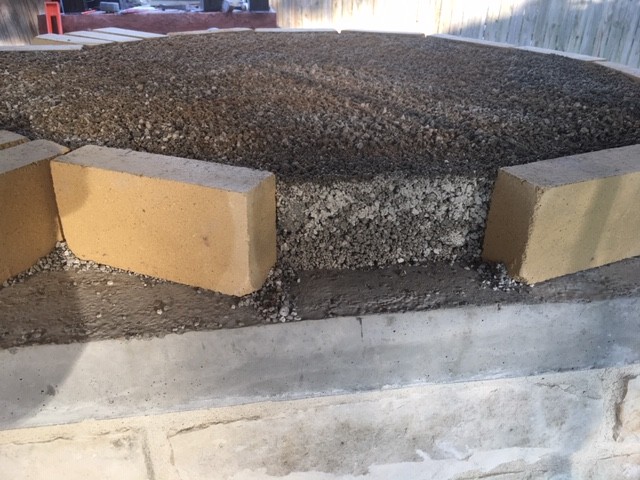

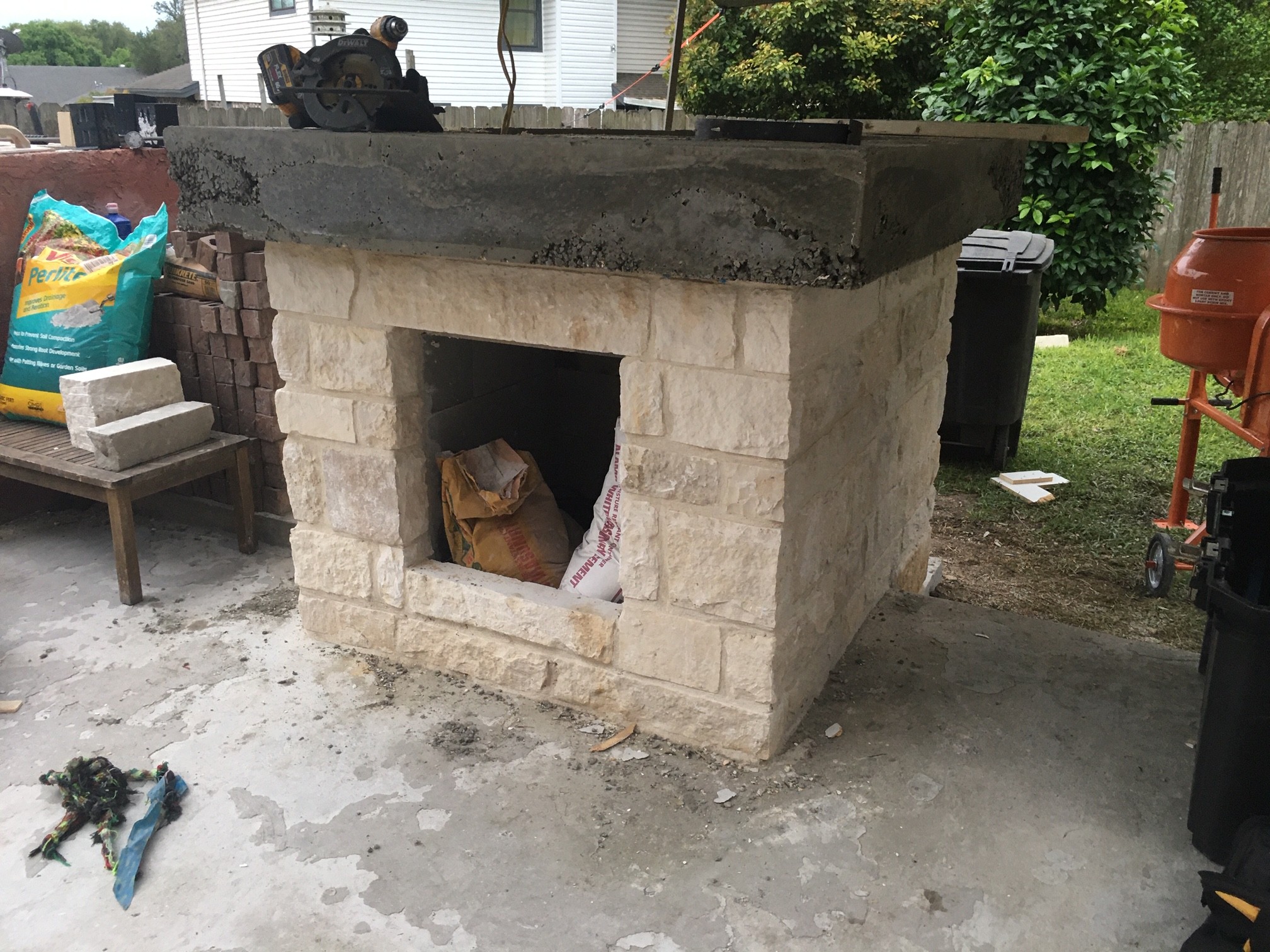

    Pizza oven master builders,
    I have made my oven hearth too thick. Measuring in at 8" looks strange compared to stone support. Is there a pattern or ways to minimize the top?
    My original plan was to put granite on top and sides. Adding 1.5" or 2".
    I wonder if a combination of dark wood around sides and lighter top might make the large border look less noticeable.
    Any help much appreciated.

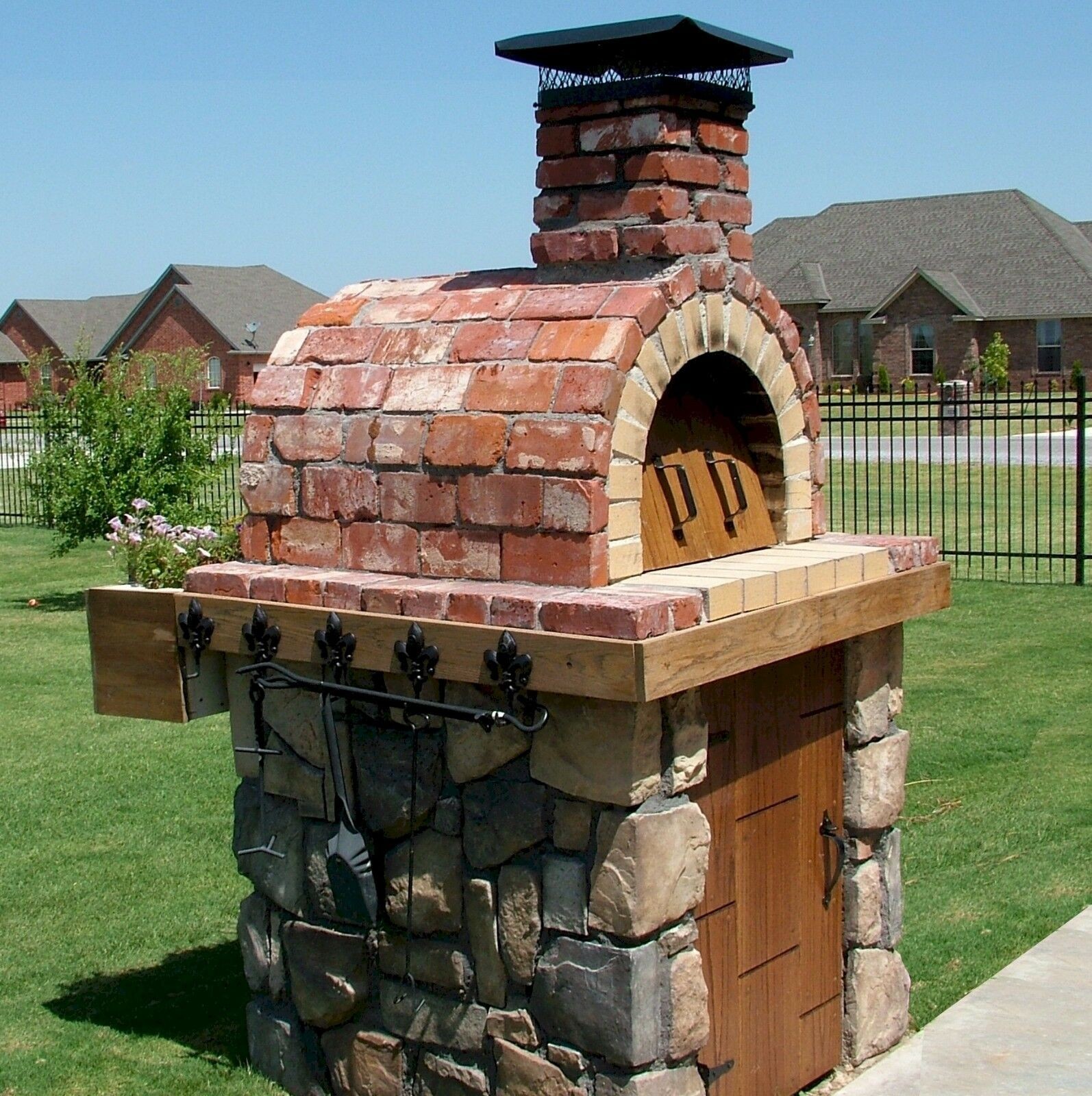

    Maybe a wood trim like this picture?

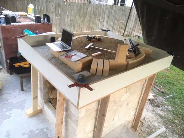

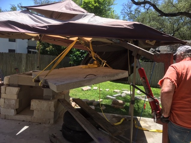

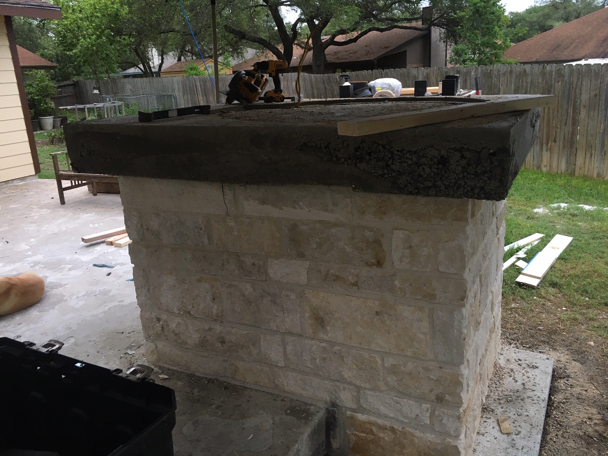

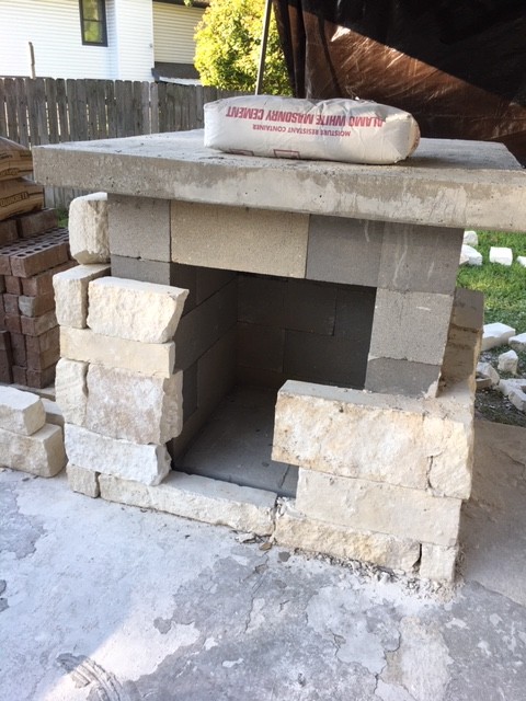

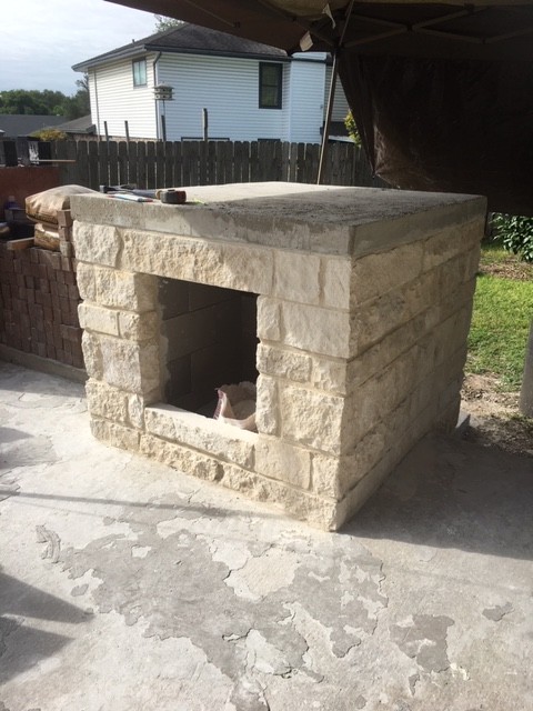

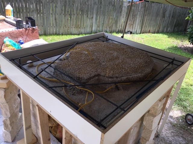

          Here are some picture to give better idea whats going on.

            You can go with the wood look by applying a bonding agent and texturing the hearth to mimic wood or texture to match the stucco. You could also apply tile to the hearth to match the dome if you go that way.

              Thank you for suggestions! Still deciding if going to wreck out and try again. Like your idea of matching dome with hearth. Hmm
