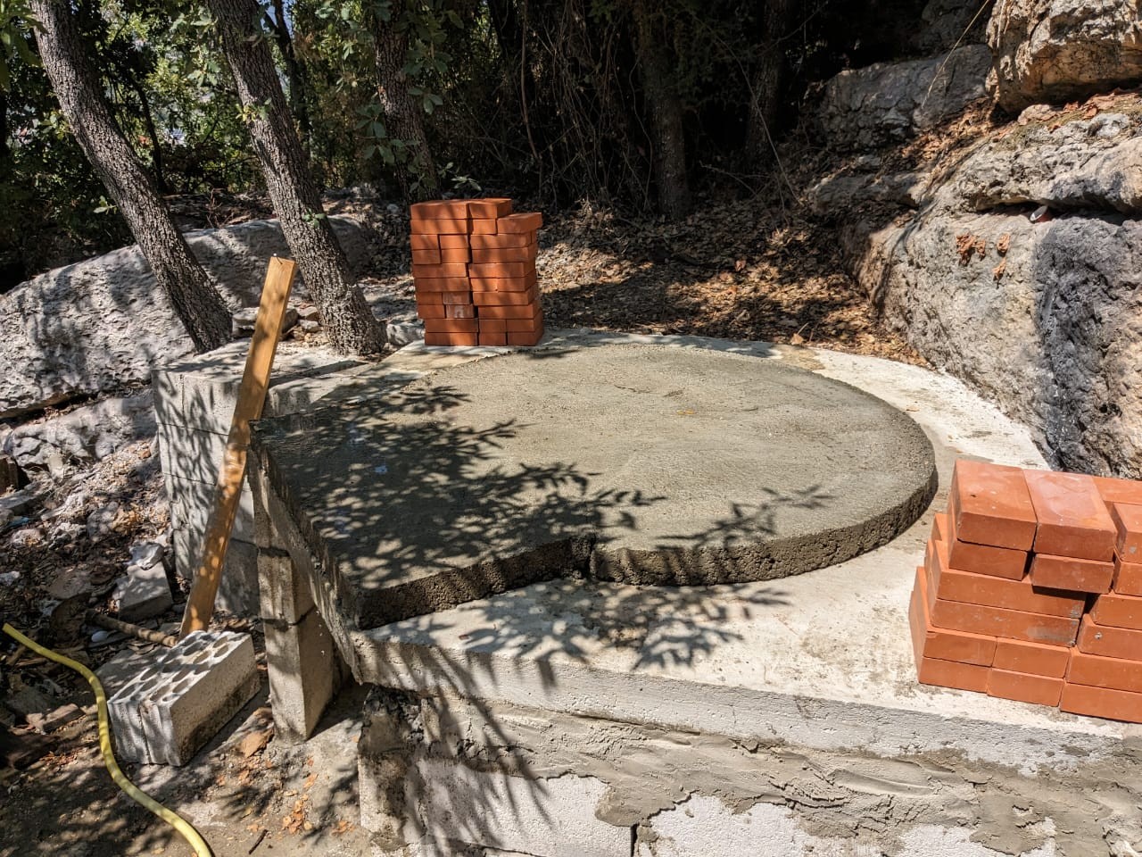

              Hello all, I am a stonemason from Lebanon who trying to build wood fired oven, and I have question if 8 cm slab of vermiculite 5:1 mixture enough for isolation under pizza oven

                Welcome to the forum. The recommended minimum for the 5:1 concrete insulation base is 10-11 cm (4 inches). Be aware that standard bricks may not work very well for the oven as they may spall with the normal, high temperature changes that occur during the firing cycles of these ovens.

                  Thank you for your help, I am using fire brick offcourse, should i add more vermiculate or can I use ceramic wool blanket because in my region I didn't find ceramic fiber board, or I continue with the 8 cm vermiculite because this project for personal use not commercial?

                    Glad to hear you are using fire brick...just wanted to make sure because of the red bricks in your picture. I strongly advise adding another layer of vermicrete (2 to 4 cm, 5:1) on top of your existing 8 cm of base insulation. If you don't, you will lose significant heat to the concrete hearth below and end up using more wood to fire the oven or maintain cooking/baking temperature. The ceramic wool blanket is highly recommended to cover the dome, but if you put it underneath the oven it will compress and not provide much (if any) insulation. You should start your own build thread instead of using this one (started by WalkerW in 2020). It is always good for other builders in your region to learn from your experience on how to cope with finding substitutes for difficult to find materials/equipment.

                        Mike gave you the correct advice. Also the dome walls also need to sit on the vcrete and not the concrete hearth so there is not a heat sink.
