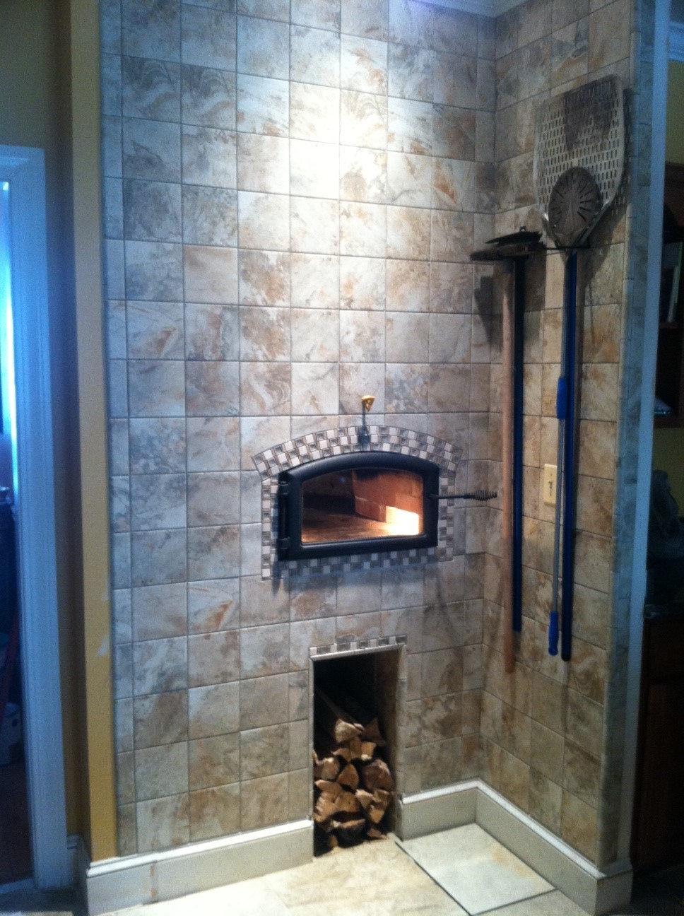

      Yes, definitely would need doors. My first indoor oven had air tight wood stove doors and thinking the same configuration for this setup.Click image for larger version

        Yes, that will most certainly work.
        Great setup in that photo.
