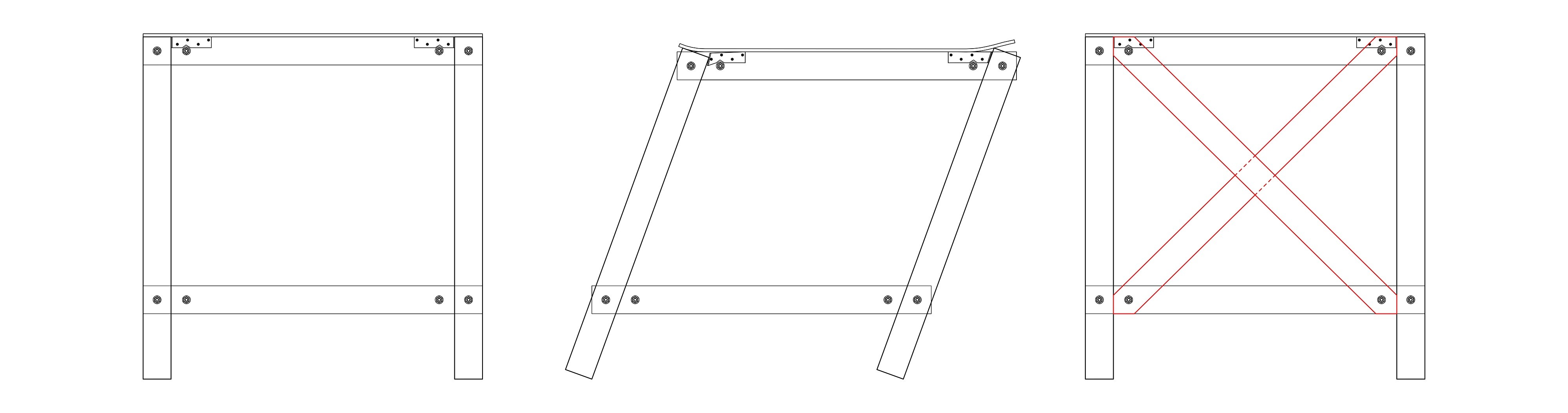

    You're asking a lot of those little steel brackets. The force near the hinge point, i.e. the single bolt location, is pretty big. No-one can say if they'll hold or not, but I would consider (timber) cross bracing essential if I was building it.
    Regards,
    Mark
    Click image for larger version Name:	cross-bracing.jpg Views:	0 Size:	200.4 KB ID:	438530
    I feel confident that the system won't buckle when I pour in the concrete. After this is done, I'l test if there is any movement in the frame. If so, I will add the cross bracing. Thanks for the advice!

    Thanks for the advice on safety! I postponed pouring the concrete and focused on the stand. I couldn't find cross bar easy/fast enough. So I decided to add heavy duty steel corner plating on all sides and I added additional bars 6.5 x 6.5 cm below (see photos). Is this sufficient?
    cheers!
    Hi Mark
    Regards,
    Mark

    Make sure you strengthen the stand. as you've not half checked the timber it can easily move, especially if it's exposed to the weather.

    To Mark's point - if you have or might have any little children around the oven consider adding the cross bracing and making the stand "overbuilt". An oven dumped on it's side would be a bummer - having it drop on a little human would be a tragedy.

    I did warn you to cross-brace your frame. There's literally nothing stopping that design of yours from folding itself up and becoming a folding table! Sorry to be a party pooper but it's a real risk. Once you have some weight on top and a few mates leaning against it things could go South pretty quickly.
