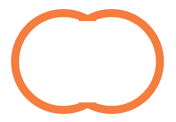

      Thanks David,
      I did think to cut a section away on two then joining them together to get a bigger dia. flue.
        • 9213
        Cutting and joining could be difficult and problematic. How about just a double barrel flue. Another member did it that way a few years ago. Worked ok I think.
        • Charl
          • Jan 2021
          • 6
          Yeah could do - the thing is since these are cheap they pretty much make for a cost effective flue and easy to insulate and brick up around it.
