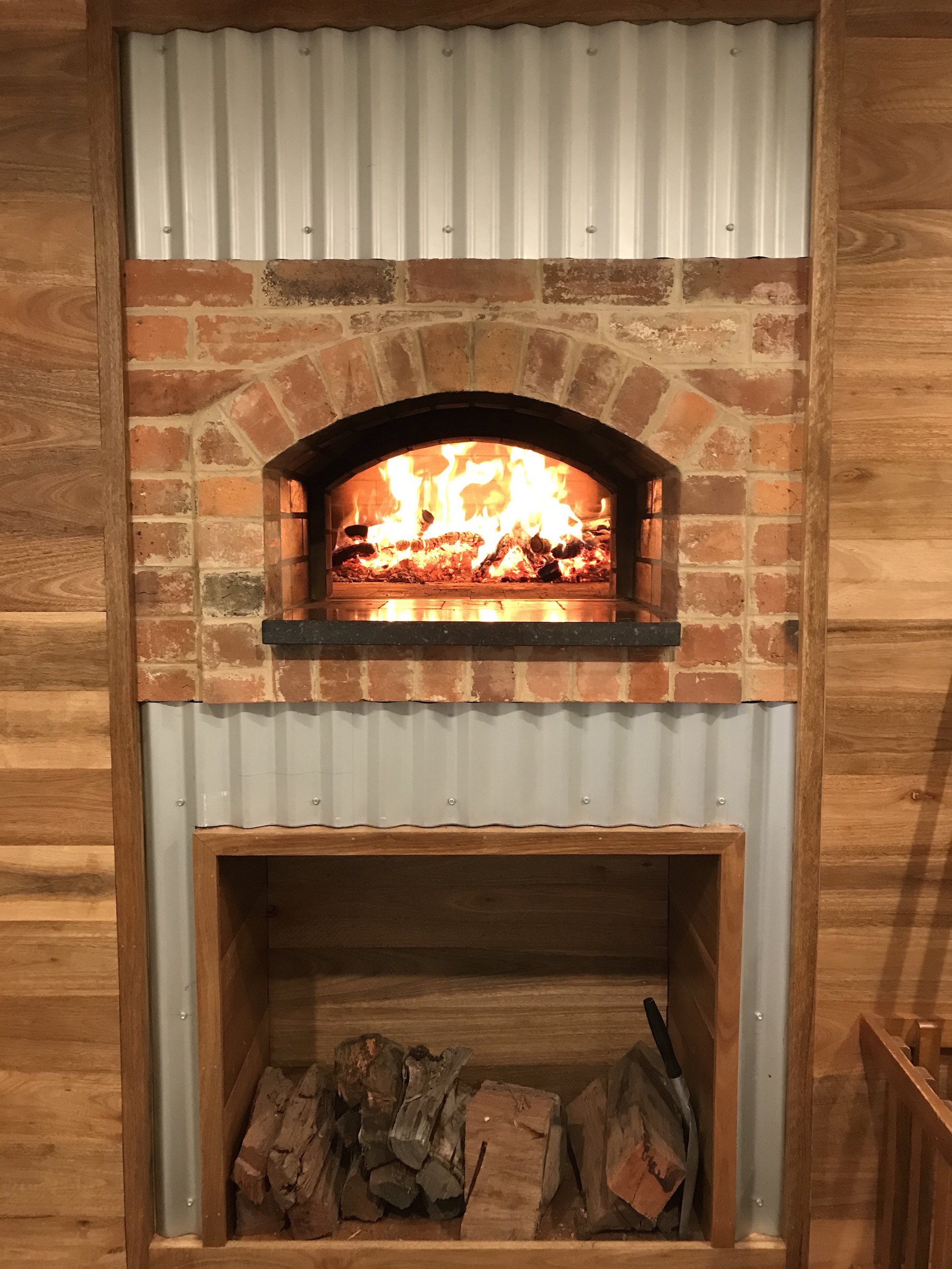

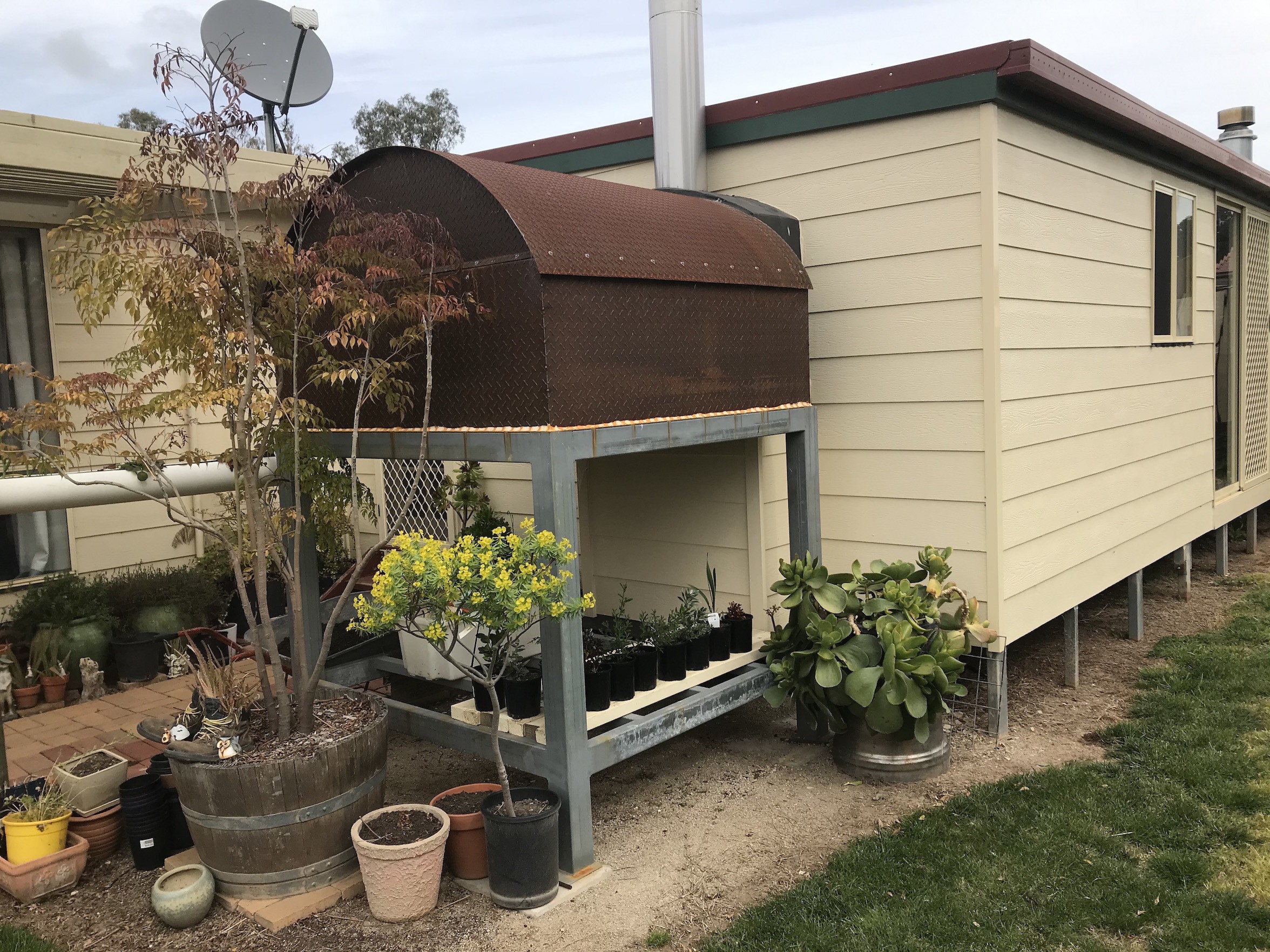

              Knock the back out of it and build an oven outside and use the existing opening inside, you may have to adjust the the entrance to close it up a bit
              After a long illness I have finally started to build a bread oven for our new WFO and cooking classes, The oven needs to be built first before we close in the 9metres x 5metres room, only the entrance of the oven will be in the kitchen with rest of the oven outside. With the floor height 500mm of the ground
