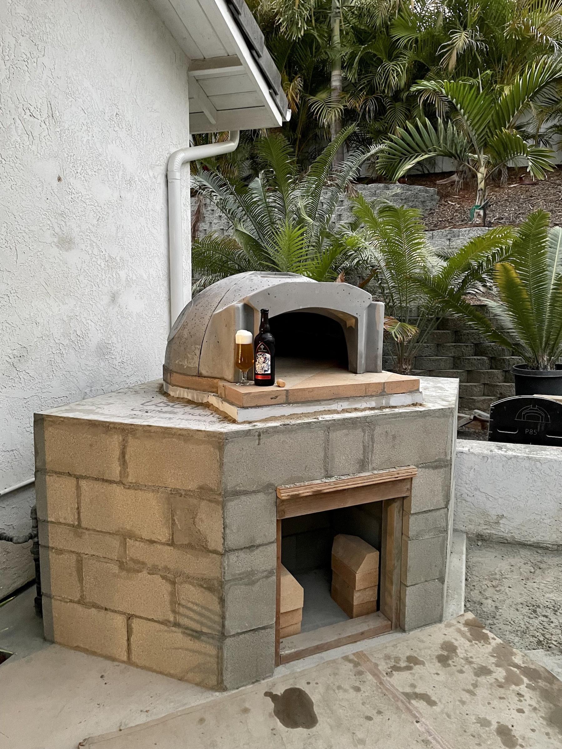

          Here's the progress so far on my Melbourne Fire Brick Co. P85 precast oven. Thanks for the suggestions above but I wasn't sure how I was going to be able to form the internal areas for a suspended slab so I ended up going with 2 layers of 1/2" Dura Roc. In retrospect I would have omitted the 4" CMU layer, used the Dura Roc as I did and poured a 3" slab on top of that. Either way this was easy, cheap and seems pretty bomb proof as is

            Than is an unusual way to go, it should be OK as you are not spanning any large spaces but you dont seem to be using much insulation under the floor bricks?
              This is the design of the kit I purchased. They've been in business for over 10 years so I'm trusting the 2" cal sil insulation is enough.

                  Yes it will be fine but is about the minimum recommended amount. Of course it is all relative to what you require from your oven.
                  Where will the dome sit with your design, on top of the floor or outside of the floor?
                      The dome sits on top of the floor

                        Prego Giovanni, this precast oven is supposed to retain heat for about 36 hrs so we'll see. Not sure how much I'll be using the oven for that purpose anyways so not too worried about that. As far as adding Foamglas, that would add too much height to the finished floor level and the floor tiles have been mortared in so that's not an option at this point, however; the kit does come with an aluminum flashing and a high temp appliance/oven sealant to address moisture infiltration.

                          So the floor bricks are mortared together ?
                          That is an interesting dome, looks like some form of interlocking lugs on the side.
