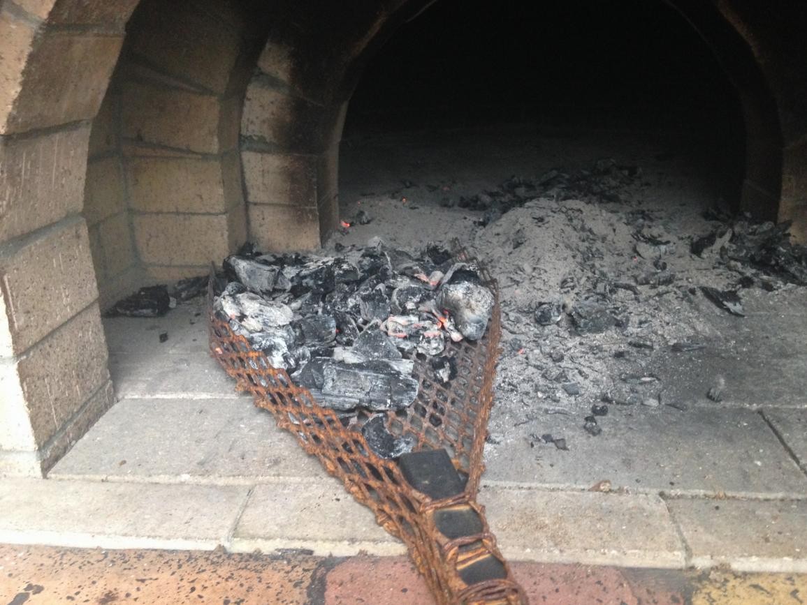

ID:	444123 For the times that I do not fully charge the oven, I use a home made coal scoop to separate the lumps from the ash. I usually put them in my grill with the vents closed to snuff them out. They are unburned fuel that come in very handy for multiple purposes.
          Is that made from wicker??? Doesnt it burn?
            No. It is made from expanded metal. It's just rusty and appears that way. I make all my tools from scrounged material. I have my eyes out for some stainless steel. But, that is hard to come by on the cheap
              Ahhh , I see it now. Like a old grill grate...... good idea.
