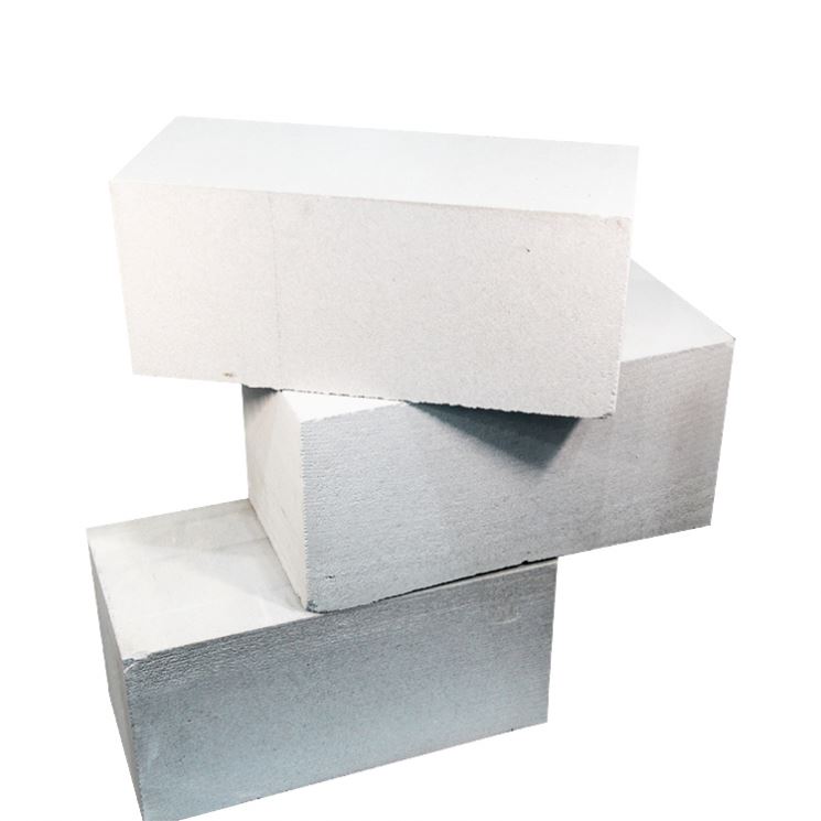

    Lightweight Insulation Bricks (Mullite, Bauxite, Silica, Alumina, Soft Clay, etc)
    Lightweight insulation brick is a kind of thermal insulation material, which refers to thermal insulation brick with high porosity, low bulk density and low thermal conductivity.
    - CLC Blocks (Cellular Lightweight Concrete)
    Cellular Light Weight Concrete (CLC) is a light weight concrete that is produced by mixing cement and flyash slurry with pre-formed foam. Thermal Insulation: CLC Blocks are excellent for both Sound insulation and Heat Insulation. Due to the presence of air pockets which are not interconnected, the water absorption of CLC blocks are relatively lower than any other materials.
    Click image for larger version  Name:	CLC.jpg Views:	0 Size:	141.1 KB ID:	457431
    I can get K26 Lightweight insulation fire bricks from ISOCEL (Brazilian company: http://www.isocel.com.br/) which support up to 1400°C / 2552°F.
    I would like to know if i could replace the Perlcrete/Vermcrete or even FB boards with them. They told me that I can mortar them to the slab (hearth).

          This guy is using insulating white bricks for floor insulation, right ?
          https://community.fornobravo.com/forum/pizza-oven-design-and-installation/pompeii-oven-construction/439983-another-minneapolis-wfo/page3
          So.... whats wrong with it and its thermal conductivity ?
          Click image for larger version  Name:	fetch?id=447161&d=1655502014.jpg Views:	0 Size:	518.1 KB ID:	457608
            If these are true insulating bricks (the white ones), insulation bricks are decent insulation with a K value of around 0.15 vs Ca Si 0.05 but they are very soft and will not stand up to the abrasion the floor takes in day to day cooking and also do not store heat like a regular fire brick will.
              Nothing wrong with insulating firebricks as insulation--as Utah says, they have a K value that is decent, if not quite as good as Ca Si boards. As Utah says also you don't want to use them for the cooking floor because they will abrade, but I don't think you were suggesting using them as the cooking surface. I think the reason insulating firebricks aren't often used for pizza ovens is that they are typically even more expensive than Ca Si for lower quality insulation. Poking around online I see insulating firebricks for $5/brick, and you'd need about 10 of them to get the same area as one of the Ca Si boards I used in my ovens. Even with the ludicrous shipping I had to pay to get the Ca Si boards, I still paid a lot less than $50/board. But that's prices for me living in the U.S. If you have access to reasonably priced insulating firebricks in your location, and/or don't have access to reasonably priced Ca Si, ceramic fiber board or vermiculite/perlite, the insulating fire bricks seem like a reasonable substitute.

                Utah, I never said that you can use them for oven floor. They are supposed to use them as insulation material not as firebricks for the oven floor, They are supposed to replace Ceramic Fiber boards or calsil boards, perlcrete or even foamglass, so you should put them under the firebricks/tiles floor. In other words, these insulation bricks should never been touched by pizzas .
                  I thought you asked in your post "what's wrong with this"?? Just answered your question.
