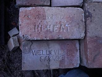

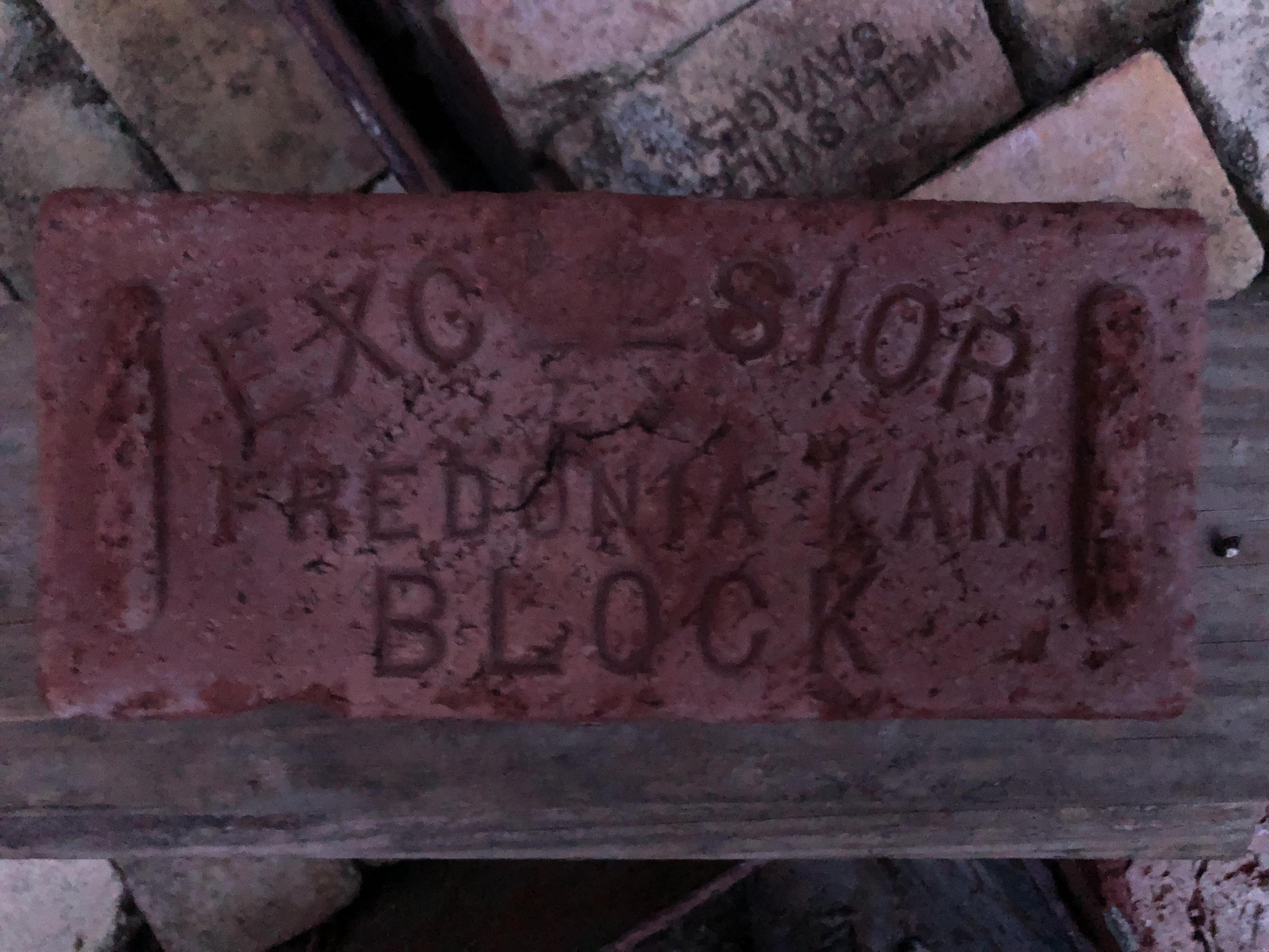

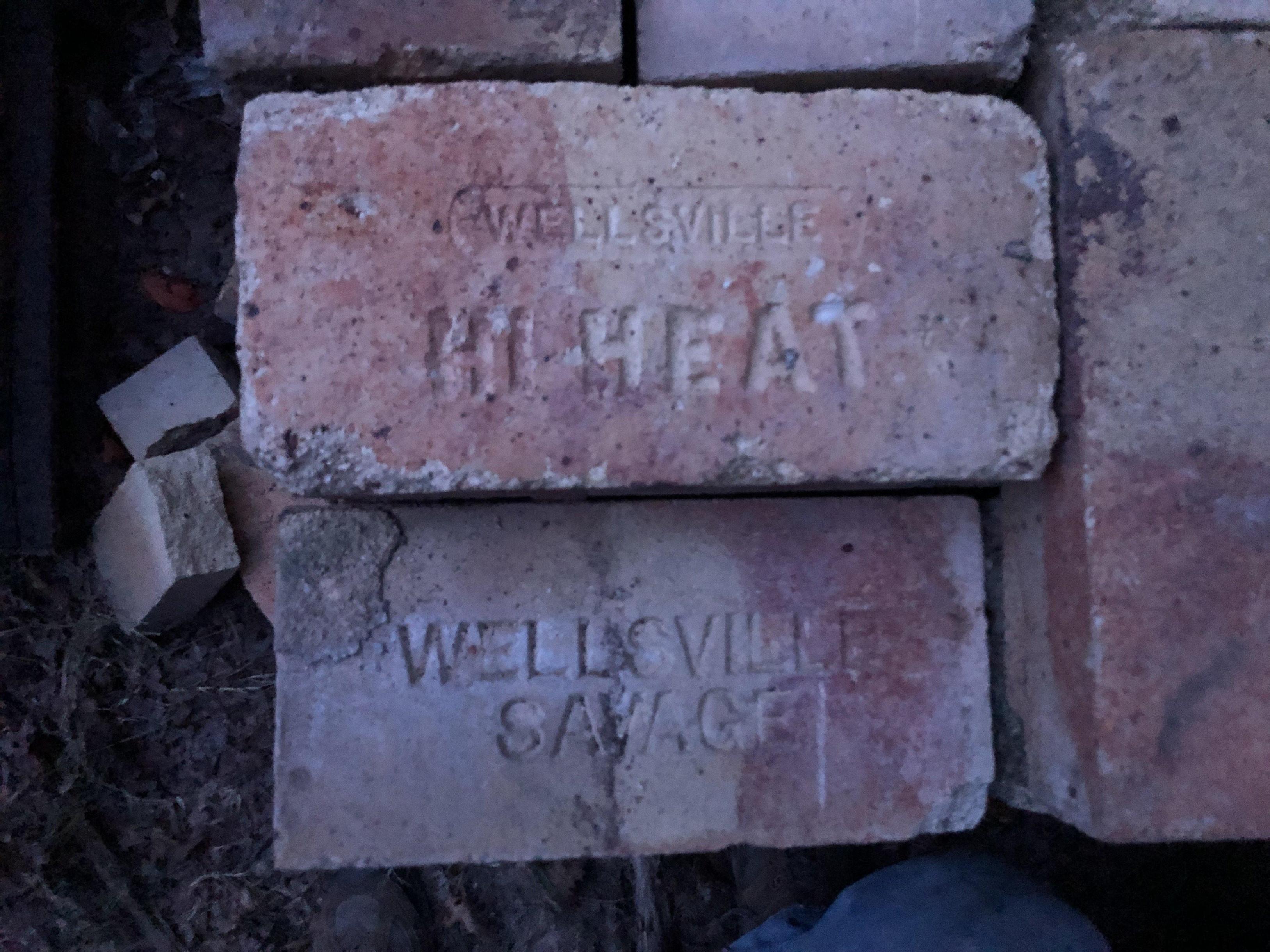

                      in case anyone cares, here are some photos of the bricks I am using:

                        How did you determine these bricks are "super" duty. A red color fire brick does not lend itself to being super duty. Try cutting one on a wet saw, you will know if they are super duty or not if they are hard/slow to cut.

                          I'm talking about the Wellsville Savage Bricks from my images. They are blond (though it is admittedly hard to tell from my picture). And they were the bricks which the wood fired kiln was made from which FIRED the red clay bricks you see above. That's how I know they are super duty.
