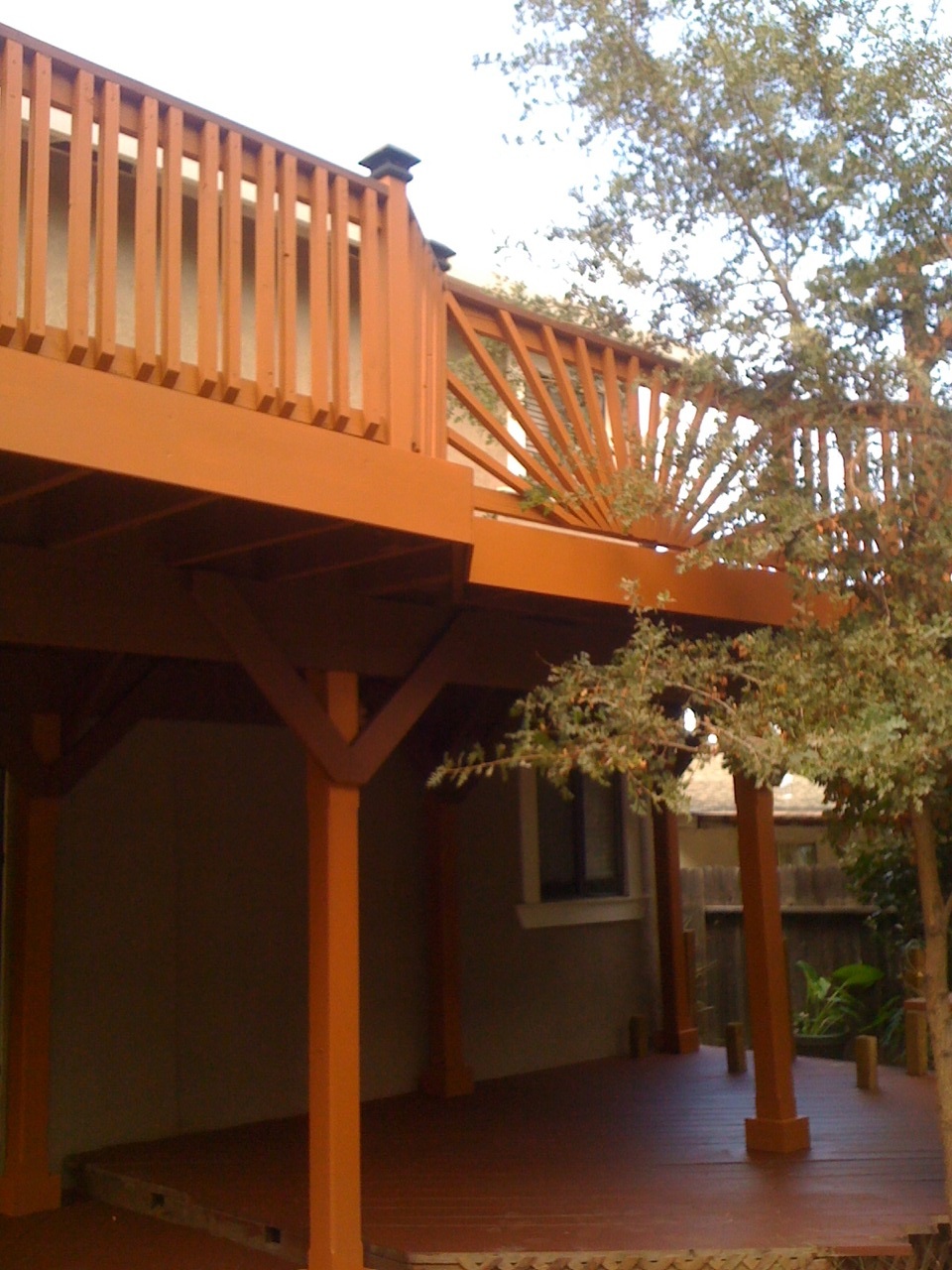

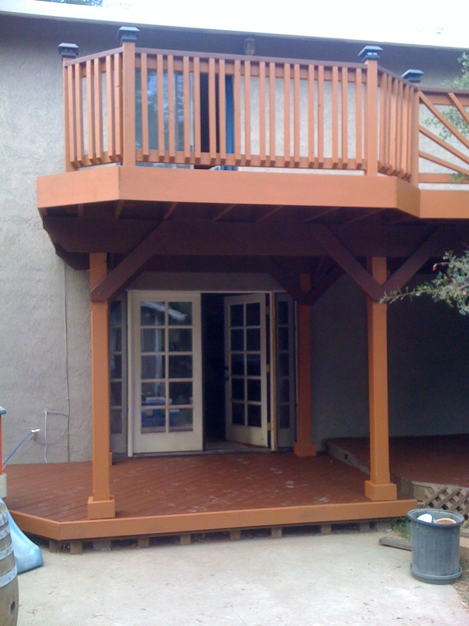

      Well, if you have been following my build, you're probably aware that I've been building a 2-level wood deck next to my outdoor kitchen and WFO. So depending on the time (per weekend) that I have to build, I have been working on one project or the other.
      Here are some pics of my completed, stained & sealed upper deck. I'm staining from top to bottom, so the next thing on the list is to stain and seal the lower portion of the deck.
      Just wanted to include some completion pics because I had included a half-built deck in my previous posts.
      More pics of the WFO project coming right up!
