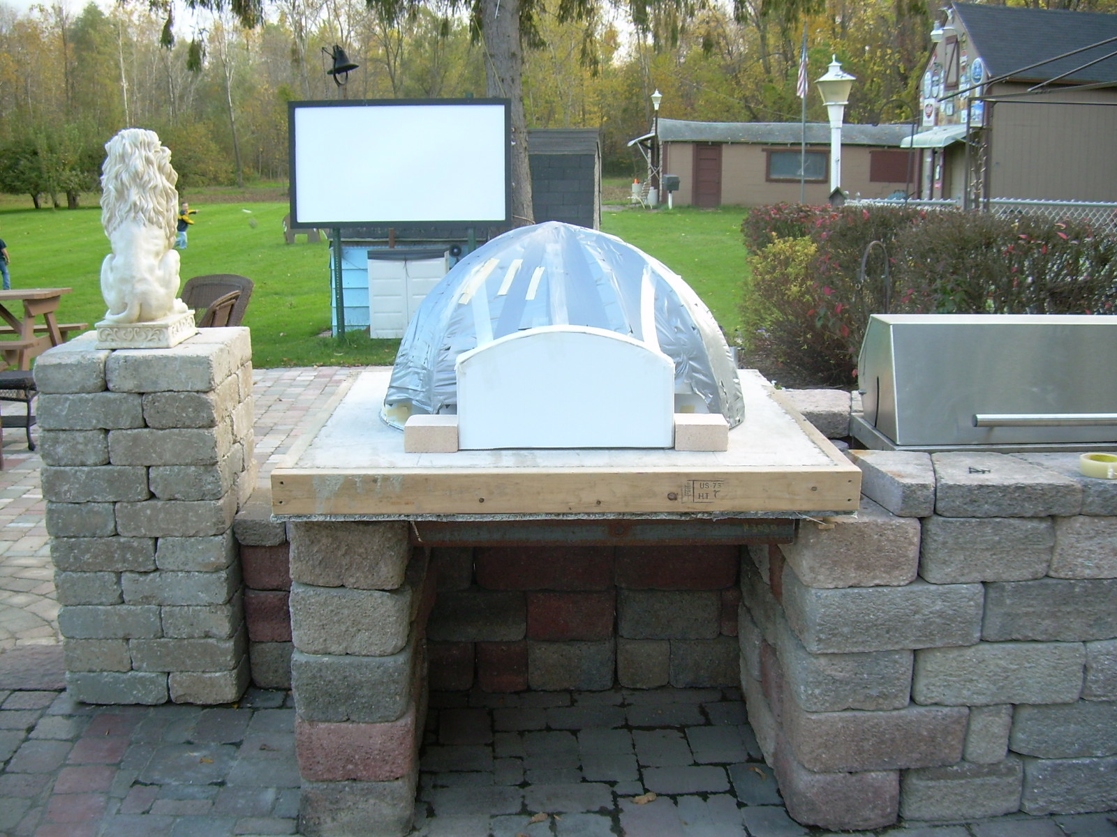

    hope this will work for templet never worked with bricks and morterClick image for larger version

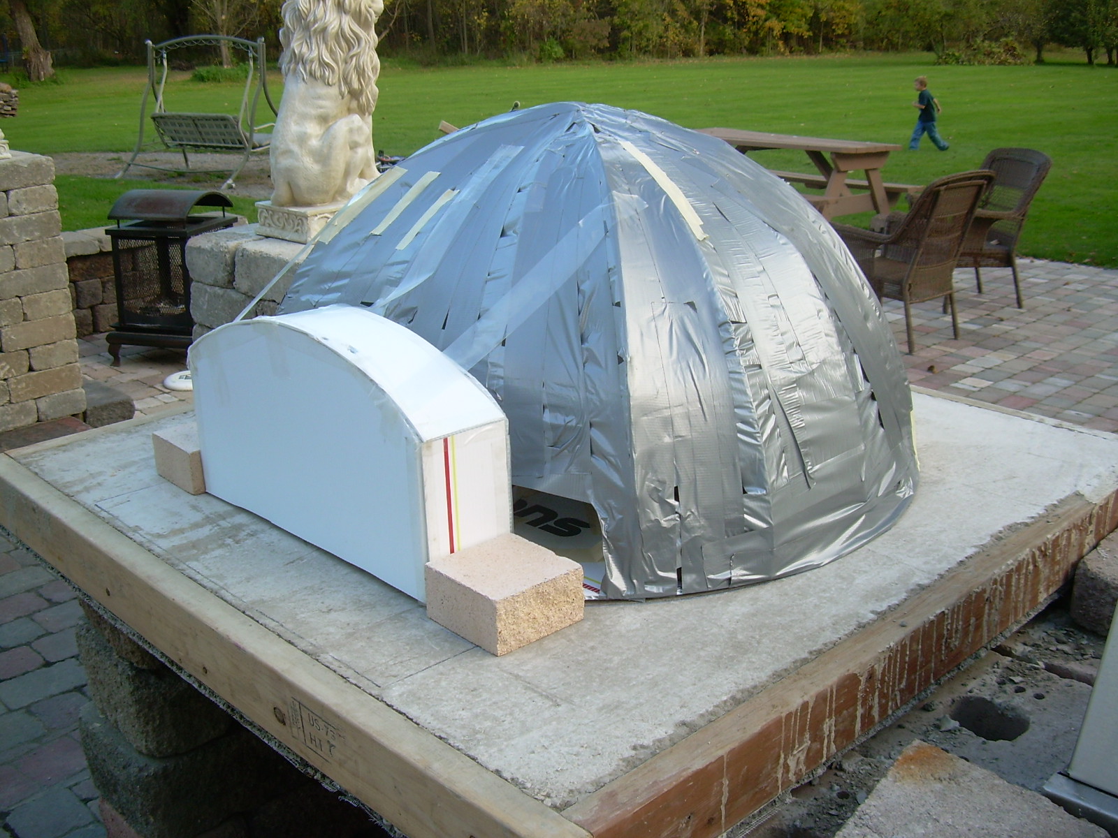

ID:	272634 another shot 10 bags of concrete for harth

      That should work fine!
      Is that a video screen in the background for summer movie nights? Cool!

        Yes it is and the dome is made out of the same material sighn board

          Sumu,
          Looks good. A suggestion if I may...
          When building you really need to get "inside" the oven to keep an eye on your joints and to keeps things lined up. I actually "sat/kneeled" inside of my oven for the first 4 courses - until my "butt" got to big
          You really don't need any support for the first 5-6 rows. At some point you might add support or come up with other ways to hold the bricks up. At a minimum I would just go with the Styrofoam forms on the inside and not rely on the duct tape. That way you can "rotate" the styrofoam as you build the courses. Don't worry - you can do it. I never worked with mortar/brick before either. AND it looks like you off to a great start.
          The top dome is a tricky part. I used a "sand" form to support my top dome and wasn't too happy with the results. Mainly because I couldn't get to the inside and A lot of the mortar "oozed" out onto the brick work.
          Just some thoughts.
          Thanks
          Dick

            I'm with the badger...either use the foamboard as a movable form or check out the "fancy string alignment system" posts or use both...I think Elizabeth did...I used a sand form for top area of the dome and also was not pleased...you can manipulate the mortar a bit there by using drier bricks near the top...it will bond to the mortar a bit quicker and you can still feel the joints and their alignment to the course below...have no fear...it is a bit forgiving...not like building a piano

              I used the string alignment system, the z-clip and string system, and, after I got tired of that (you need more clips and strings as your hole gets smaller, because you move around the hole faster!) I used sticks to prop up the bricks. I agree that a little drier on the brick sets up faster, and by the time you get to that stage, you'll have a pretty good feel for dry vs. wet. And you'll have mastered the fine art of reaching under the edge to feel how the brick you just set relates to the ones under it!
              I'd never laid any kind of brick whatsoever before I built my oven, and it's turned out ok- I think most of us are learning as we go.
