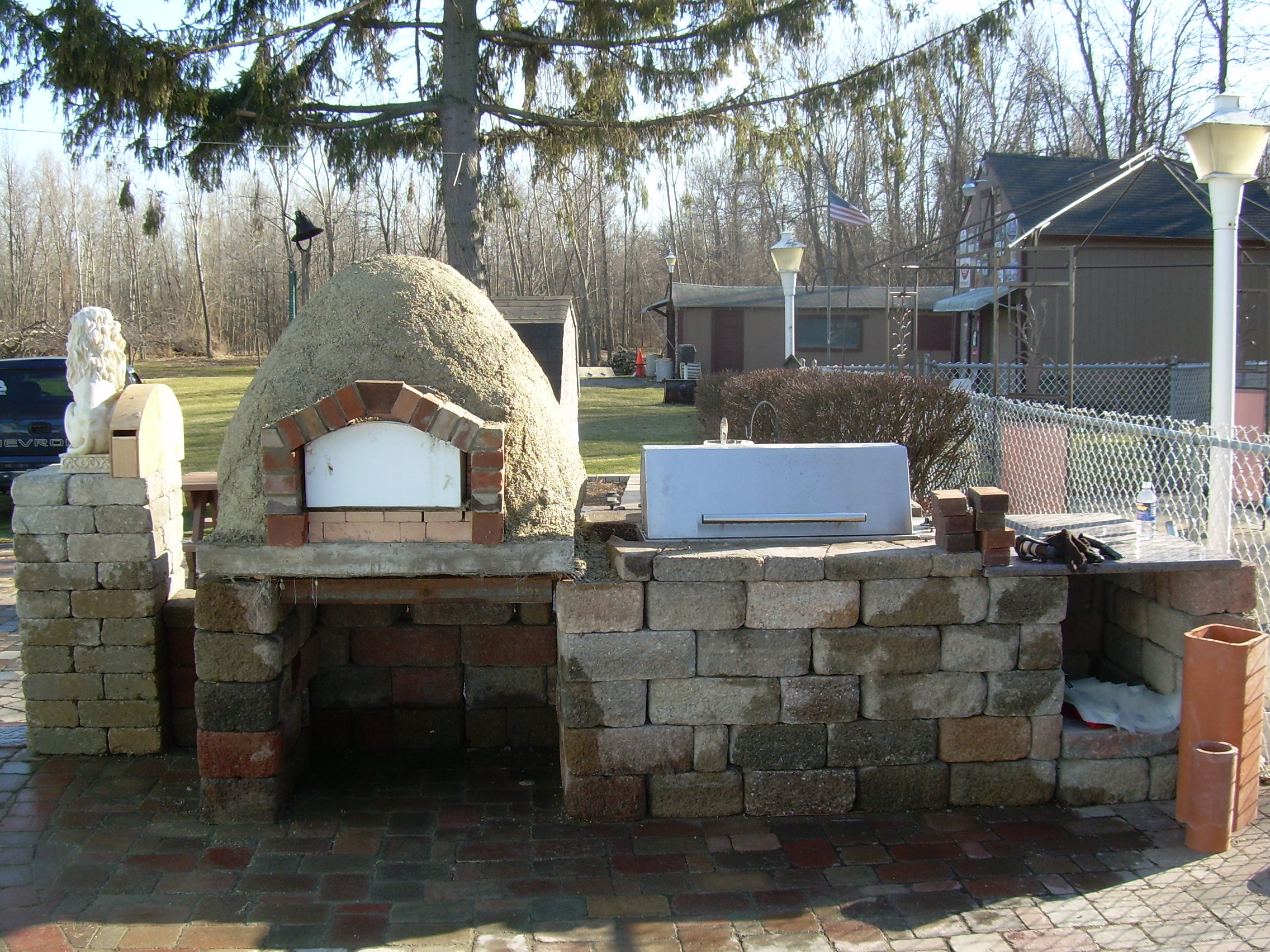

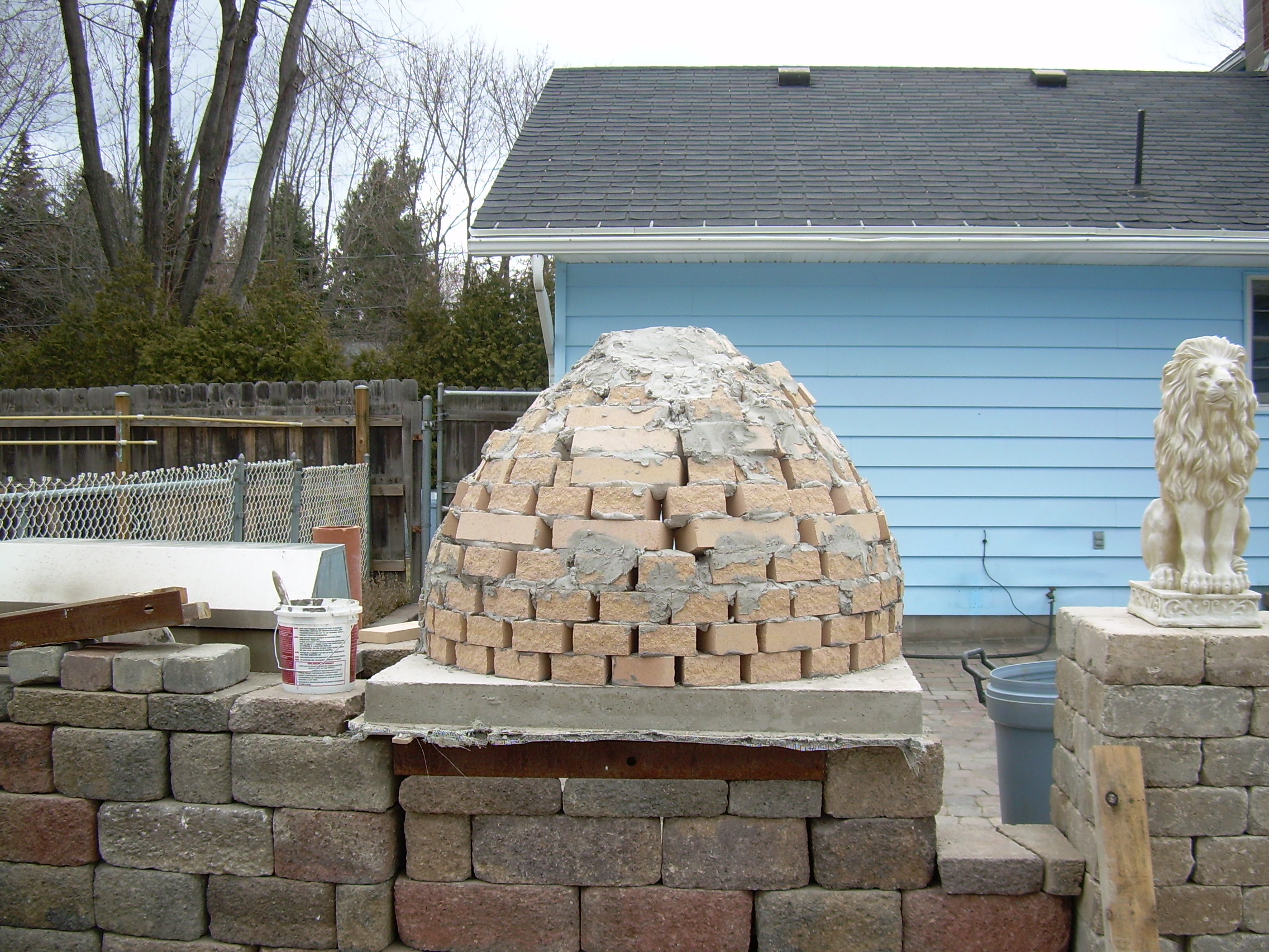

          Re: Hi, I would love to build my brick oven!
          [ATTACH]Click image for larger version
ID:	274633[/ATTACH] here ars some picturesClick image for larger version
