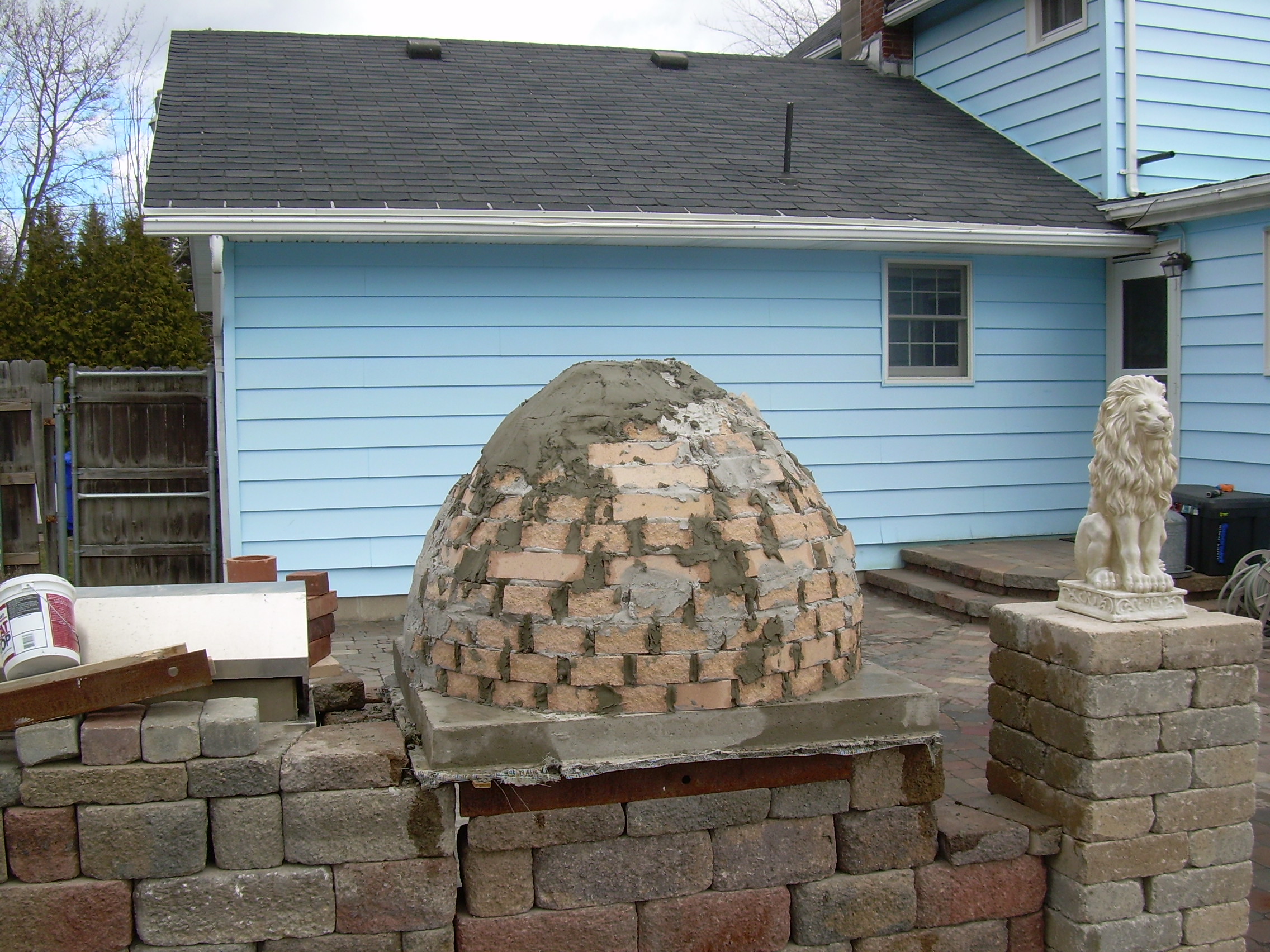

ID:	314867new build this weekend.3-20-09 first time playing with mortarClick image for larger version

    Re: starting oven
    wow, that's the effort of a weekend? Impressive! It took me...oh...about five months to get that far. ;-) You'll be cooking in no time!
    Nikki
      Re: starting oven
      I hope there's insulation under that floor...
        Re: starting oven

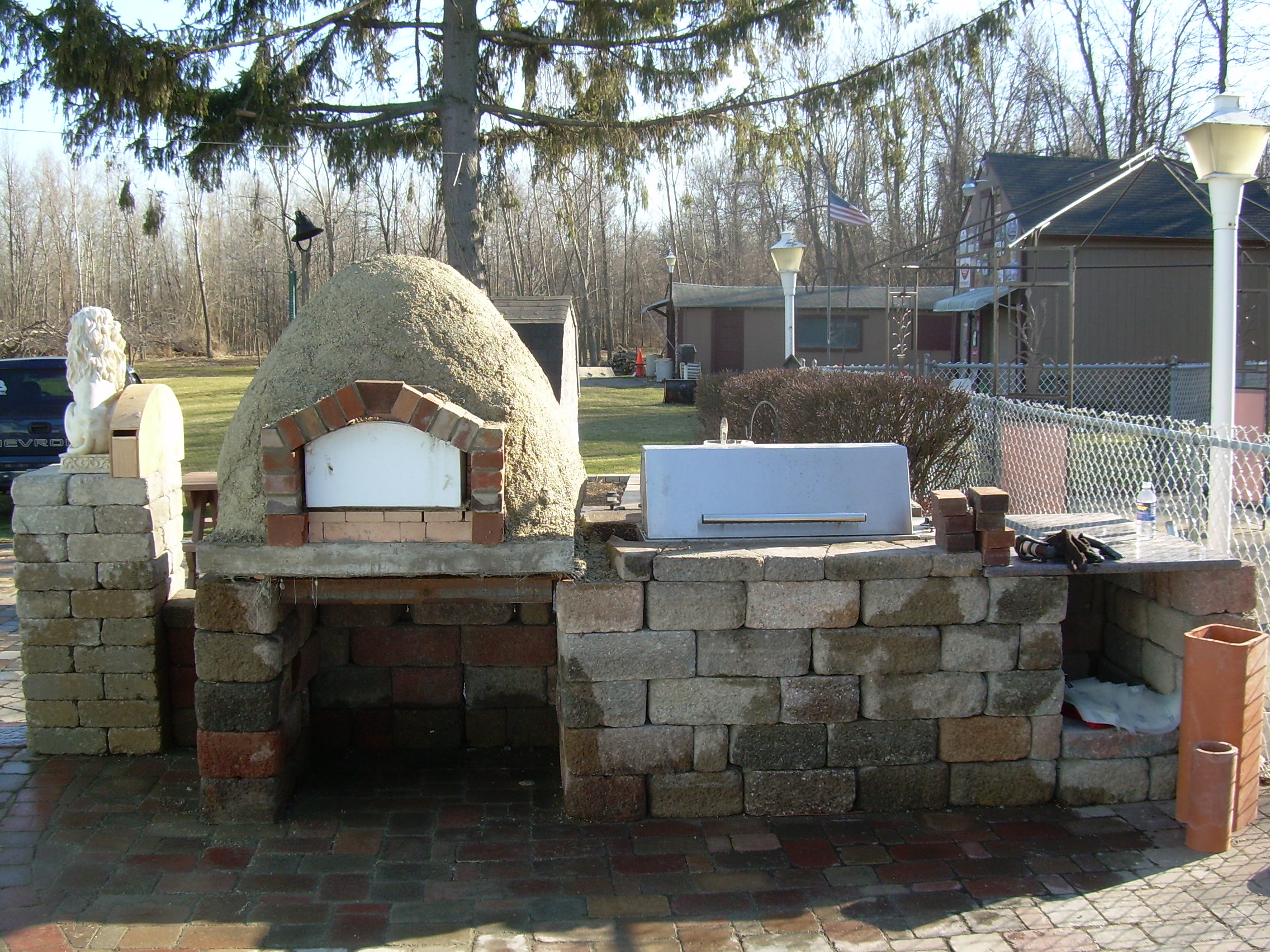

        I put one layer of brick outline and pourd in vermiculite and portland cement,then put fire brick on top. Built arounrd floor.

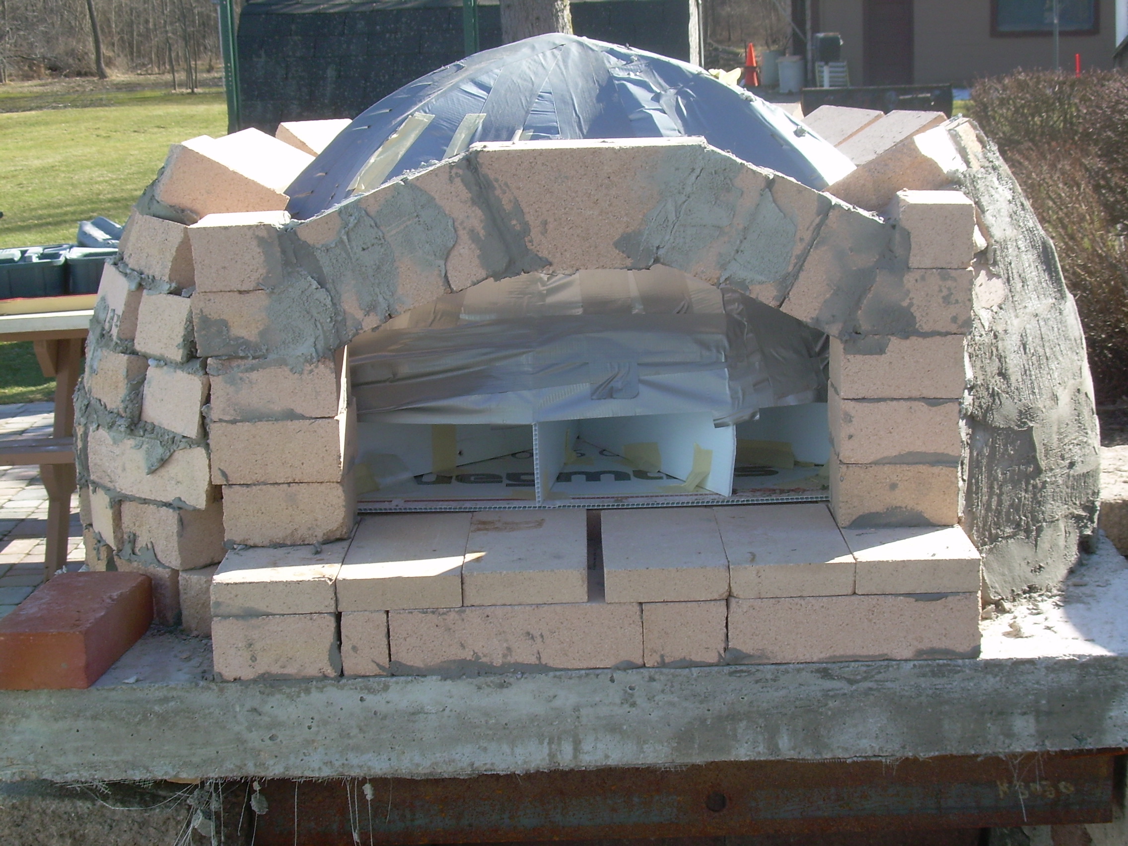

          did the arch @ vent todayClick image for larger version
            Re: starting oven

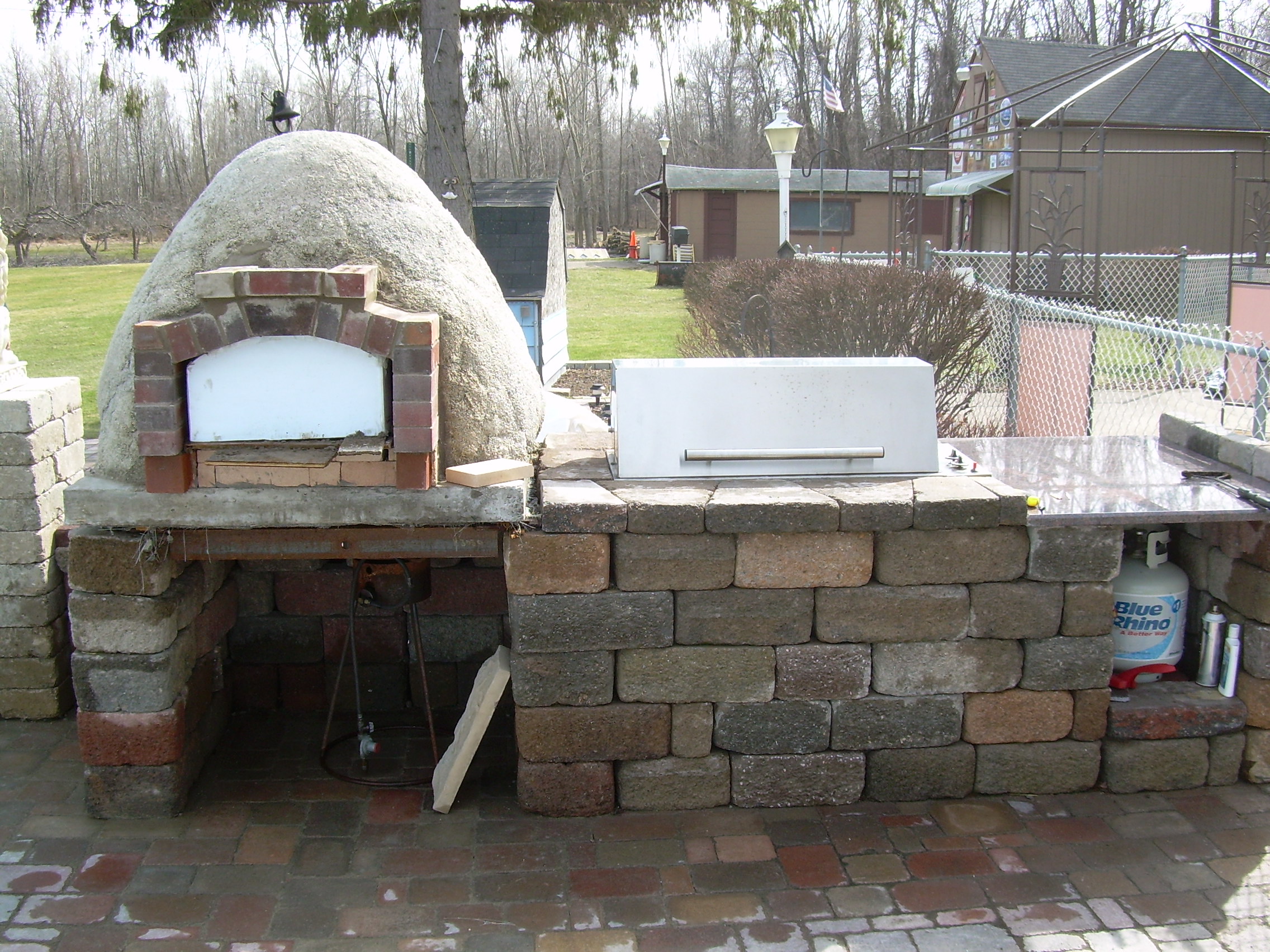

            put the isulation on today but the arch did not hold up i think it was to cold to bond.Click image for larger version

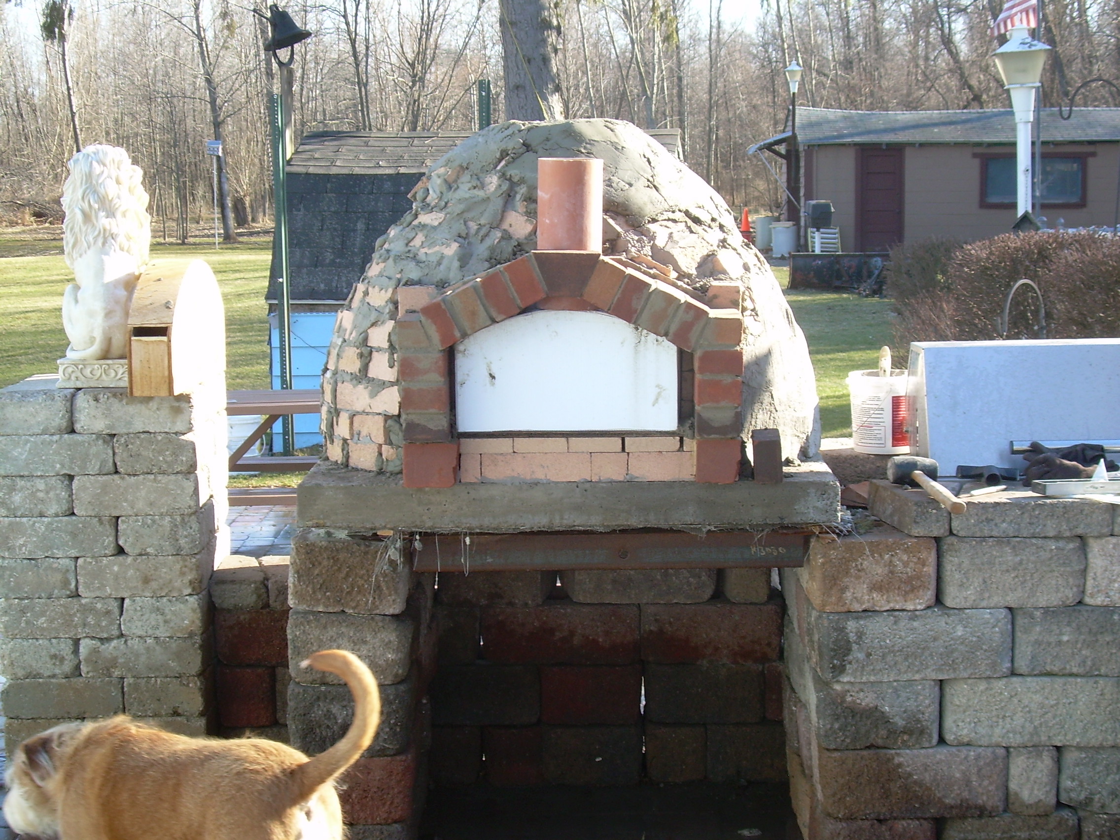

              redid arch Click image for larger version

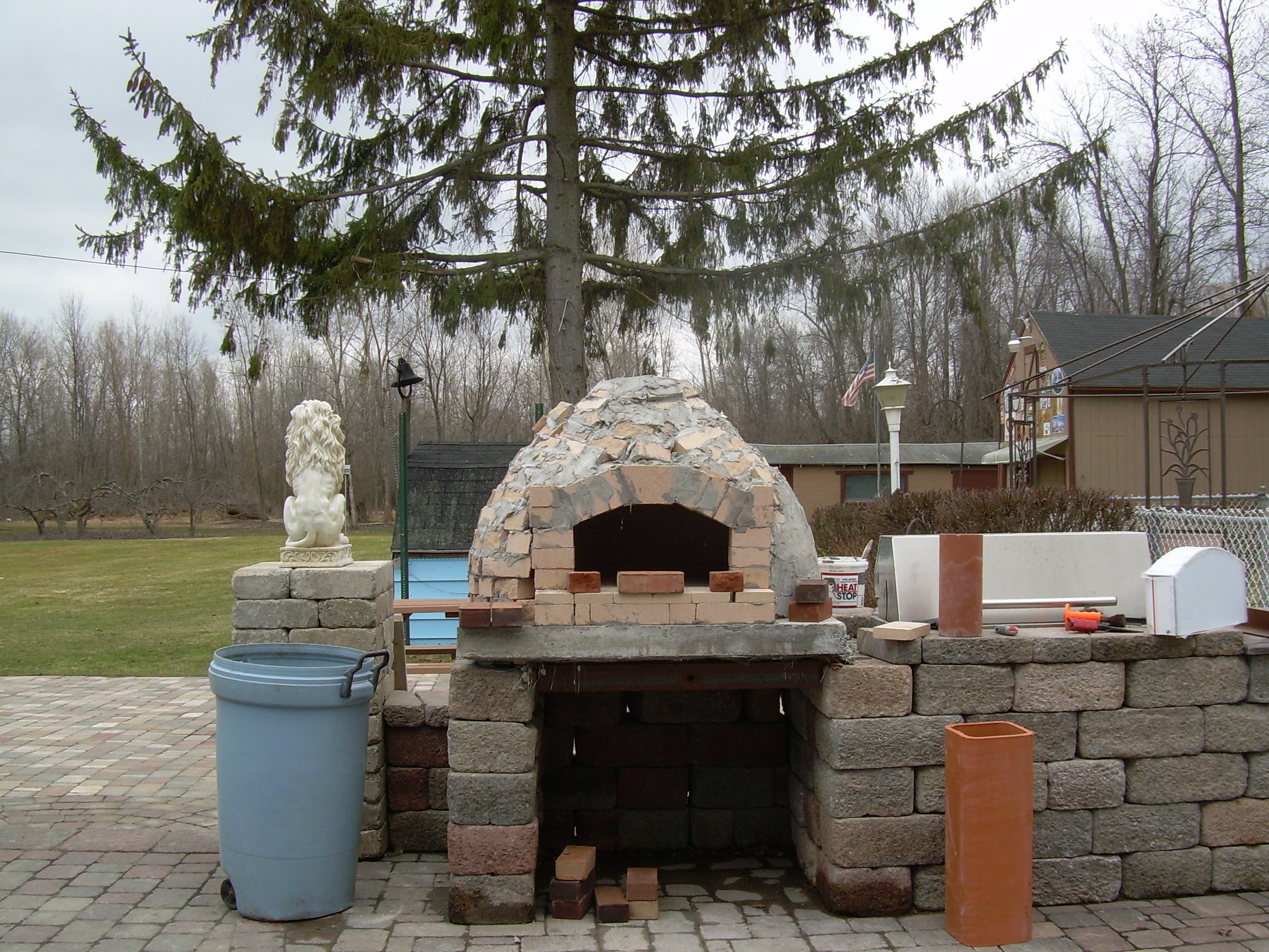

                Re: starting oven
                did some more today cant wait to fire upClick image for larger version

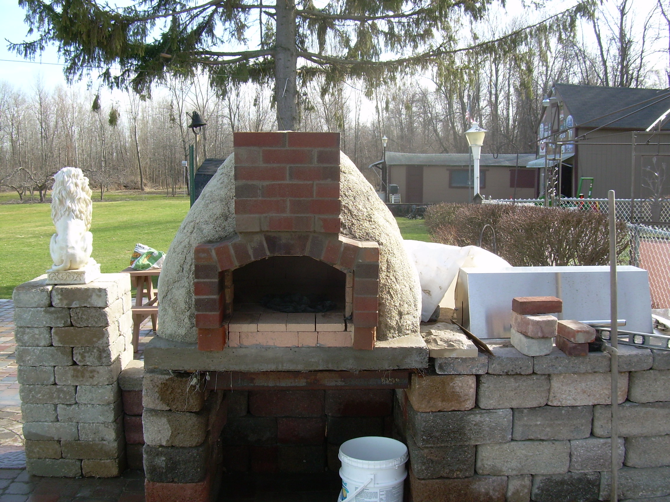

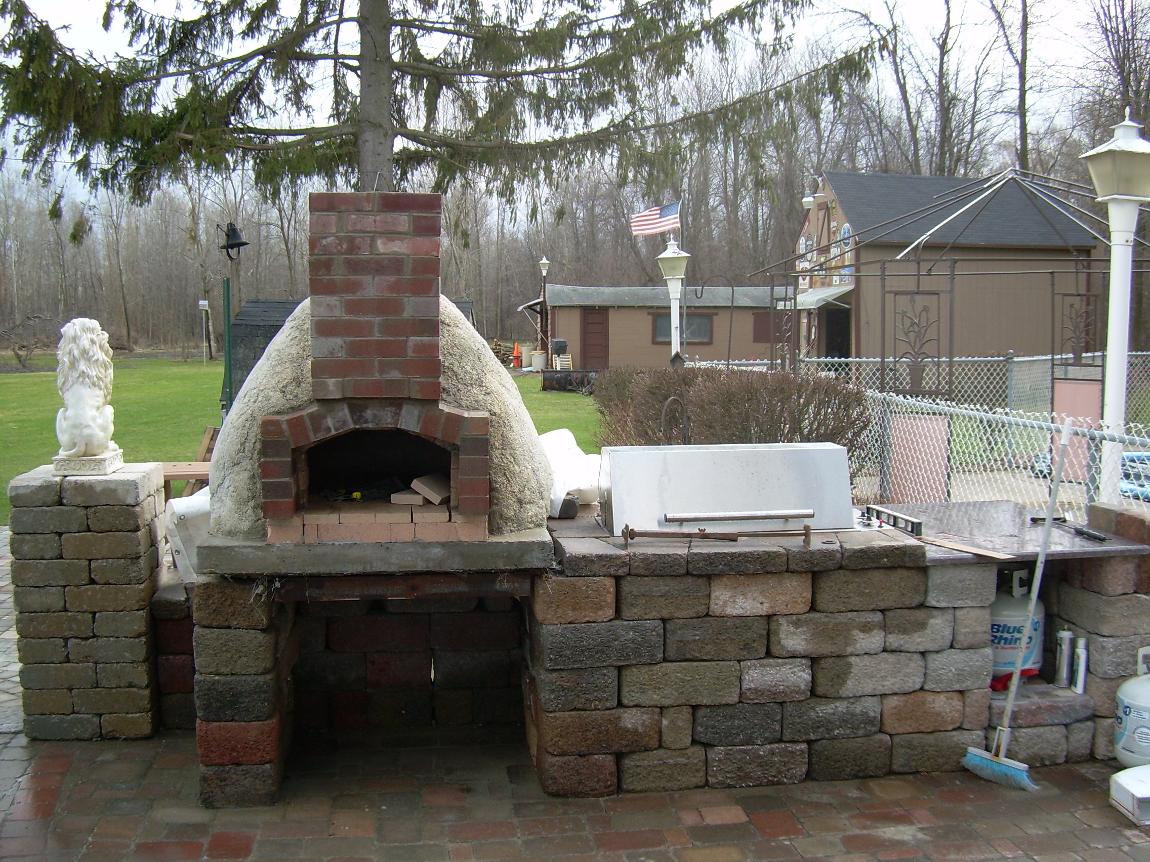

                  i think im done with the chimneyClick image for larger version

                      first fire today added a flue pipe . 5hrs later still felt some warmth in dome[ATTACH]Click image for larger version
                      • #12
                        Re: starting oven
                        Don't fire it up too soon. Keep all the portland cement based concrete parts damp for at least a week. Two weeks would be better. In three weeks it will reach most of its potential strength.
                        • #13
                          Re: starting oven
                          i pourd the 11 bags of concrete in october of 08 sat for winter .

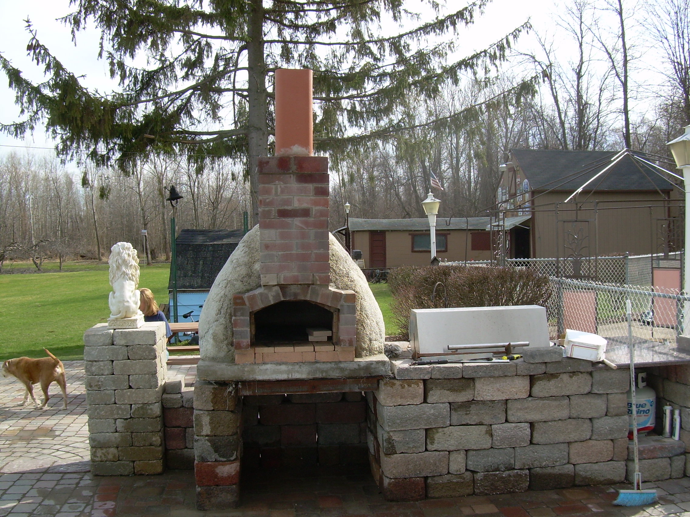

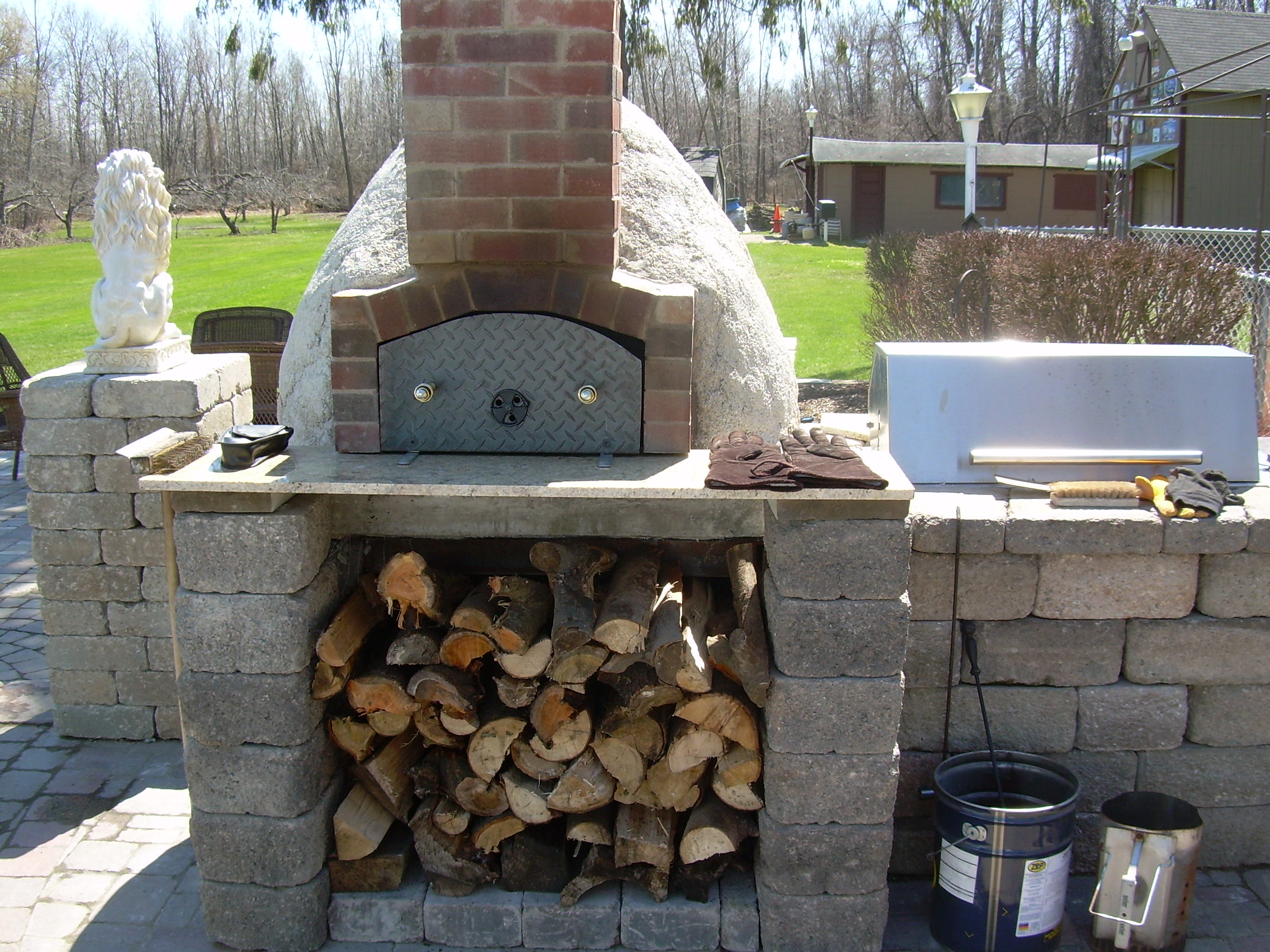

                            redid the piller for the granite top used same stone as the grill suround. [ATTACH][ATTACH]Click image for larger version
