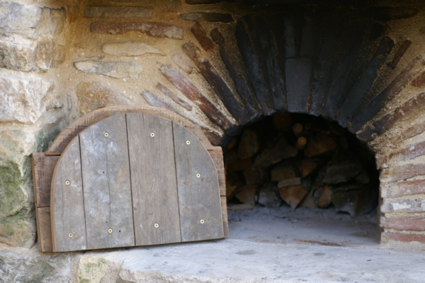

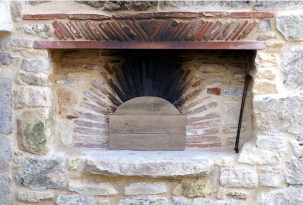

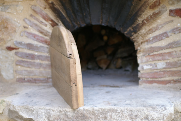

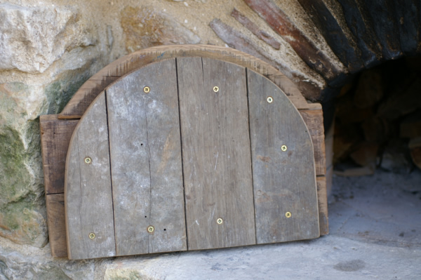

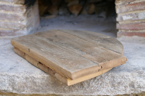

                        Well, I found a lovely old oak floorboard and made a wooden door in the time honored fashion of nailing 2 layers of tongue & groove at 90 degrees to each other (except I used modern screws instead of iron nails) - It's about 2" thick and seems to retain heat very effectively even though there is no insulating sandwich. I'm not sure if I'll add a handle at a later date, we'll see how it goes...

                          Hey Perry,,
                          Love the way the door looks with your oven,, very nice.... Maybe just a bent piece of wrought Iron for a handle,, Do you plan on soaking it before you use it ?
                          Mark
                          • PerryPizza
                            • Sep 2008
                            • 90
                            #14
                            Re: Oven Door Material
                            Thanks Mark,
                            I have a pile of old iron farming tools I'll rummage through to see if anything is suitable, I'm sure something will grab my attention.
                            I read earlier in the post about soaking the door - you learn something new every day! - It is bone dry and rock solid right now, I think it will absorb moisture over the coming months but I might soak it a bit to start it off. I don't know if constantly soaking/ drying timber is a good idea though. I left enough room around the inner arch for expansion due to moisture so hopefully that won't be a problem...
