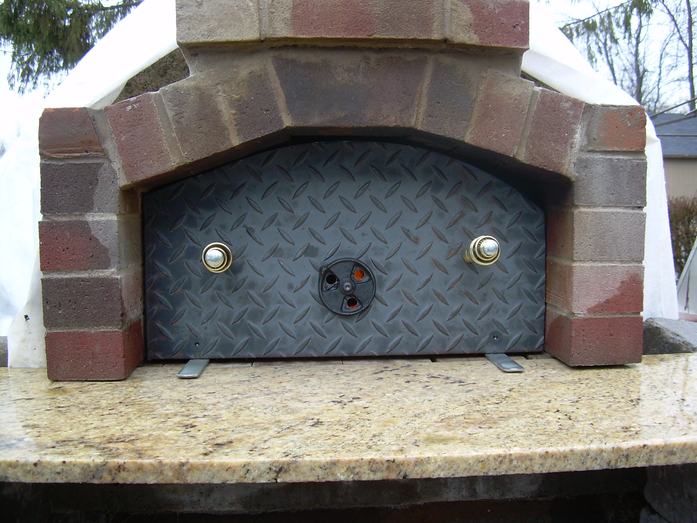

                  Re: Oven Door Material
                  my oven door is cut out of dimondplate steel added 2 spring handles for wood stove and added a damper never hot on the handles. Click image for larger version
