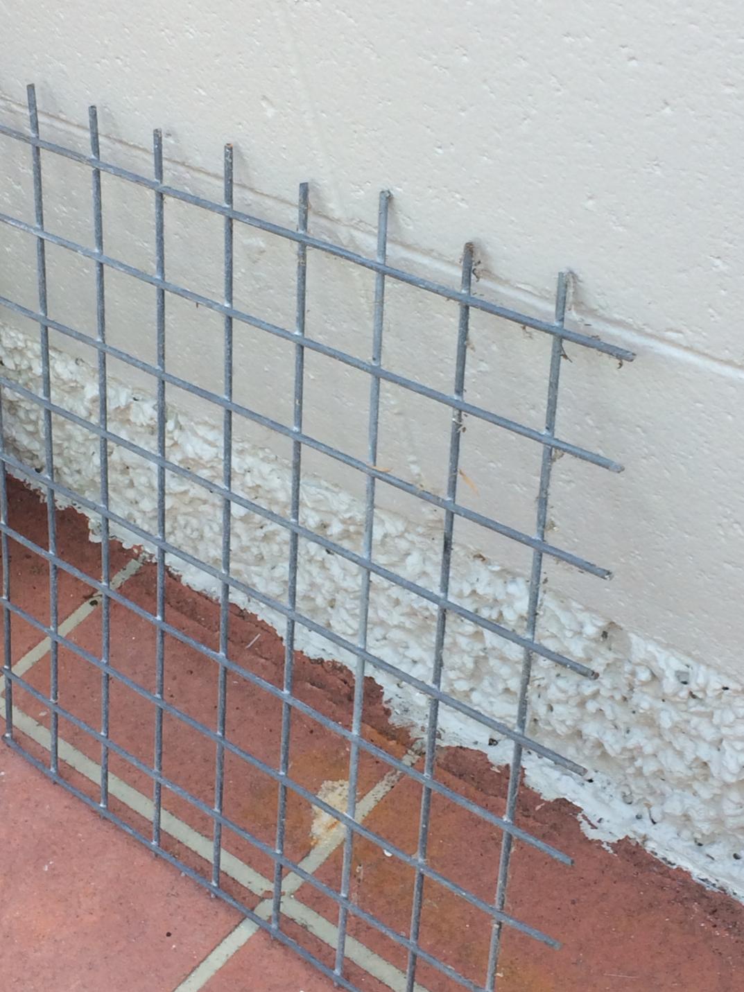

          I’m not convinced that pavers are the ideal material for this application. Because they are quite water absorbent. You could seal them but their interior would still be water absorbent and the sealing would make any moisture that did get in that much harder to eliminate. A material that is not water absorbent but provides space between the supporting slab and the insulation would be a better solution. Foamglass with spaces between pieces of it or some galv steel mesh would achieve this.

              • 9211
              Sorry, no I was thinking of something like 6 mm weld mesh with around 50 mm squares so it would create a 12 mm air space.

                David, I don't know what you mean by galv steel mesh. Can you post a picture or link? Thanks
                i added 3 1/2 poly tubes for weep holes today. Screened the ends and will trim to just below finish tomorrow before I place the slab.
                  • 9211
                  Something like this. It is 3 mm galvanised bar, so is 6 mm thick with 45 mm square spacings. In Australia it is commonly known as weldmesh. My wife grew up in New Guinea in the mid 70’s and it was commonly used as security screening, it was known there as “boy wire”

                          Good idea Mike, tiles would be a better solution as they'll never rust, many also come pre-glued onto a plastic mat with nice even spaces, although the steel mesh is probably cheaper and provides a bigger volume of air space, could be subject to corrosion living in a moist and hot environment.

                              I don't think that would be an issue as long as there is not too much of a gap between the tiles. I would be conserned about the mesh unless it were a very close knit mesh. MichaelPBoisvert was thinking about using tiles for elevating the insulation on his build. That was last month, I haven't seen any recent updates on the build.
