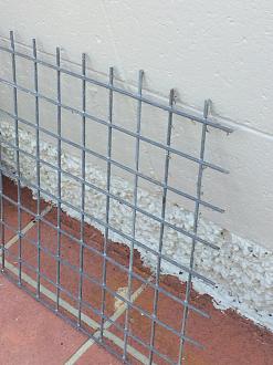

Originally posted by david s View PostSorry, no I was thinking of something like 6 mm weld mesh with around 50 mm squares so it would create a 12 mm air space.

David, I don't know what you mean by galv steel mesh. Can you post a picture or link? Thanks
