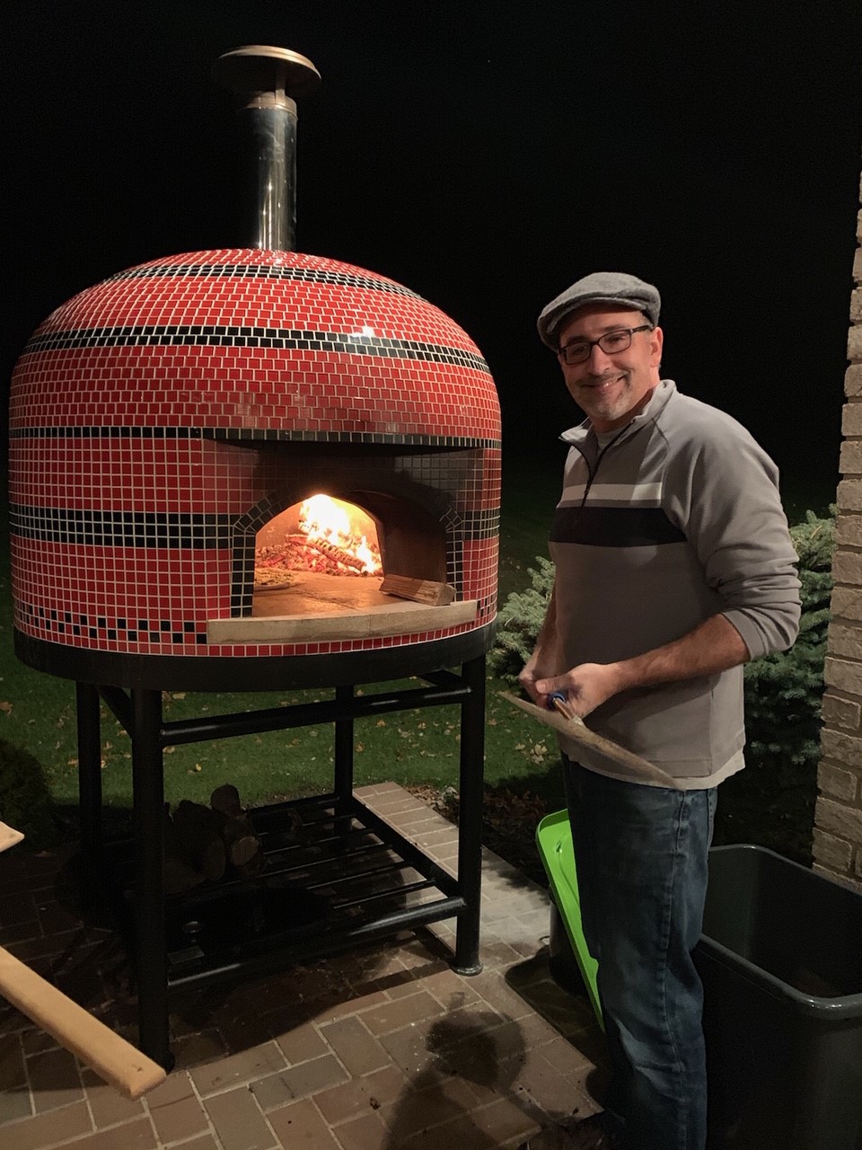

Yes, delivery and placement went very well. We had to rent a Telehandler to place the Vesuvio 80. It's been cured and used twice at this point. I think I have some further curing to go, however ... it's not retaining heat quite like I expected, but believe it will improve with each firing.Comment
Pizzas look fantastic and I really do love the look of that oven. I will be interested in how much it will improve (heat retention) as you continue to use it. How long does it take to bring it up to pizza cooking temps? Are you planning on baking with residual heat...i.e. bread, roasts, turkey...
, etc.? I'm assuming there is an insulated door or is it just a "sheet metal" door that came with the oven?
Blog: http://thetravelingloafer.blogspot.com/Comment
Thanks Mike. I take VPN very seriously. Currently it's taking 2.5 or 3 hours to get up to temp (800 floor, 950 dome), but falling somewhat below rather quickly. The pizzas in the picture were made with something around 750 floor, 850 dome temps, I'd estimate. Acceptable, but not ideal. I definitely cook other things in the oven, particularly bread ... have done a bit of bread already (the next day) and it turned out very well. After having been up to temp late into the evening, I'm seeing morning temps in the 300 to 350 range, based on the door thermometer. The door included with the Vesuvio is not insulated, rather just a sheet metal door. Anyway ... any thoughts or guidance appreciated.Comment
